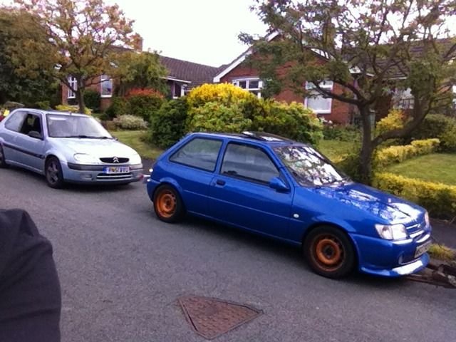

We picked the car up 4/08 and have already completed a lot of the work. Main thing is to sort welding and engine swap so we can put a 12 Month ticket on it, then I'll be using it and slowly adding the other bits. The coilovers are wound to around 50mm I believe, but we need these locking nuts off to change the wheels (god knows how)
Here's some pics of the build so far, not bad for mostly evening work.
When we collected it
Progress
New engine and engine removal
That's all for now. More pics to follow when new engine has arrived and ready to go in. Really looking forward to getting it on the road.

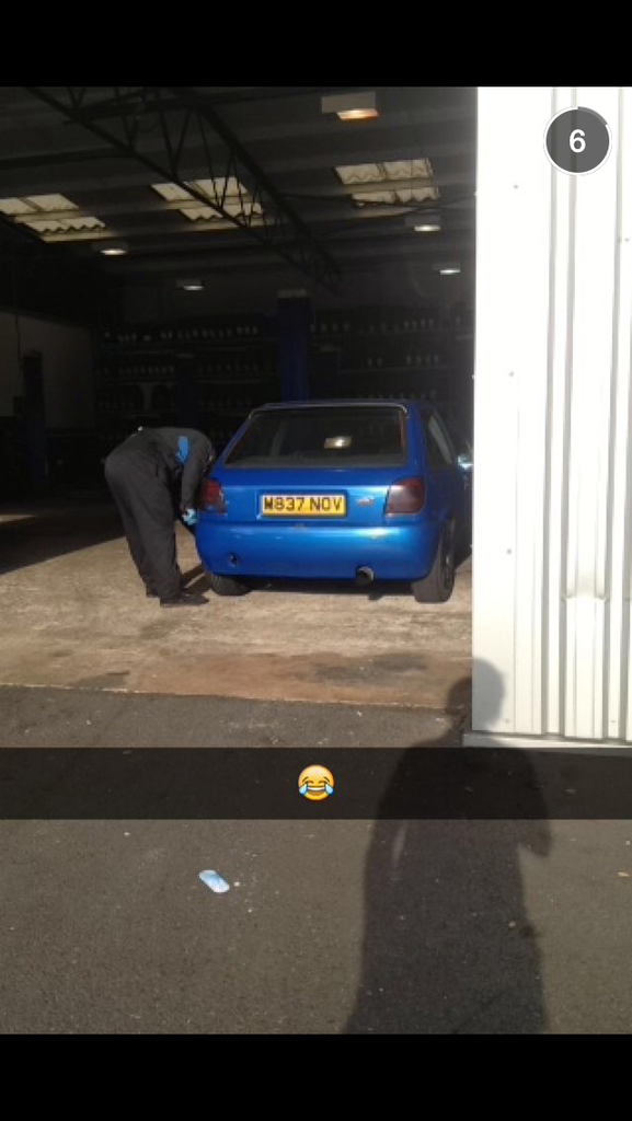

Right, so I'm in two minds about selling the car but anyway here's a big update of stuff done since I last was on here.
Shortly after the last post, I went down to Santa pod to give the car it's first good run for Fordfest. Had a really good time down there, saw loads of smart motors.
And then had a small issue with a tire de laminating on the way back....
