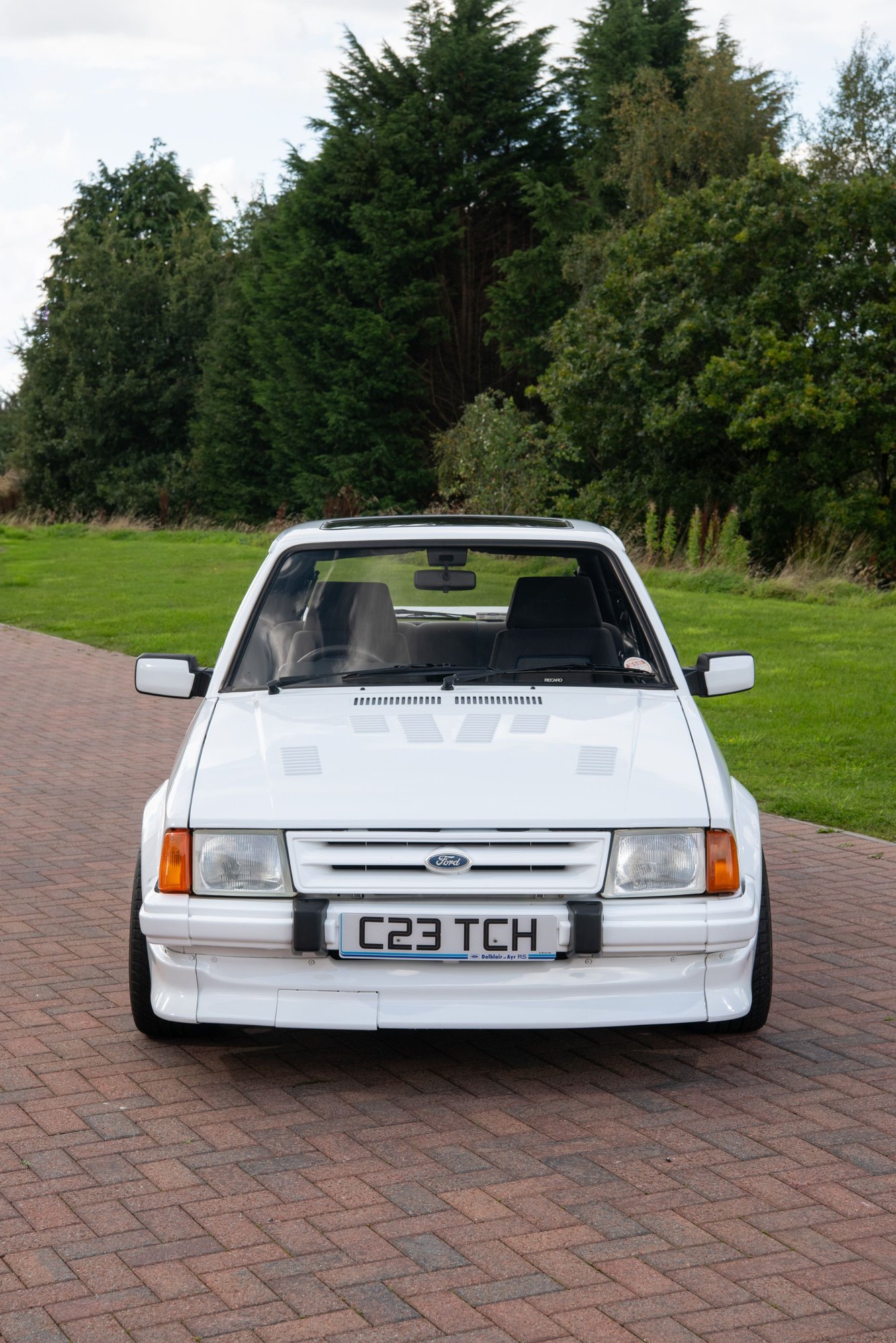

Out and nearly ready yesterday for its first show in a long time!
Made quite an impression on the public. There was usually a good few people round it all day.
I had fitted an engine bay sticker kit to give it more of a std look
Cracking day.
A great day at the show / fayre, took the car back to my mates for dinner. Been a long time coming but enjoying the car again finally.

Its been a while!
Had the bonnet done by Cool Louvres. Instantly made a difference! Gibby painted it for me after the work.
I had the tank made by Pro Alloy to get rid of the old home made thing. Proper lift pump etc in this.
Done a couple of shows....
Ford Fair on Fast Ford magazine stand
Ford Fest on Fast Ford magazine stand
A few local shows.
Even made the last copy of Fast Ford Magazine
Its had some pics done again for another magazine
Adam Smith has been up to do a video on it a couple of weeks ago and theres another YouTuber coming to do a video in a couple of weeks!
Managed to get all the niggles sorted out, STB AUTOMOTIVE gave it a full nut and bolt check as well. Been enjoying it.... just about to go over 59k miles.... feels weird putting miles on it.... 😂
