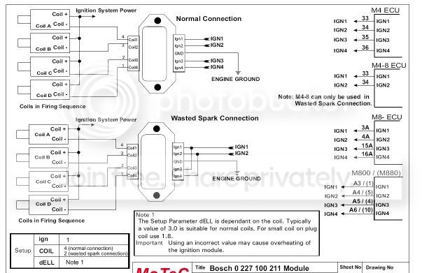

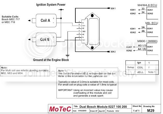

So Ł200 gets me a module which i solder into ECU connector, and this will enable me to run a coil on each cylinder, and has a proper RPM trigger for my tacho?
Would i be able to run 2 of these dual ignition amps to run the coils instead of having to use 4 std cossie ign modules? :
Or even one of these Bosh Quad ign modules? :

you don't need 2 dual ones, or 4 single ones. you can use just 2 drivers and use the wasted spark principle.
Old Sep 29, 2004 | 03:41 PM
As long as the golden rule is followed...
1 coil, 1 driver irrespective of how many plugs that coil drives.
Follow this and all will be ok.

So if i wanted to run a wasted spark setup with one coil per cylinder i would use your module (2 driver version), one dual ign module and have trigger A going into coils 1 + 4 and trigger B going into coils 2 + 3 ?

wes,
No this breaks my golden rule 1 coil 1 driver (amplifier).
For 1 seperate coil per cylinder, you will need 4 seperate ignition amplifier drivers.
Then you either use ....
1) Normal/standard unit (2 outputs each driving 2 amplifiers inputs)
2) 4 output version unit each driving a seperate amplifier input
Hope this makes sense.

I think i get it yes, so i'd need the normal 2 driver module, a quad bosch ign module, and wire it up as per the diagram for a wasted spark system?
