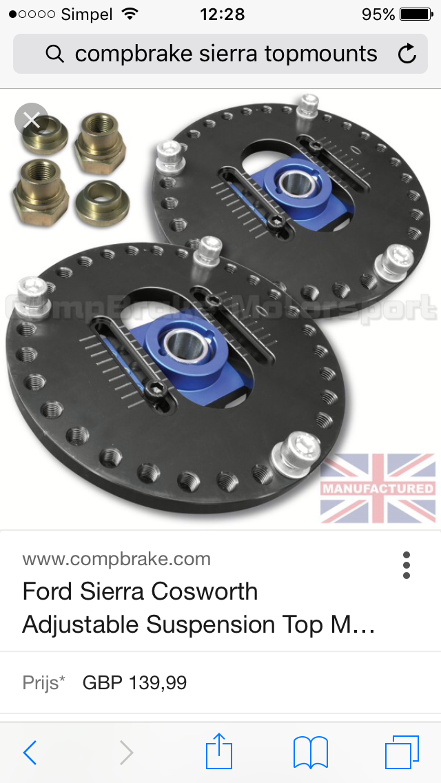

I could give them a try there not that expensive. Would these from compbrake be Any good? Cant find alot of info about these. Only that it isnt a great company. Got adjustable tca's from compbrake which are decent.

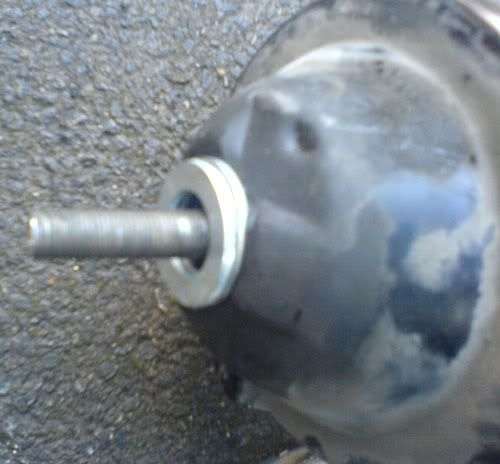

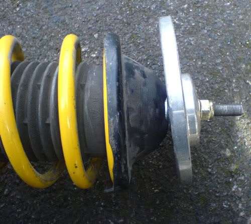

fitted the top mounts to mine before changing to coilovers.
The top spring cap needs to be spaced out a little from the top mount to allow ti to move. i used flat washers that were welded together, but a spacer would be a better idea.
these ones looks fine for track use.
but i wouldn't ride 'em too fast on shitty roads...
that 2 bolts connection looks pretty weak for it.
i'm not talking by direct experience though...
but that's why i purchased a couple of eccentric ones, maybe i'm putting 'em on in a week or two.
(so again, robrs2, many thanks for the useful tip!)
it's told they lift up the front end by a inch or so... i'll tell you when i do it.
They usually come with 4 bolts (I know as I have some for my car sitting on the shelf), bit daft how they took the picture with only 2 on though.
