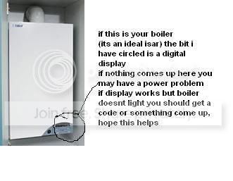

se mk3 cabbie's Avatar
se mk3 cabbie
Posts: 1,206
From: middlesex
Old Nov 17, 2006 | 10:18 PM
RSKim's Avatar
RSKim
Posts: 17,303
From: ......
thast it exactly, but even when it wouldnt power up there was no code
Old Nov 17, 2006 | 10:20 PM
se mk3 cabbie
Posts: 1,206
From: middlesex
strange
