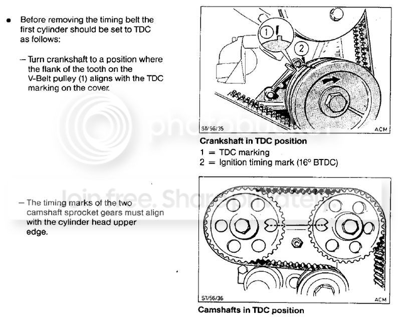

sounds like you have everything set right -
AFAIK the valves should never touch unless the belt is at least a whole tooth out... and that would be very obvious when you line all the marks up..
apologies if the pic is a bit big, but left to keep clarity

TAKE No1 SPARK PLUG OUT GET IT TO TDC 1 AND 4 GET A DIAL GAUGE IN AND CHECK IT WITH YOUR FRONT PULLEY TIMING MARKS

they do tap if the timing is out by one tooth, but you should be able to see it.
