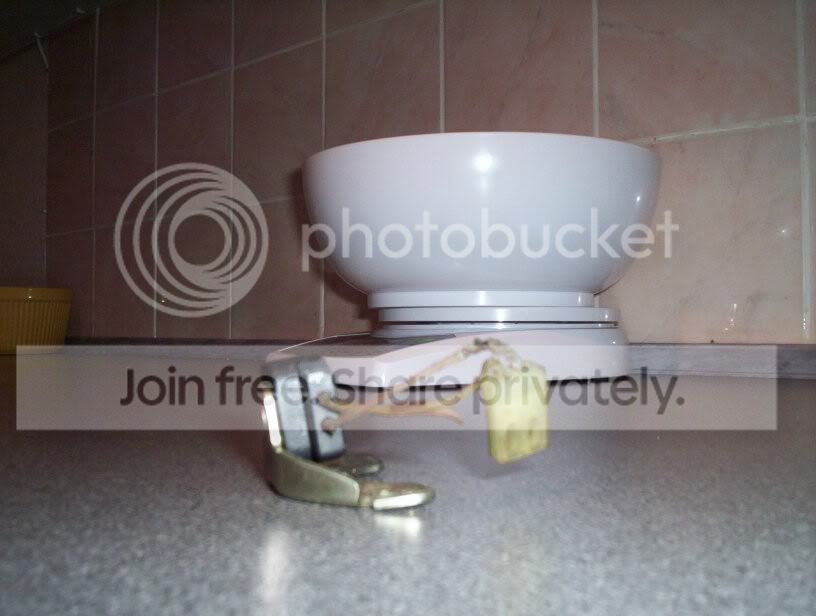

hi guys just decided to check my phase sensor gap do we rekon this is the problecket.com/albums/y9/bigwhitesaff/000_0810.jpg[/IMG]m?

That phase sensor isnt much cop but blue smoke is oil burning mate, so id be looking at the turbo if the smoke is the only symptom.

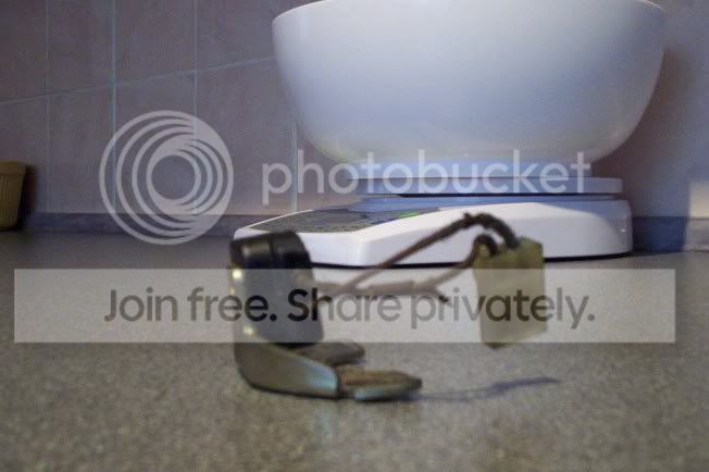

the smoke its throwin out stinks off juice tho, it hardly uses oil and i had the turbo re conned about 2 months ago, the only other thing is i took the plugs out earlier to check the gap and they are black with soot these are only a week old and the car has not moved its just been started every day, i initially thought it was oil so i had the valves guides and seals done as well as the turbo also had all the compressions checked which are fine, could it be an ignition timing fault ie not burning the fuel at the right time,pics are not very good but the plug on the phase sensor is greenand mouldy also all the insulation had gone off the wires and they were touching the side of the dizzy?

put a ful bailey kit on it about three weeks ago, gonna try a new phase sensor which i ordered yesterday if that doesnt sort it think its gonna be a trip to motorsport deveopments see what they say. ive taken it to a tuning place near me before called RE performance centre but to be honest if it aint got a subaru badge on the bonnet they dont want to no

phase sensor wont stop what your describing I dont think

been doing it for about the last 3 months, it hasnt got any worse or any better. with the insulation missing off both wires of the phase sensor and them both touching the inside of the dizzy was thinking maybe its not getting a signal from the phase sensor and relying on the crank sensor only for a signal, it could be injecting fuel a couple of milliseconds the wrong side of the spark causing it not to burn correctly leaving me with unburnt fuel (especially if my crank sensor is not gapped correctly or full of cack). or it could jus be me clutching at straws delaying the inevitable. what do u think dude - did that make sense?

ps if the phase sensor in that condition it does NEED changing n e ways.

just tried my yellows with my fooked phase sensor insulating the wires its miles better but not perfect hopefully with the new phase sensor it will sort it. cheers mate. will update when i have fitted the new phase sensor if ive not burnt it lol
