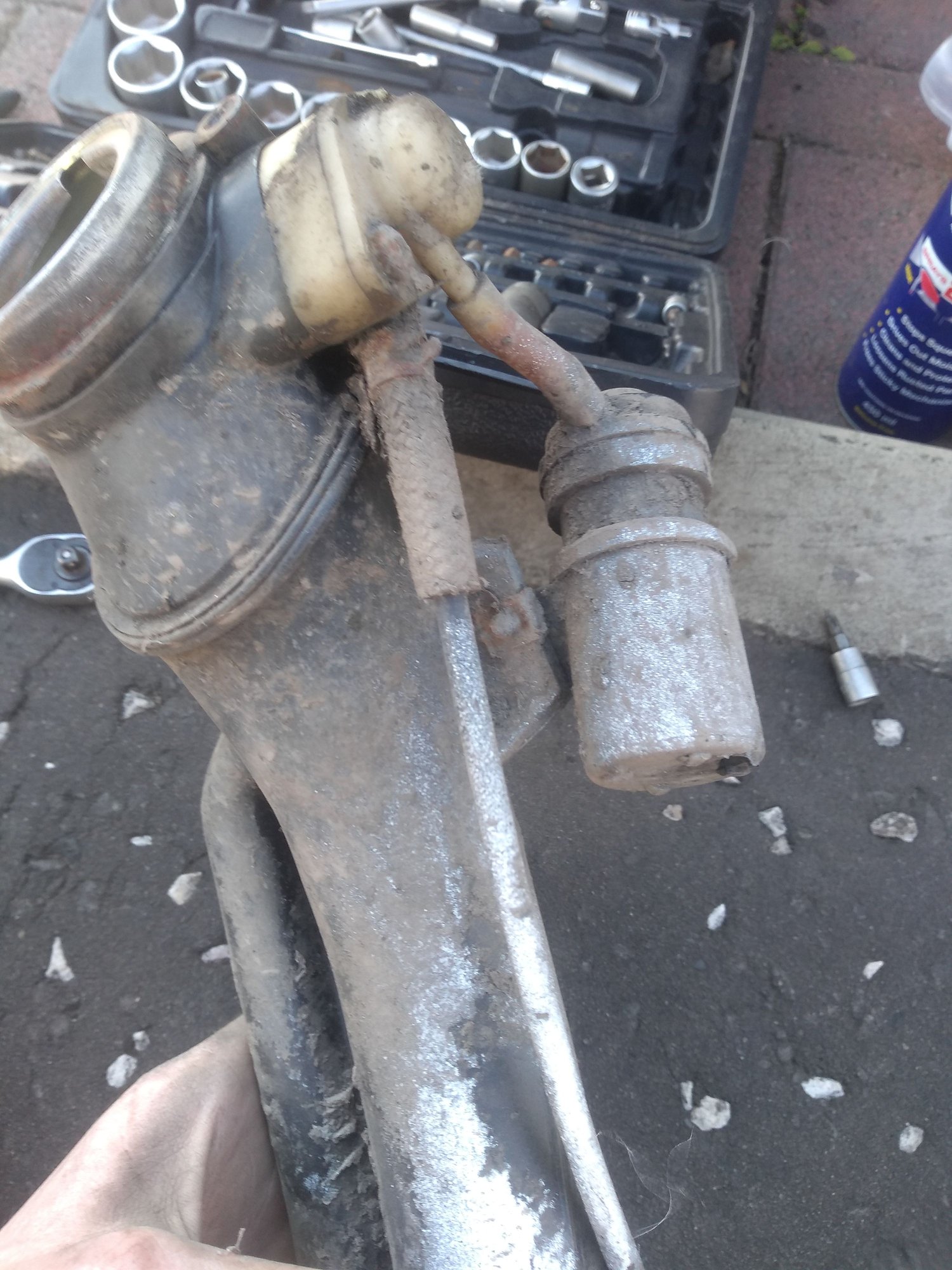

Also been removing fuel tank , keep getting air locks and my senders away so thought id bash on with it , how do i get this braided hose off my fuel tank? worried pliers might break it but is it just a wiggle it eventually out?
And this R2D2 looking device thats the fuel tank vapour valve? , i pressume its not meant to rattle about like mines? sounds like something bigs stuck inside.
braided fuel line

Yer may as well put the injectors back in. Get some new o-rings/sleeves if yours look tired before you do tho.
Brained line will wriggle off.
No idea on the rattle,been far too long since ive had one off
