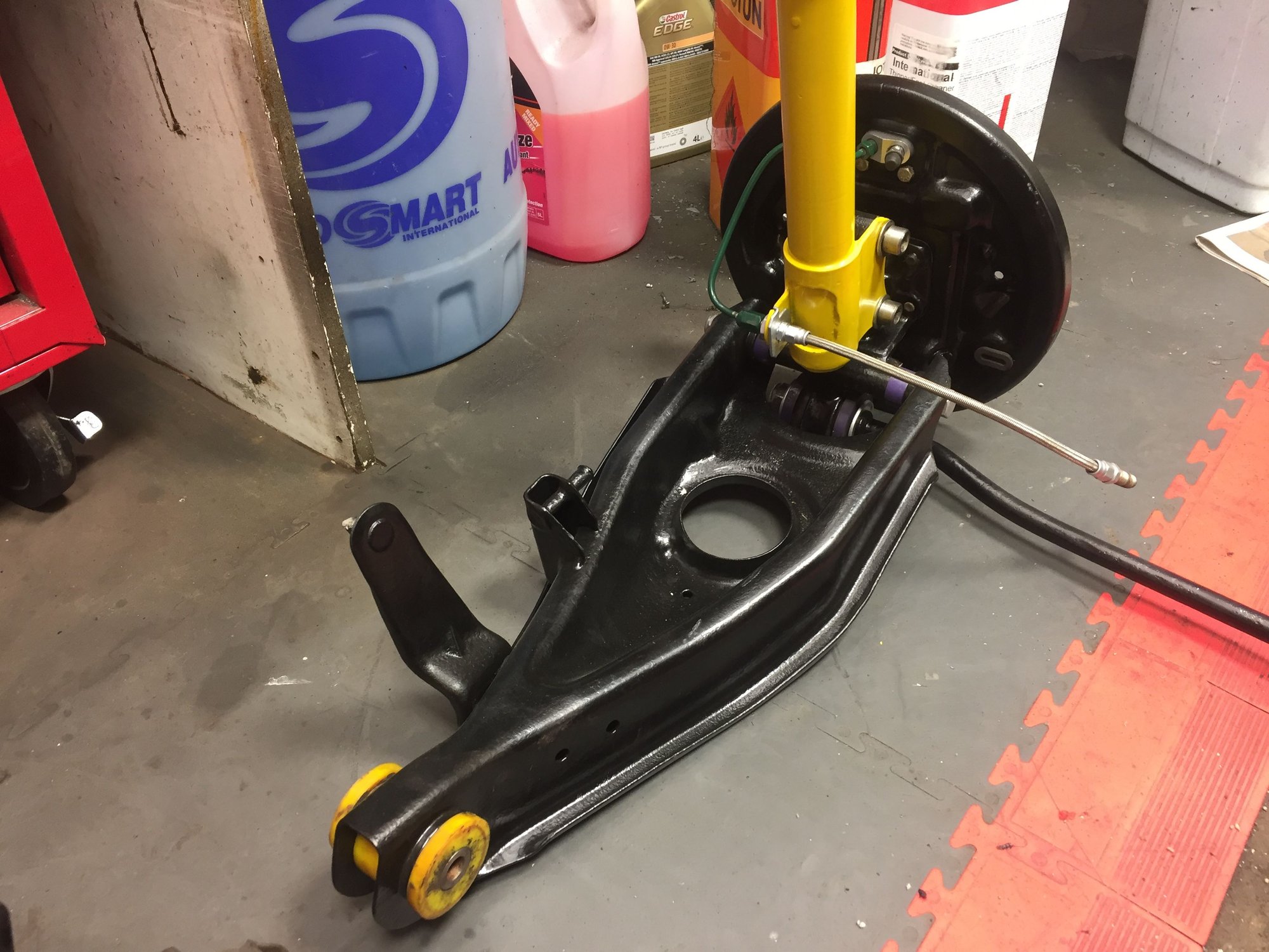

I’ve been busy doing a little refresh to my rear suspension parts it’s 19 years since I last done it and the brushed on smoothrite was badly chipped. Still not going to the expenses of power coating as it will never be a concourse car and if it’s too good I’ll not want to use it. I have gathered some more tools since I last done this to enable me to do a better job
so hopefully I will last another 19+ years.

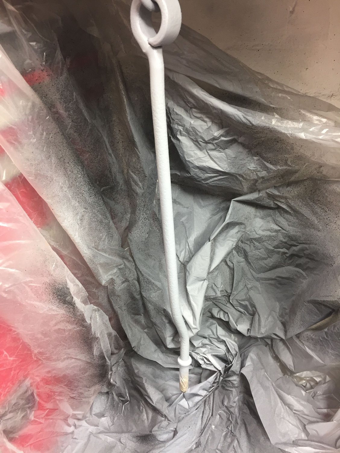

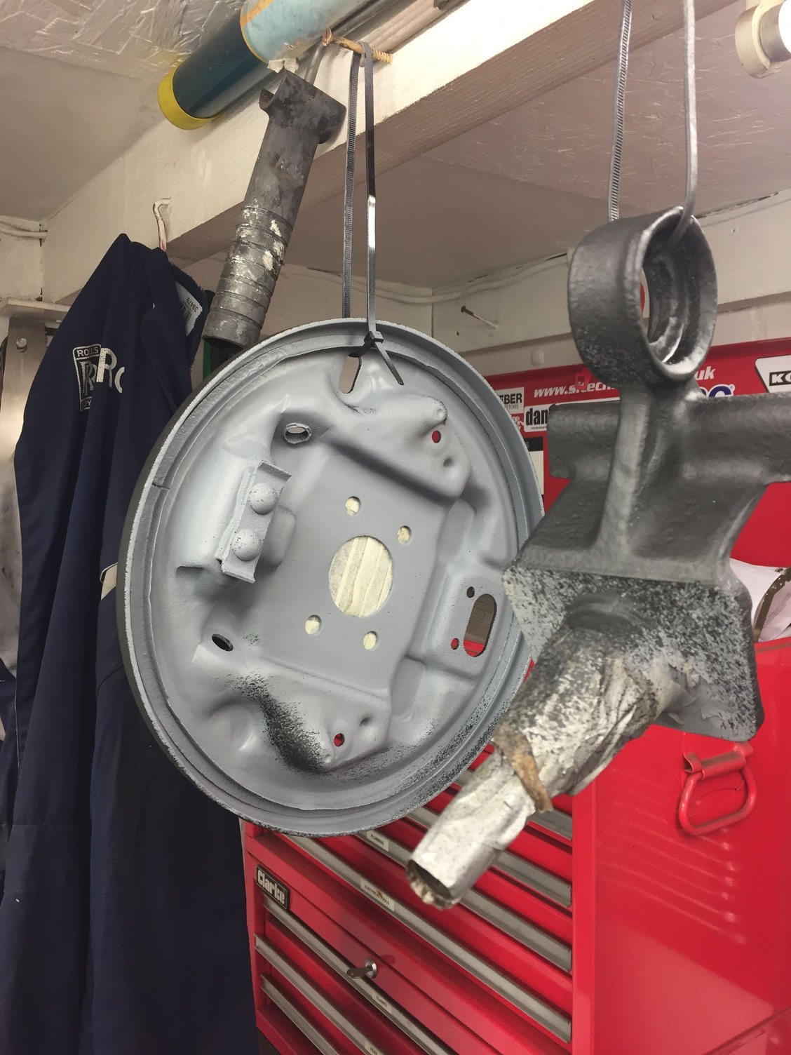

They are not finished in the picture but my process is
Back to bare metal with a wire brush on my die grinder.
Etch primer.
Stone chip (the finish in the picture)
satin black
Its keeping me away from the Ł300 drink hamper I won at my local

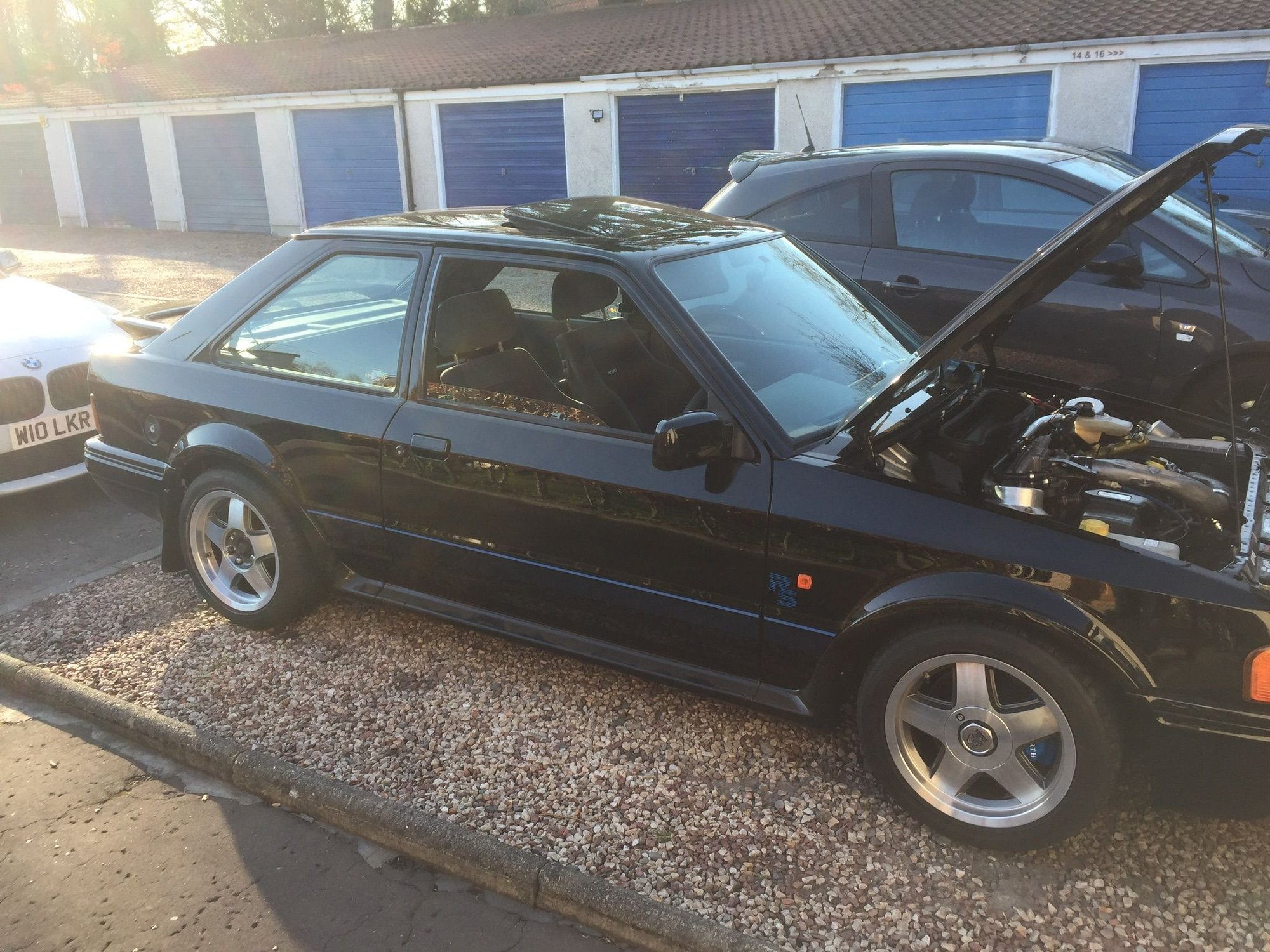

Good day today. Down off the axle stands, started and a run up the road. Brakes need another bleed then ��

lovely ..really like those Retro wheels.

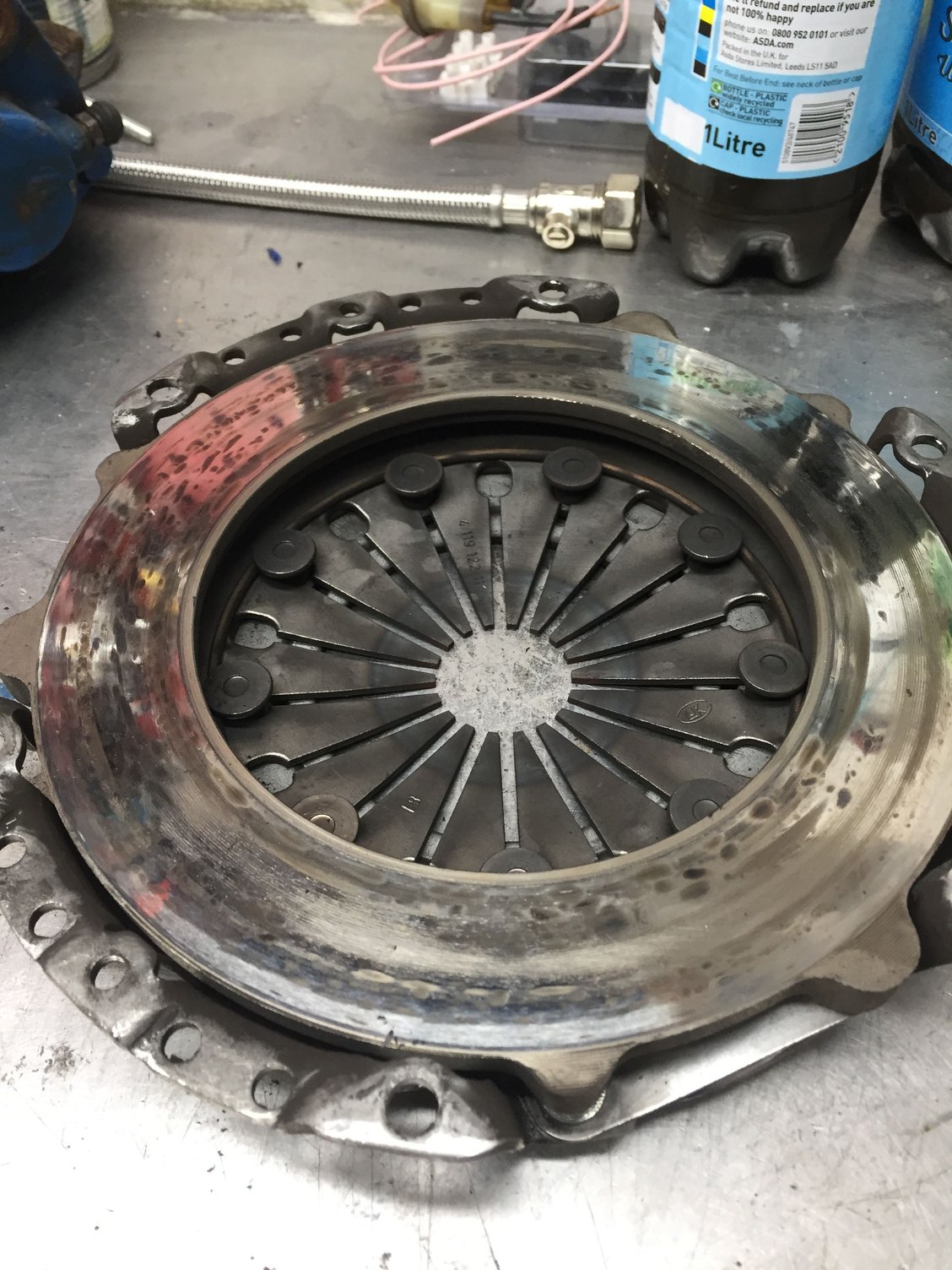

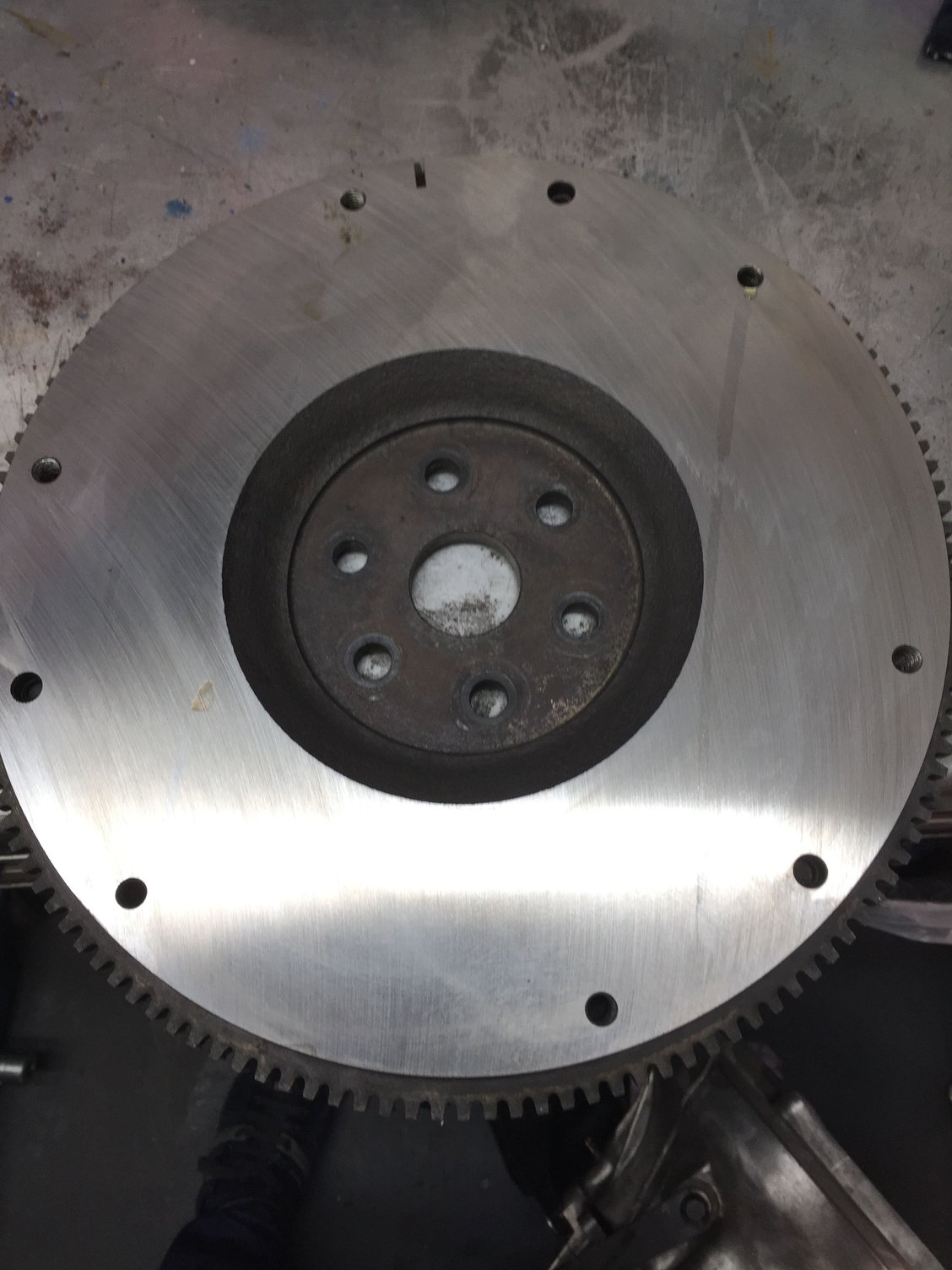

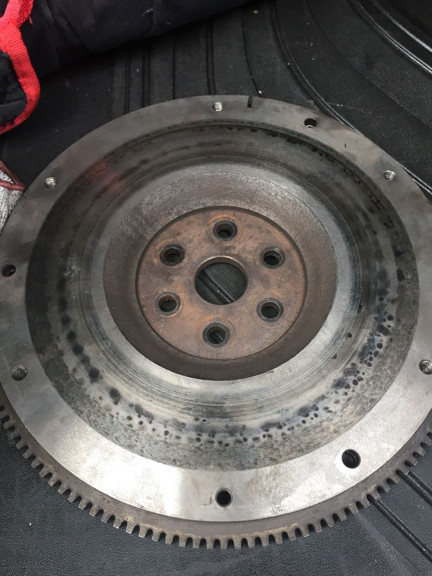

I normally start my winter jobs in the holidays after Christmas then ignore them for a few months and rush to get them finished but making progress now.
Gearbox out using a borrowed lift. No grunting required.
Don’t know why it was slipping!!
New mounts
Cover as bad as the flywheel
Reground and ready to go
New clutch
Just needs fitted.

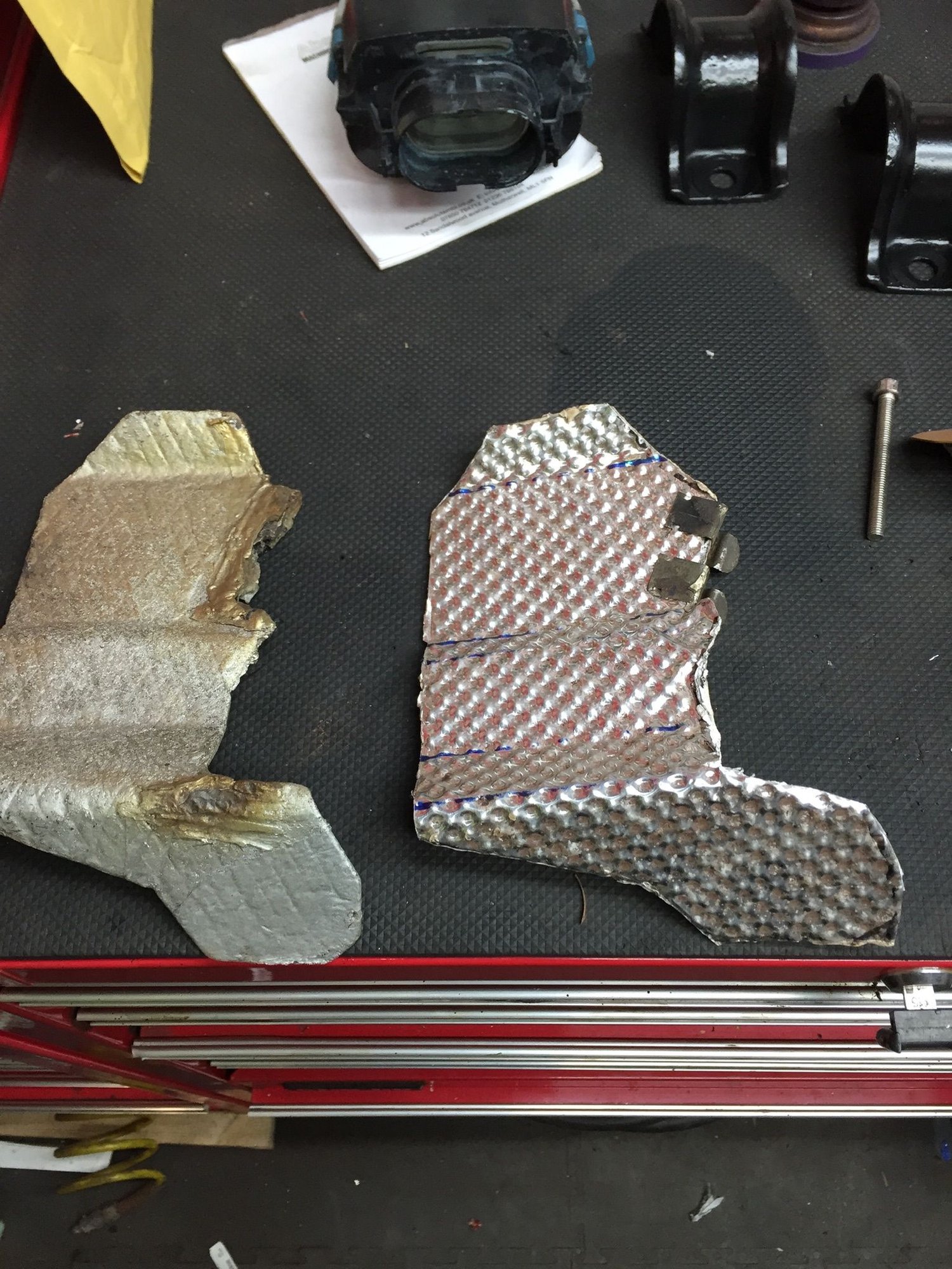

New track rods and ends fitted. With Ford parts NLA I done some research and TRW seemed to be the best but there rod ends were unavailable. When I removed the original gaiters they were branded TRW.
I replacement heat shield to replace my damaged original.

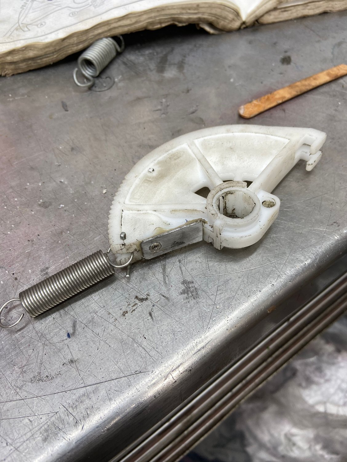

And somethings unexpected. My clutch wouldn’t release. So the well proven Escort 5/6 pedal and quadrant
The part before it’s modified
I added a metal piece as I thought the adjuster acting on the plastic was a poor solution. In fact for something that AP promoted I think it’s not great but it does work..... for now
I also added this spring but don’t think it does anything.
And new short plate.

After seeing how the MK5 pedal conversion works I now understand the logic in the metal quadrant but I think if/when the plastic one fails I would maybe do the same as my son done on his Fiesta.
He drilled a hole through the pedal and quadrant and fixed them with a bolt then installed a Cortina cable with the manual self adjusted at the gear box end.

Went to start it yesterday and nothing. Investigation today and the 28 year old Vecta Managusta immobiliser has failed. It cost me Ł650 and was the only one approved by insurance companies and I was unable to get insurance unless the car had it.
Need to do some research with what to replace it with.
