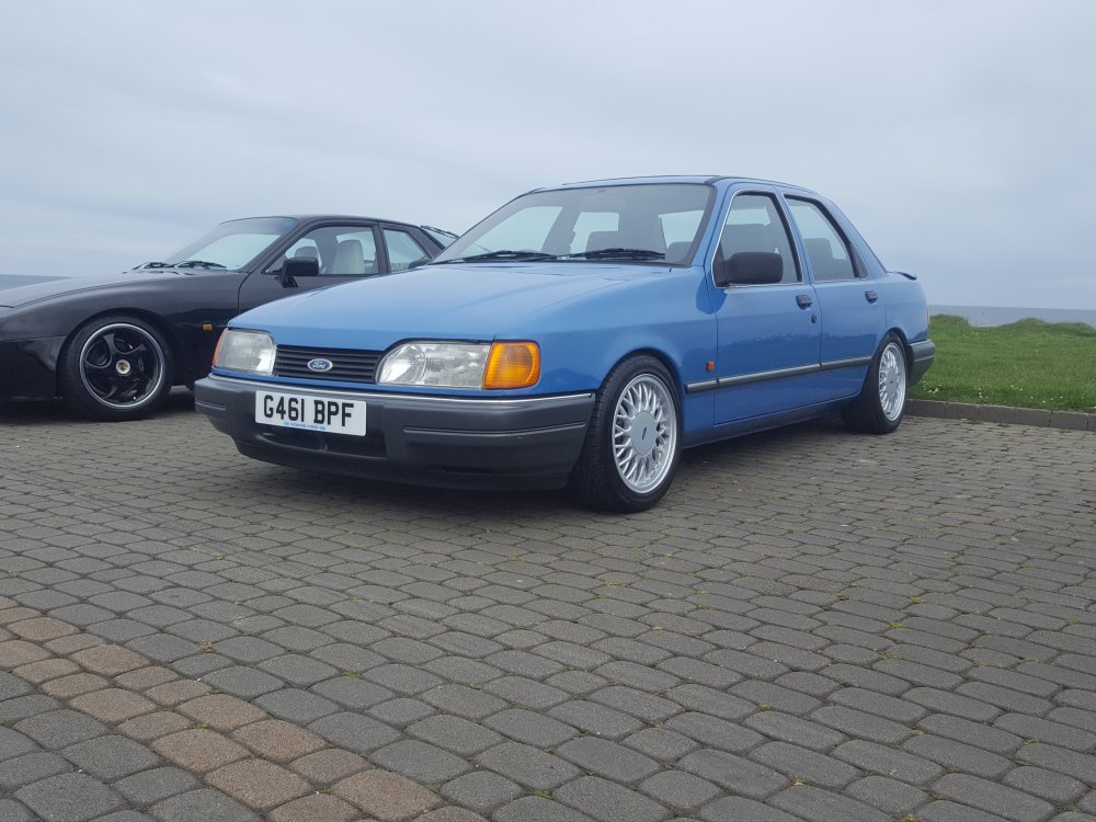

Hi all
Ive been on here 10 years as a creep but some of the gorgeous build threads has given me the drive to finish this lady off.

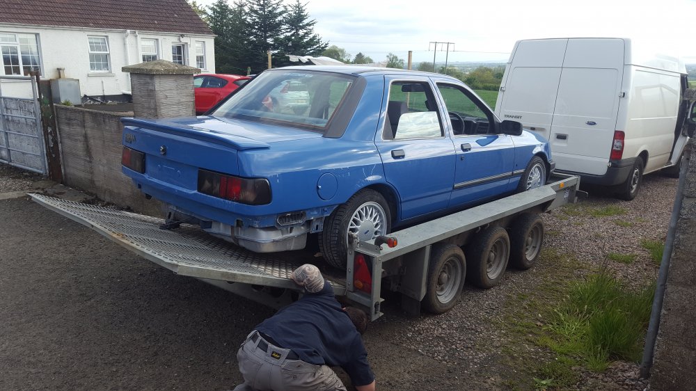

Thought id share my Sierra bought from a forum member as an unfinished project. I'l let the pics do the talking. Since Photobucket has kicked the bucket you will have to excuse me for the thumbnails.

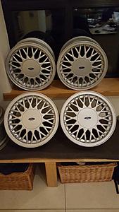

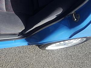

So as you can see I sourced a set of sharktooths, had them refurbished but I couldn't find centre caps so had to make do with Ghia 4x4.. Also sourced a new back bumper & sent the car for paint in its original colour, Maritime blue. But yes it wouldn't fit onto the plant trailer.
Mint Rainbow Recaro was sourced at a price I couldn't refuse but it just didn't suit the car. It did for theme time.
So now the car is painted it still had no clutch or exhaust, or power steering. What I forgot to mention is that I had to finish off the wiring by sourcing a BOA loom on eBay.de as I could not find one for love nor money.

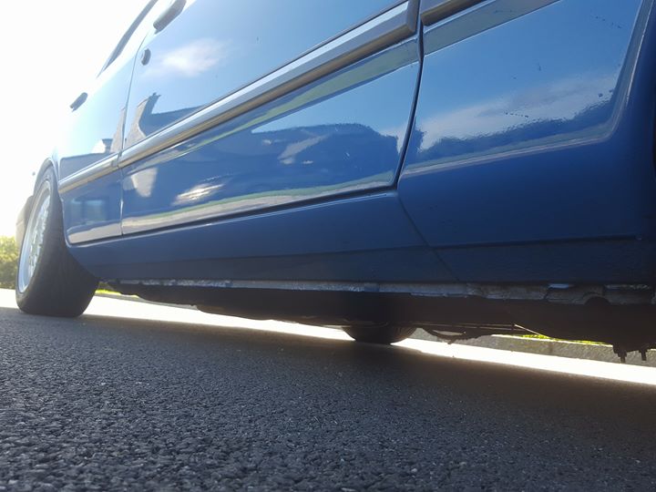

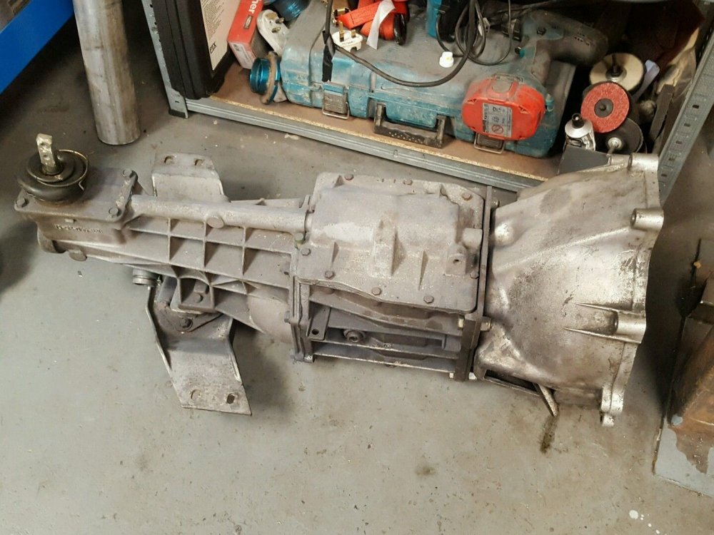

Hydraulic clutch finally got the thing selecting gears to find syncho aint great in 4th.
2WD Magnex exhaust adapted to V6 downpipes.
Underside sealed
Braided brake lines all round
Found 2WD cossie brakes so had them refurbished & fitted

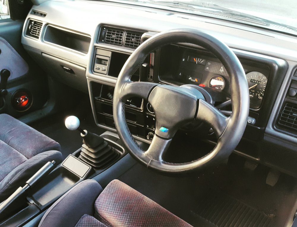

Ford Puma gear knob has same gear pattern & thread as the T5 Borg Warner box so polished one up. Now I feel like Steve McQueen through the streets of San Fran.
An Azure spoiler was fitted, keeps the car sleek.
Amber rear lenses were sourced, keeps it period.
3 out of the 6 door mouldings were replaced, all new bumper trim too.

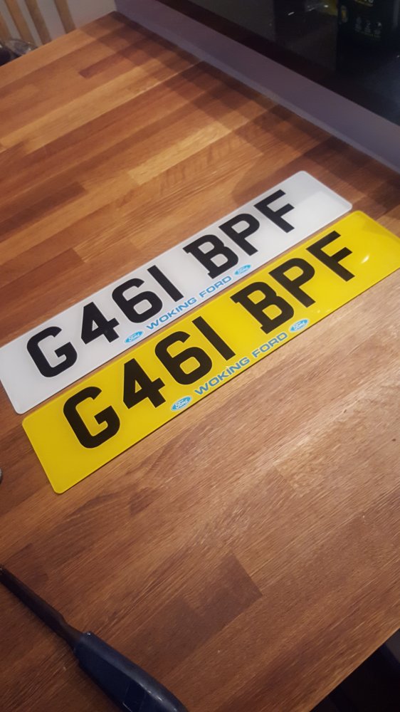

Woking Ford dealer plates made up by I fear the dealership does not exist anymore, shame.
Passion Ford'rs, I'm sorry for the brief bullet point description but this car has caused me some serious heart ache & id rather not go into it lol.

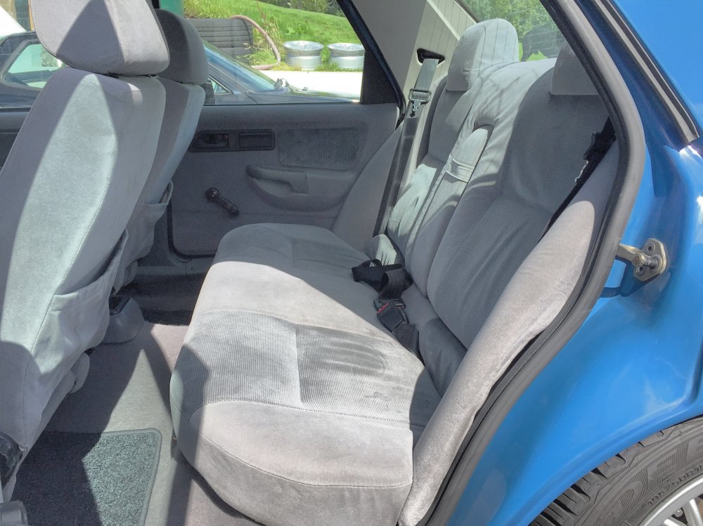

So now the car is 90% there its been fully polybushed, AVO coilovers, adjustable TCA's.

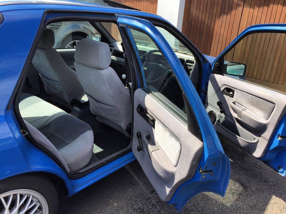

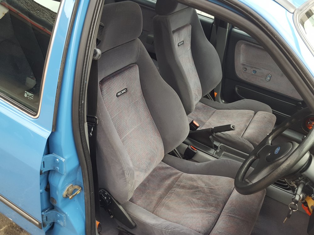

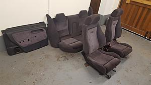

One thing that got me was that it needed light grey cloth to go with the Maritime blue. A friend offered me £200 for my Rainbow plus his mint light grey cloth, result.
Attached Thumbnails 1988 Ford Sierra Sapphire 2.9 V6 24v BOA Cosworth-19983557_10156500370862501_6503261540182990518_o.jpg   1988 Ford Sierra Sapphire 2.9 V6 24v BOA Cosworth-20157231_10156500371167501_3946564968292044682_o.jpg   1988 Ford Sierra Sapphire 2.9 V6 24v BOA Cosworth-20157173_10156500371817501_2103561226895392794_o.jpg   1988 Ford Sierra Sapphire 2.9 V6 24v BOA Cosworth-20140148_10156500371572501_9173067507302814761_n.jpg   1988 Ford Sierra Sapphire 2.9 V6 24v BOA Cosworth-20157646_10156500372602501_3039855434734036291_o.jpg

And now for a review of the full spec:
Mechanicals

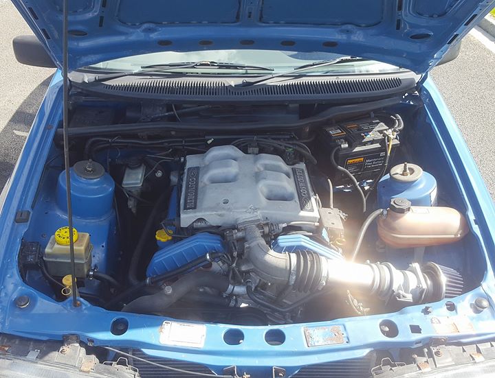

2.9 V6 24v BOA Cosworth engine
Engine rebuilt with new chain guides, tensioners, polished & ported head work, all gaskets replaced
T5 Borg Warner 2WD Cosworth gear box with Burton Power bell housing & adapter plate to suit Cologne block
New injection fuel tank, lines & pump
Radiator fans wired to discretely placed switch under dash
Hydraulic clutch
2WD Cosworth prop shaft
2WD Cosworth polybushed rear axle, LSD, shafts etc
Refurbished 2WD Cosworth 4 pot brakes all round
Braided brake lines
Avo coilovers
Adjustable track control arms

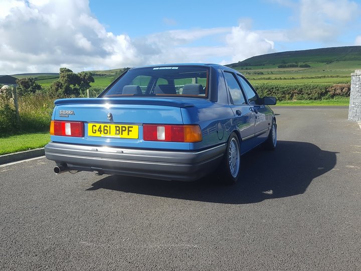

Brand new 2WD Cosworth Magnex exhaust, with downpipes to suit V6
Converted to power steering using refurbished 2WD Cossie rack
Body
Low mileage HPI clear 47k car (Originally supplied by Woking Ford)
Resprayed in original maritime blue in April ‘16
Woking Ford registation plates
Underside protected with wax oil
New rear bumper
3 door mouldings replaced with brand new Ford items
Original amber rear light clusters
Registation plates made up with original dealer logo
Sierra Sapphire Cosworth 4x4 ‘Sharktooth’ alloy wheels recently refurbished with good tyres
25mm hub centric wheel spacers on rear, 15mm front
Azura boot spoiler
Interior
Light Grey Recaro cloth interior in immaculate condition

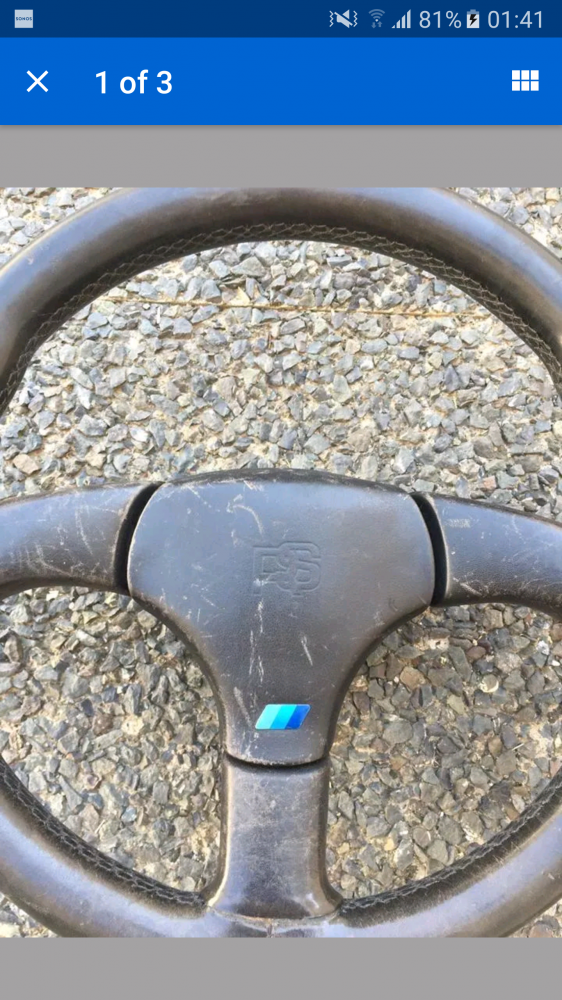

Rare RS Accessories steering wheel
Aftermarket V6 Rev counter fitted in instrument cluster within keeping of period dials
Polished Ford Puma gear knob
Thanks for reading
