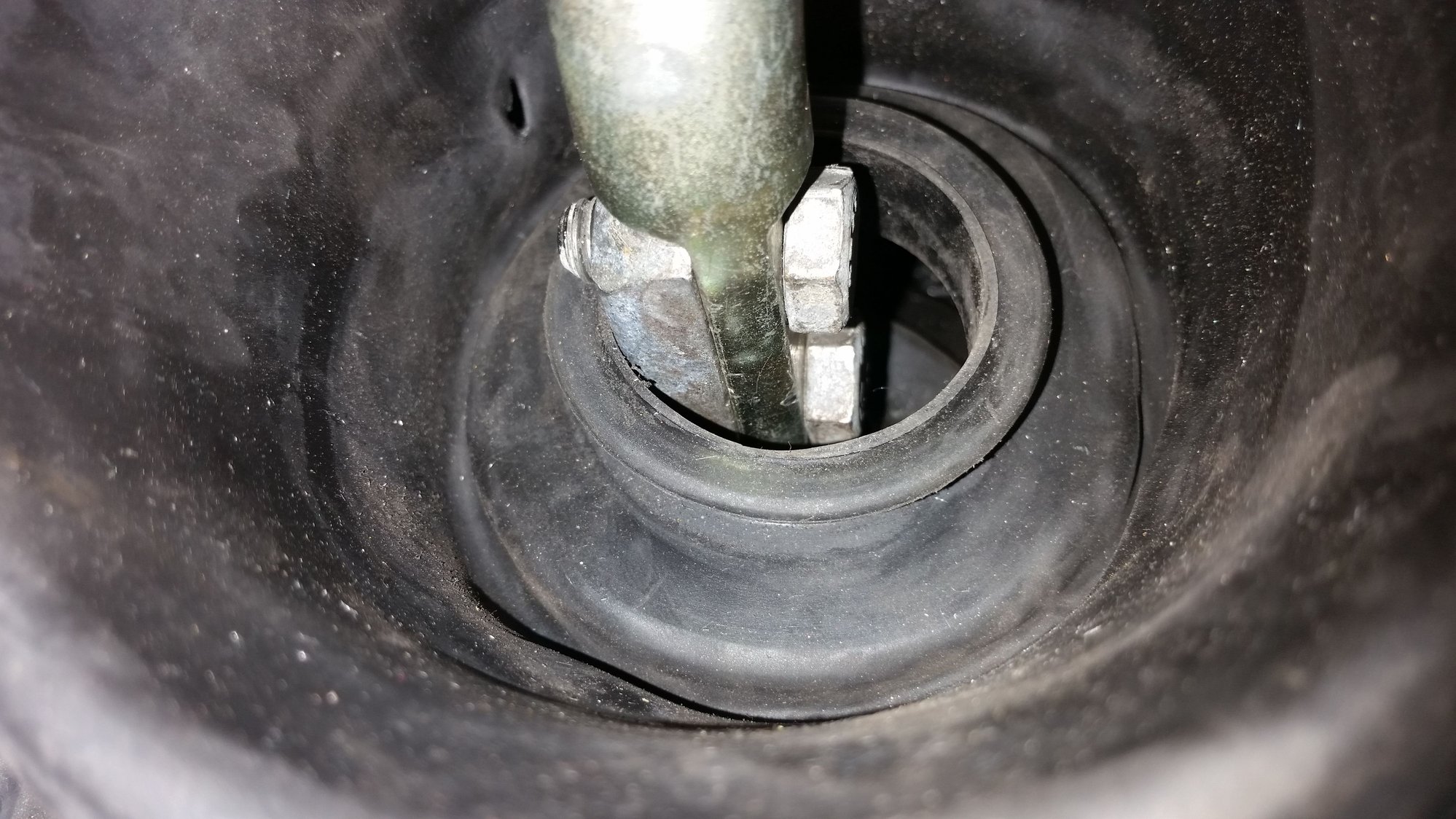

I'd already had a measure up with the gearboxes side by side, and had decided that the shifter was going to be in something like the right place, so went about getting it bolted up to the engine, all went fairly smoothly aside from the top two bellhousing bolts being a complete twat to get to under the tunnel.
Turns out that it's a great fit, kinda wish I'd taken this route in the first place, instead of messing around with adapter plates etc. The shifter is dead centre, so will just need a little straight lever making for it, but I'll leave this as a last job once I've levelled up the engine and box.
Thats about where it all stands now, I've been playing around with both propshafts, and it looks like the rx8 one will work if I have the splined end from the old Ford shaft fitted, and a small spacer made up to go between the diff and the back end of the prop.

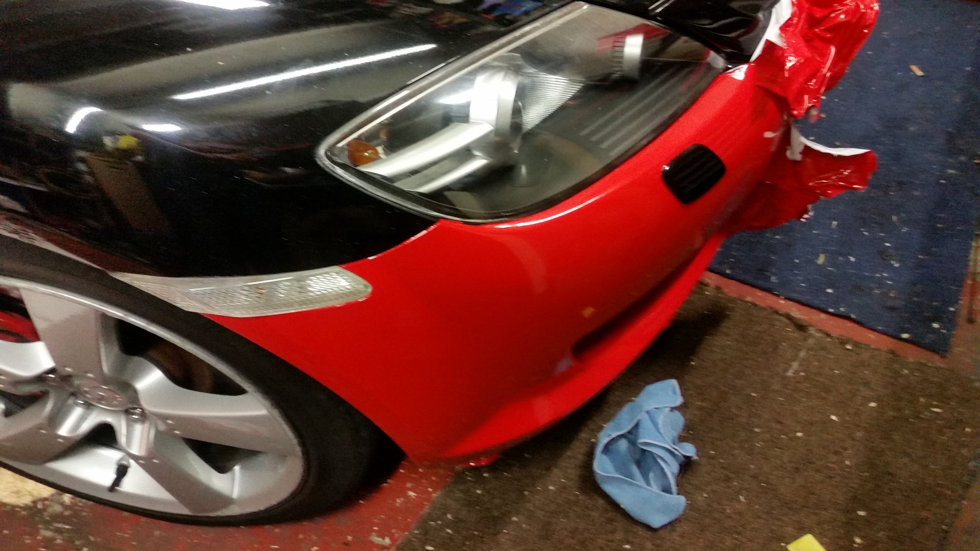

Something we had agreed was that the scabby chipped paintwork needs sorting, I got it a little better with a compounding session and some polish, but its still a long way from perfect. Since I can't really get it painted and then present titch with a huge debt when he returns (not the best welcome home from the wilderness present) I thought I might have a try with some vinyl wrap.
At less than a hundred quid for enough to cover the whole car, I couldn't really afford not to!
I got a couple of bits in red gloss finish to make it more obvious if I had done a crappy job of trimming it around the edges, and so that the gloss will make the underlying imperfections show more. If I do this full scale I will probably use a satin finish black which should mask the imperfections a lot more.
I started with a mirror, which was suspiciously easy 😕
Then full of confidence, I made a pigs ear of the bumper 😂😂
Luckily it just peels back up, so I can piss myself off trying many more times until I get this nailed. I didn't really help myself by being lazy and leaving the headlamp and fog lights in there which made it more difficult.
I definitely think this is worth some perseverance and practice though 😀
