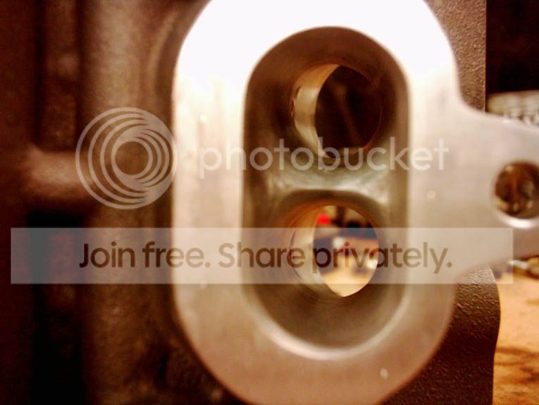

ooh, well polished, whats the spec of the head and the approx price of the work? Was the head brand new or an older skimmed item? More spec on the finished engine mate, keep up the good work

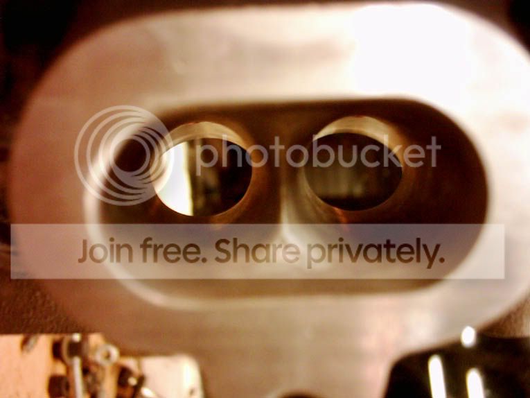

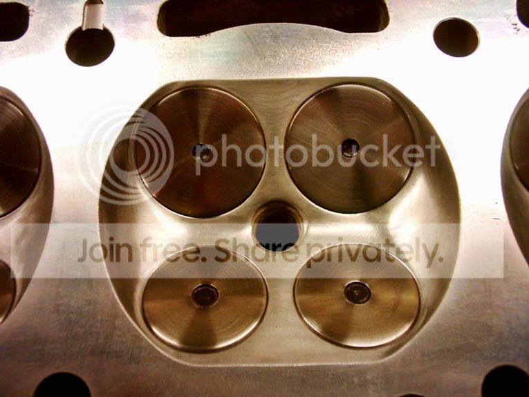

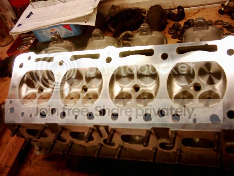

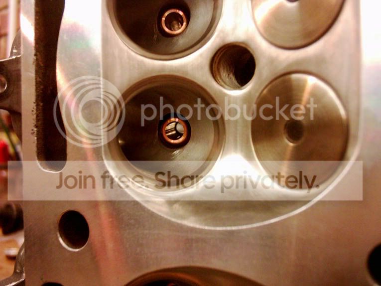

The head’s off the original engine, which has been ported to Group A Spec, with new phosphor bronze Group A valve guides, and a light skim. The inlet manifold has also been ported and matched to the head. All work carried out by Graham Goode Racing. Cost Ł274 for valve guides and labour to fit them, to include cleaning old valves fitting and lapping in. Cost Ł645 for porting and skimming work. Head came back looking brand new, after it had been cleaned.

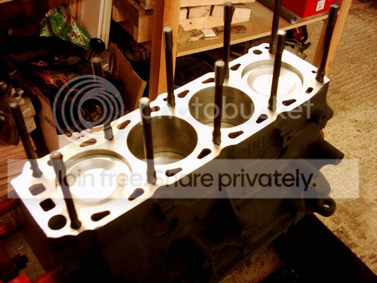

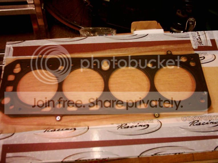

Block has been bored out to .50 over, and fitted with Cosworth Racing pistons. A high clamp stud and nut kit has also been fitted. Conrods all weigh the same, and have been balanced. Big End Group A Spec bolts. Crank has been fully balanced along with flywheel and AP Racing clutch cover. Will have the above 4 layer WRC head gasket fitted.
