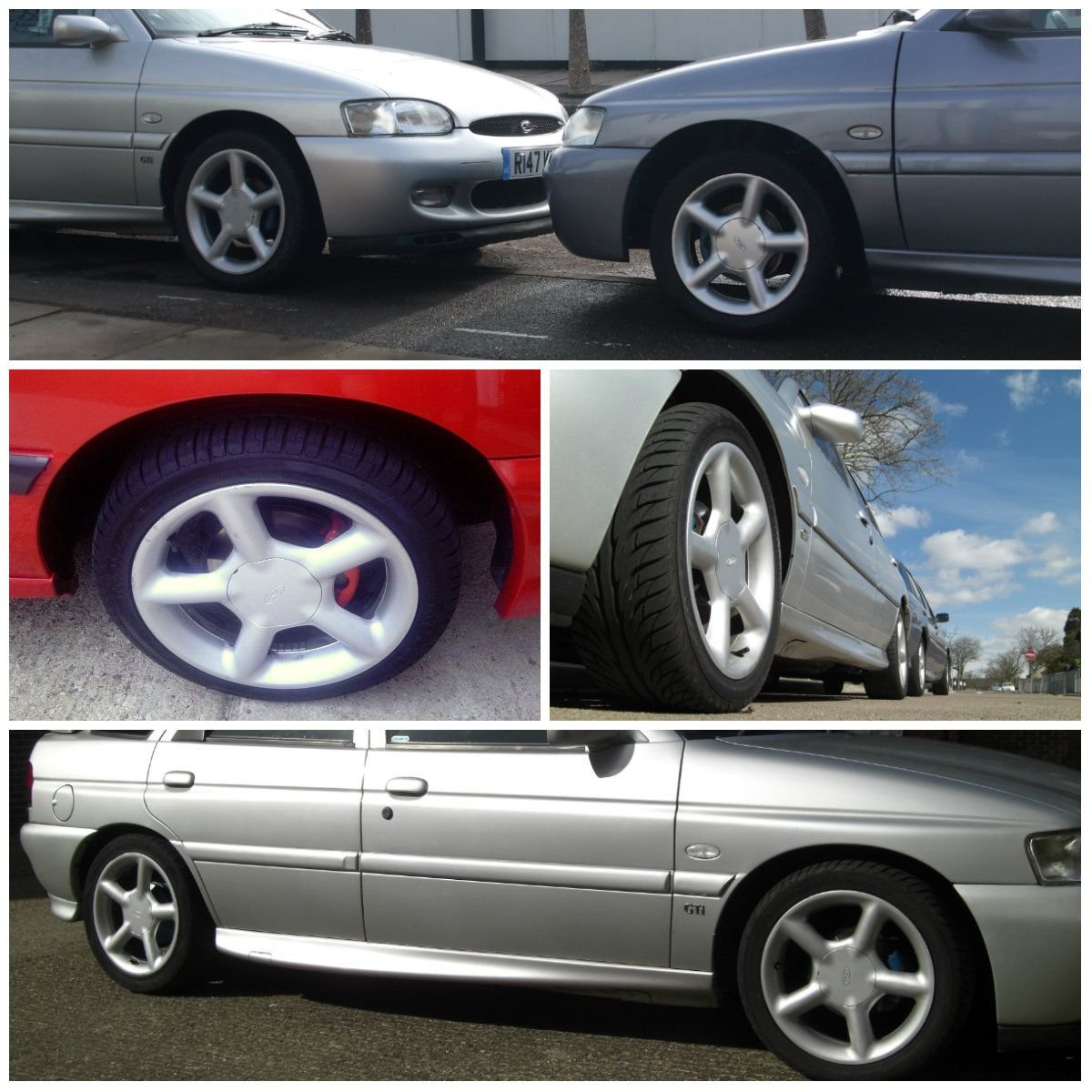

heres a few pics with mondy 16s, as they have correct offset and drive way better too with no silly tyre stretching top pic shows 16s vs 15s

The gti and mondeo wheels defo dont have the stance as the cossie wheels.
Cos im a bit simple im double checking with the 2 cars nose to nose the one on the right is with mondeo wheels right???

Id say the one on the left is the mondies look bigger. Theres no comparison for me mondies are mondies cossies are cossies.

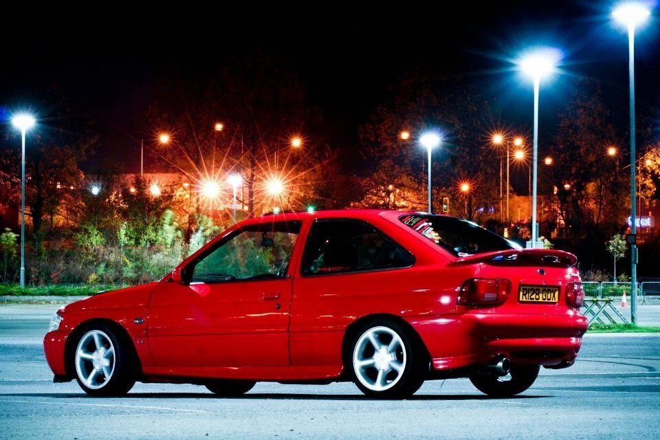

This one
Old Aug 17, 2015 | 06:14 AM
Fordmad!'s Avatar
Fordmad!
Joined: Apr 2010
Posts: 4,033
Likes: 45
From: Ellesmere
Always look good in red shame its a gti
