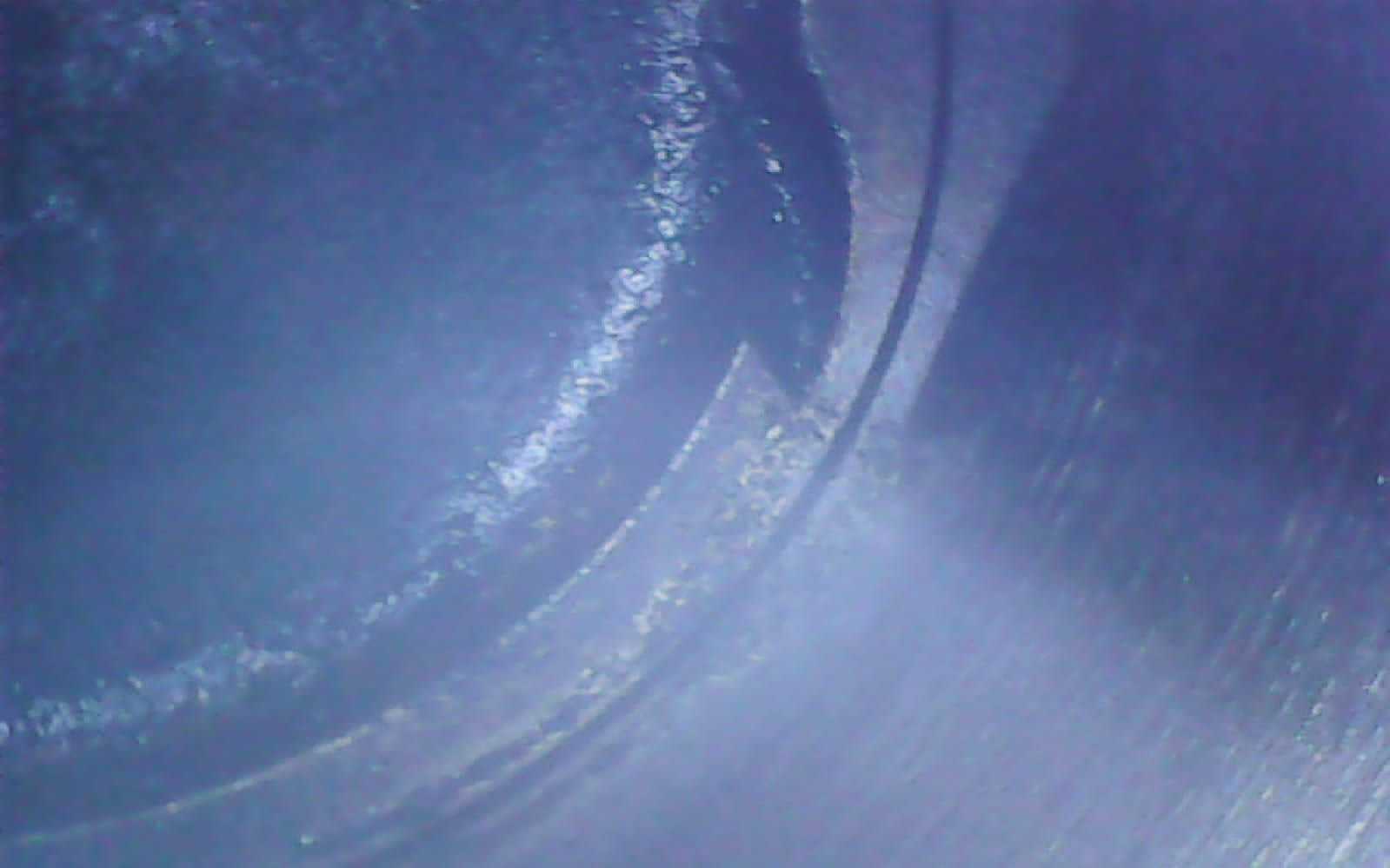

Old Mar 16, 2021 | 06:43 PM
RSBryden's Avatar
RSBryden
10 Year Member
Joined: Mar 2013
Posts: 721
From: Essex (pitsea)

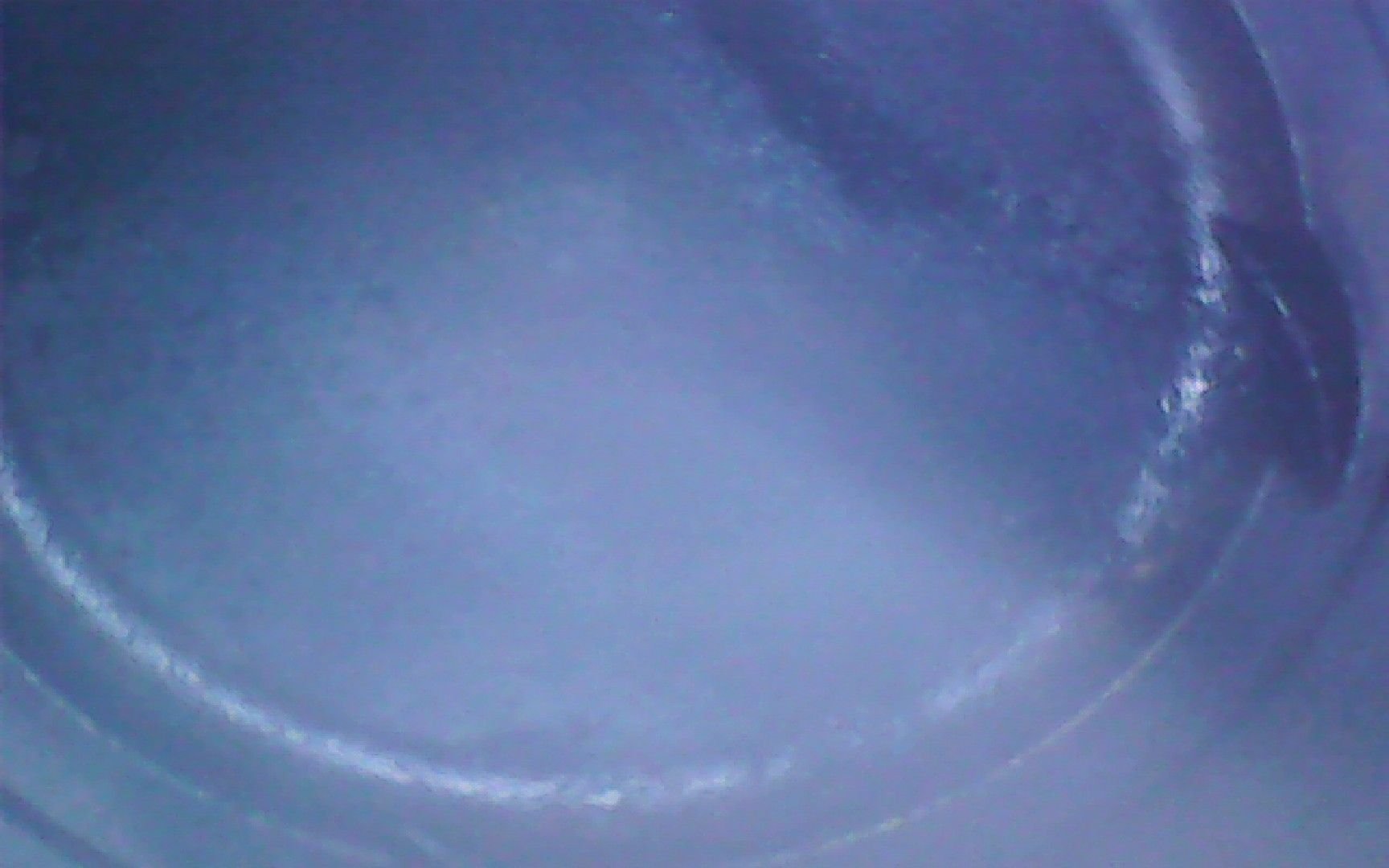

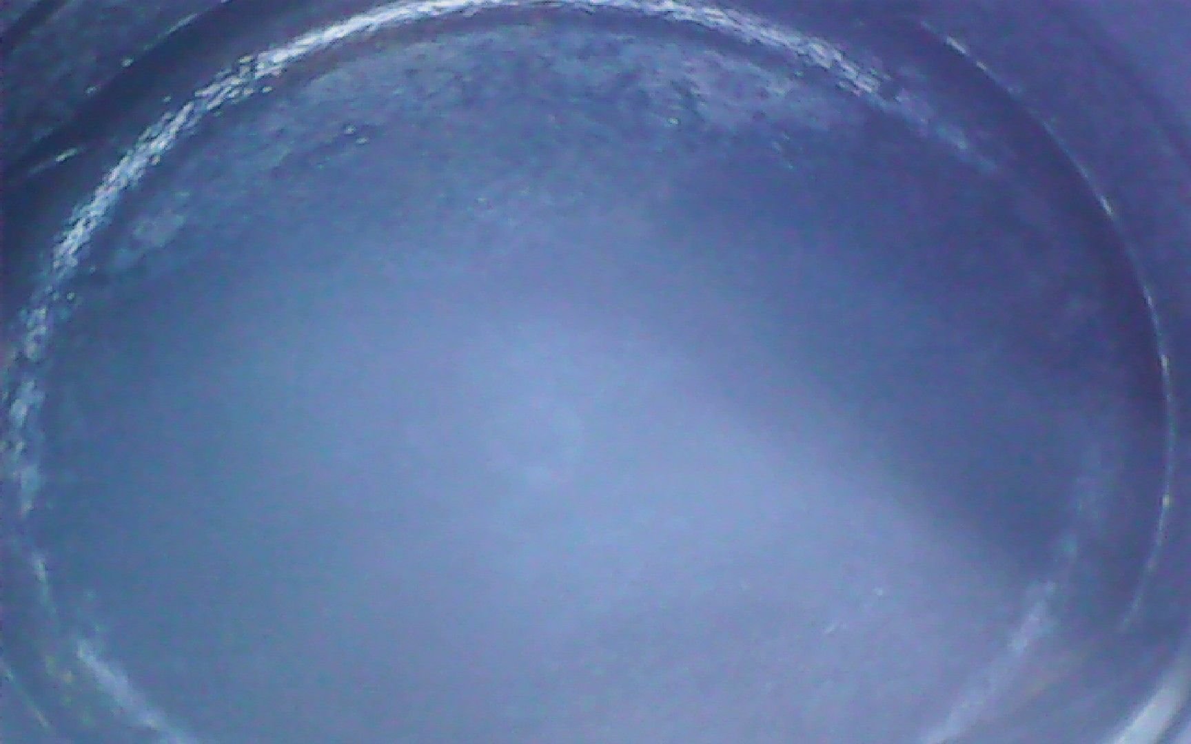

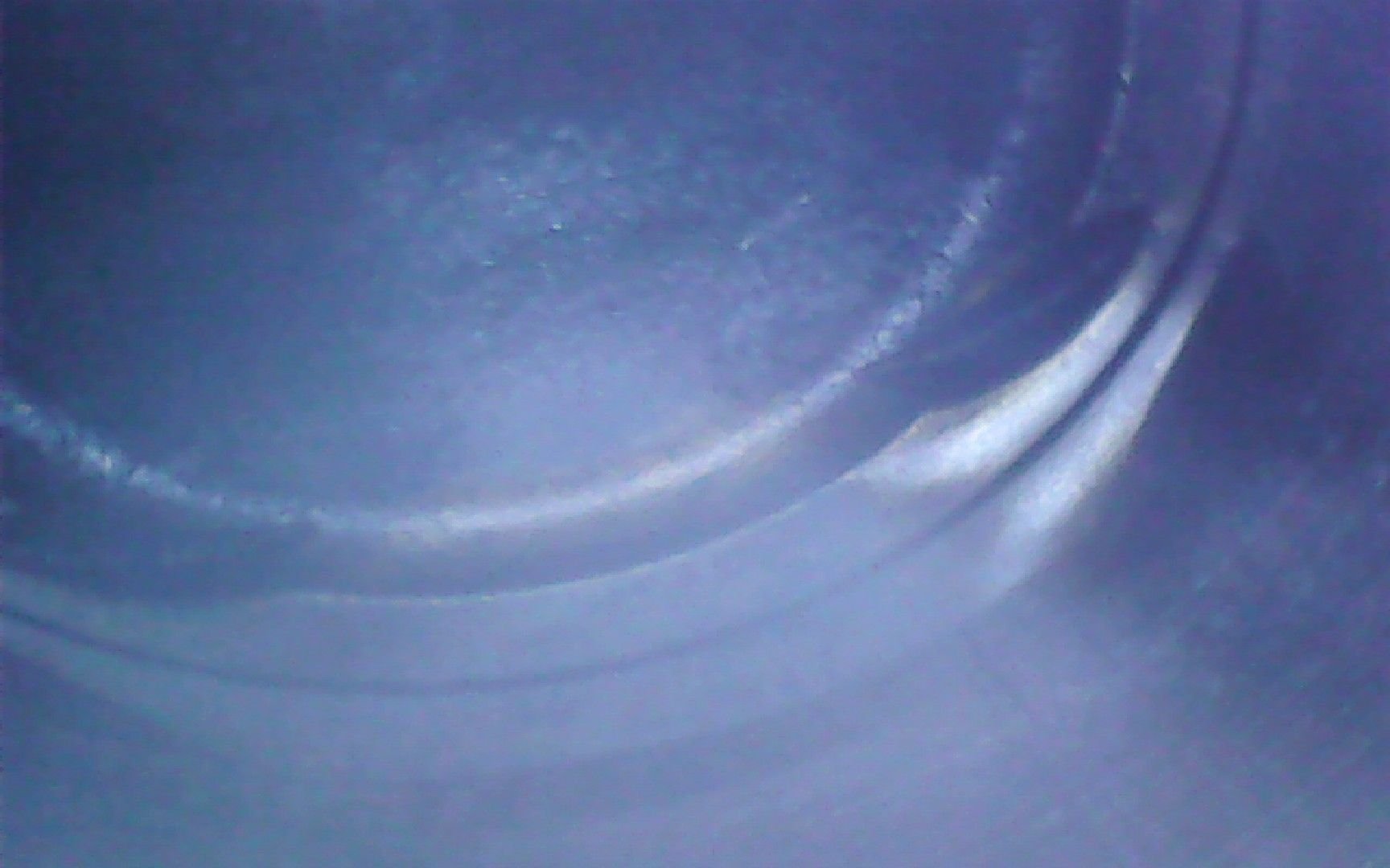

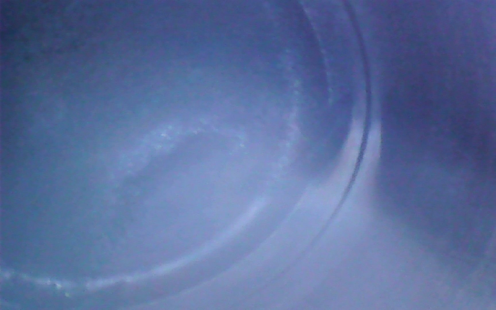

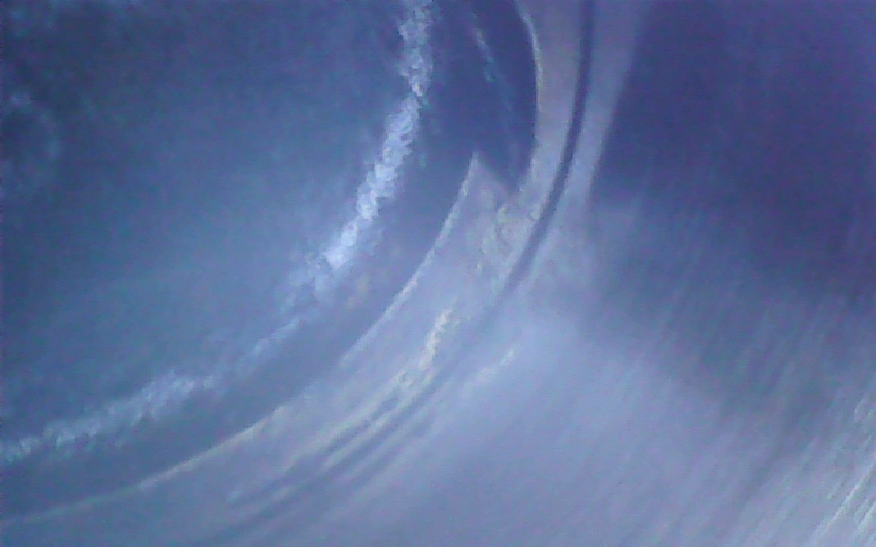

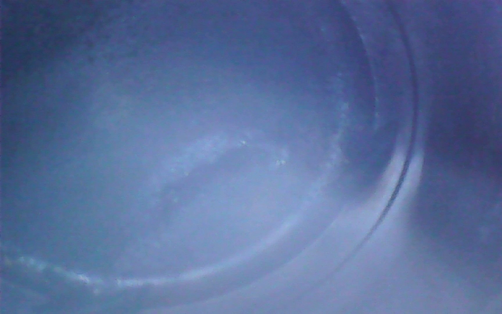

Old Mar 16, 2021 | 06:44 PM
RSBryden's Avatar
RSBryden
10 Year Member
Joined: Mar 2013
Posts: 721
Yeh I think these are ok, they look like weisco and the receipt says they are 😁 happy about that lads I tell ya 😎

I wouldn't say they are Wiseco pistons but don't look standard either so should be good.
Old Mar 19, 2021 | 10:27 AM
RSBryden's Avatar
RSBryden
10 Year Member
Joined: Mar 2013
Posts: 721
I’m glad mate , had a feeling n couldn’t relax until I checked.I bought a endoscope off eBay mate that attaches to my phone Ł15 .. great bit of kit I must admit
