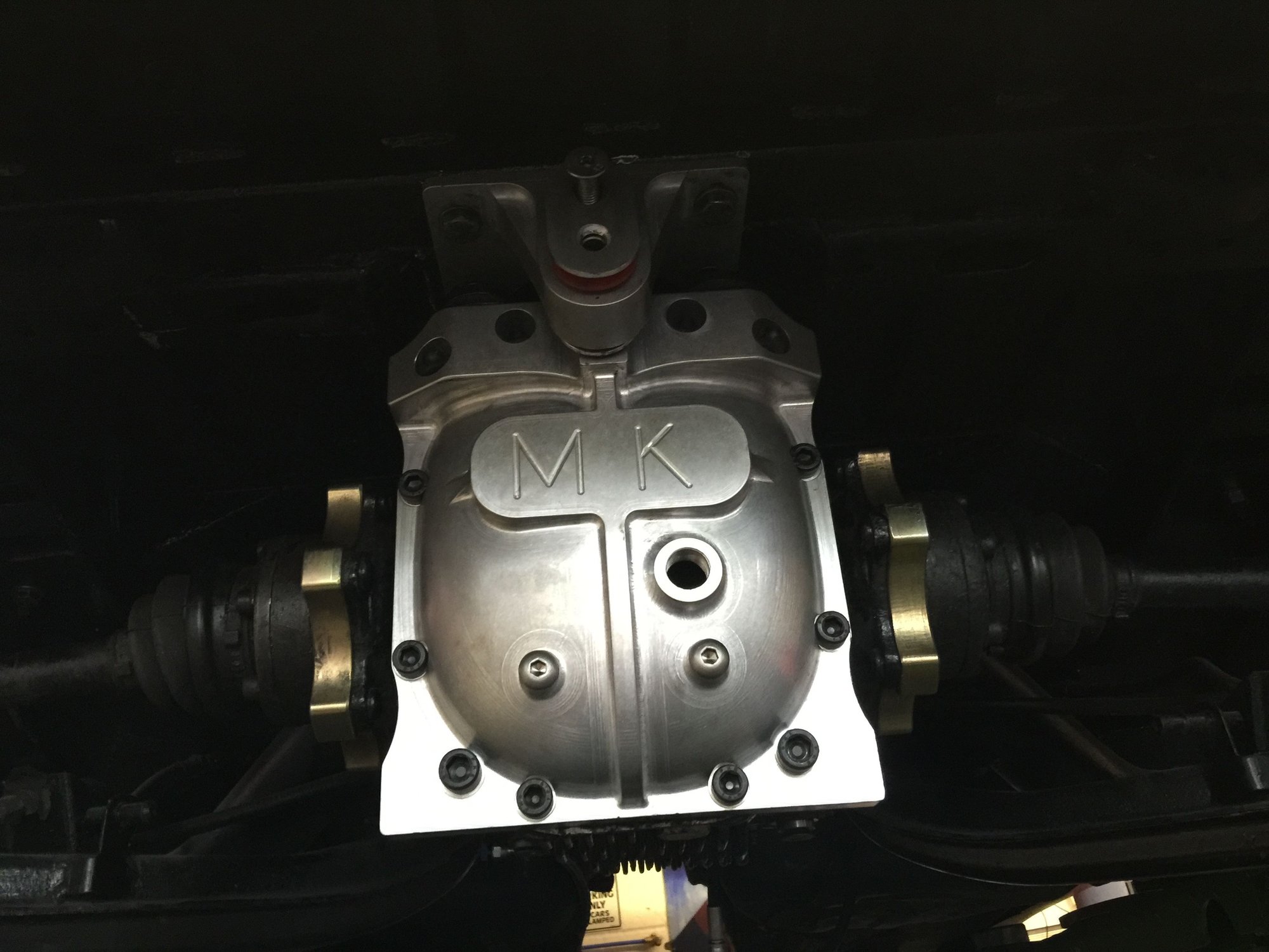

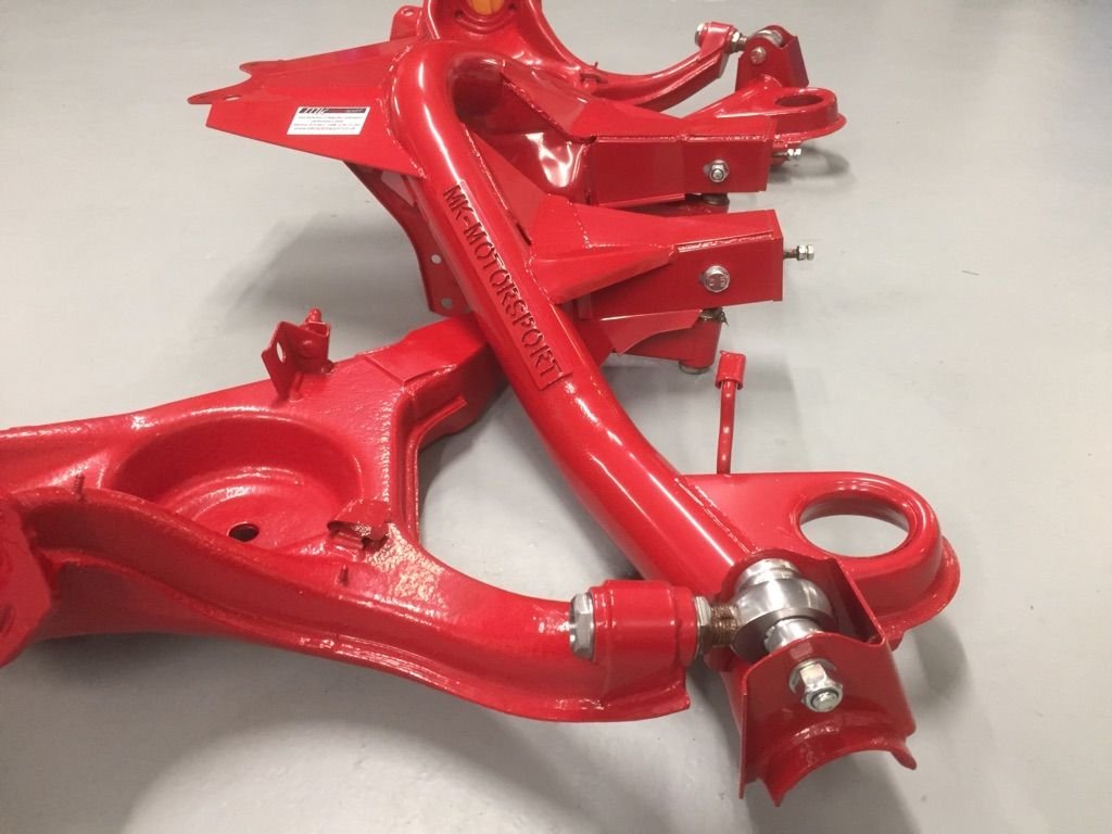

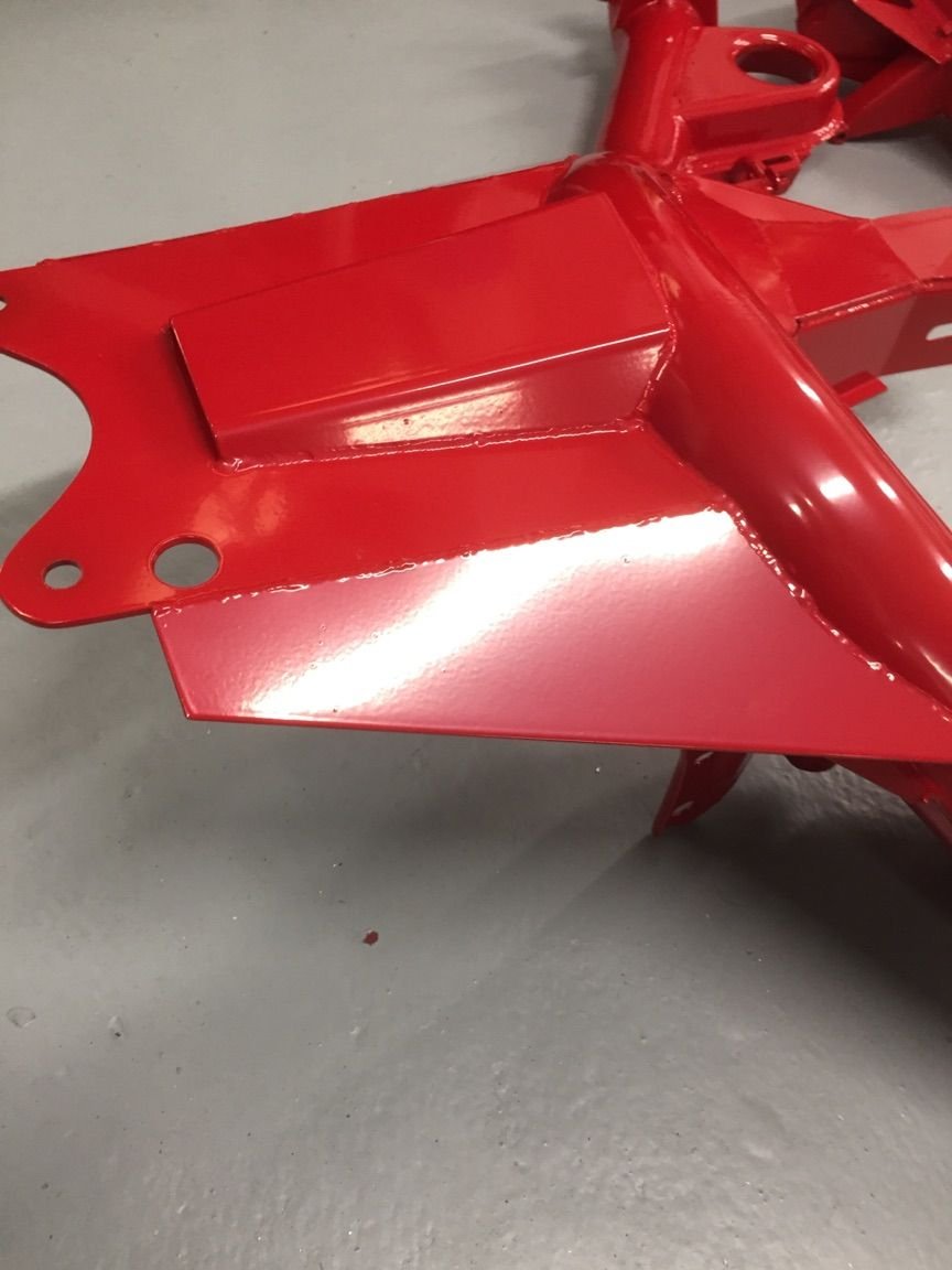

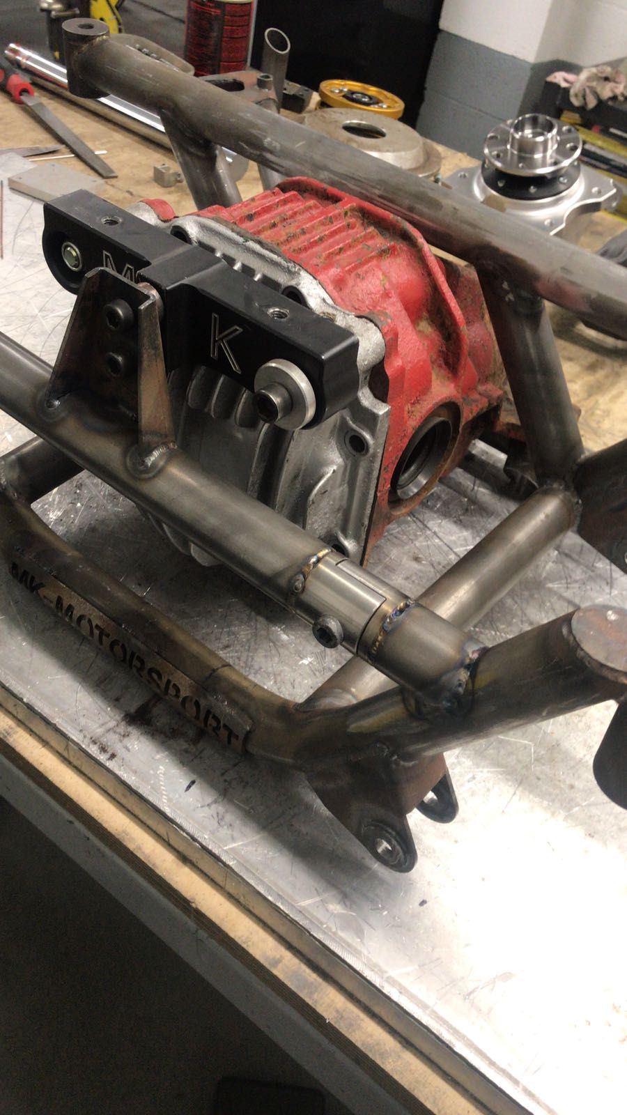

Hoop modded to take the Supra diff without fitting kit (you still need prop and drive shaft adapters though.
6 degree beam
WRC cradle modded for supra diff, you need the boot floor modded and ideally a cage to locate these.
Billet cover on just fitting kit. I think you can get these covers without the square edges now and the MT ones look ace with cooling fins.

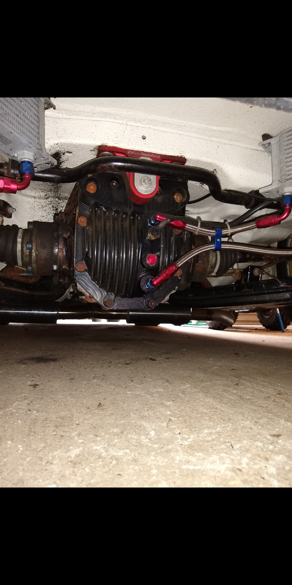

This is my MT cover on my focus . it's got a cooler set up on this one but he did them with out the AN- fittings drilled in the covers
