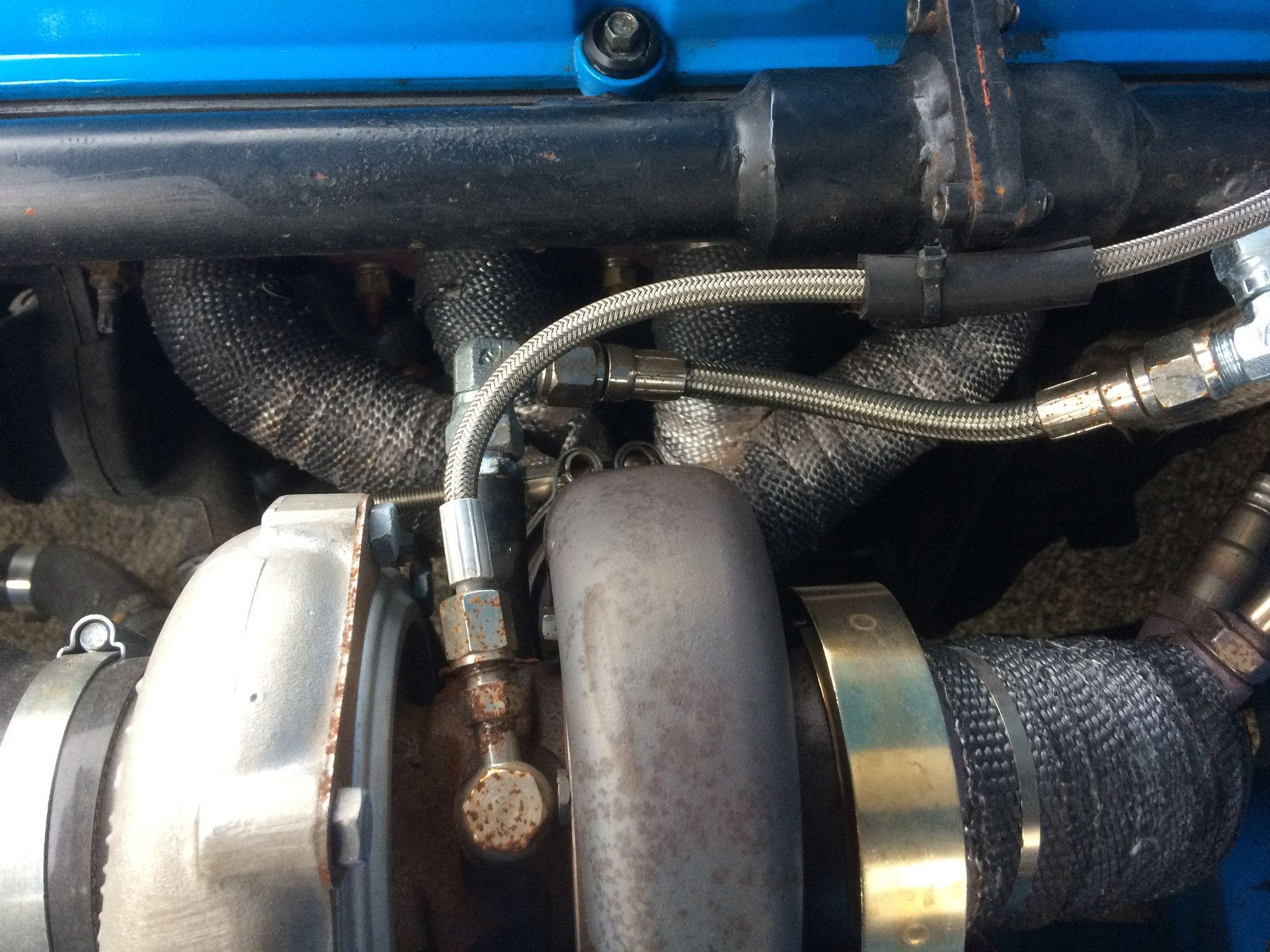

OK there some manifold pics, rough calculation inlet is about 3.6 litres, exhaust manifold is hard see but its basically just simple equal length 4 branch about 12 inches,
And boost controller is an AEM thru boost set at 16psi on a 38mm external gate which dosen't even make that much psi.
Also turbine housing is .86 not .63

Looks a neat conversion

Lovely looking engine bay!

Unless there are huge leaks, the intake and exhaust manifold certainly wont be the problem.
The larger turbine housing would be worth changing to a smaller one though as it should be relatively cheap.
