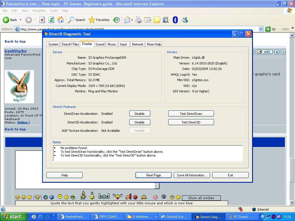

Or, click start, and then run, and type in dxdiag and press enter
Here it will tell you your cpu speed, your memory size, if you click on the display tab at the top, it will tell you your graphic's card manufacturer, and the size of it

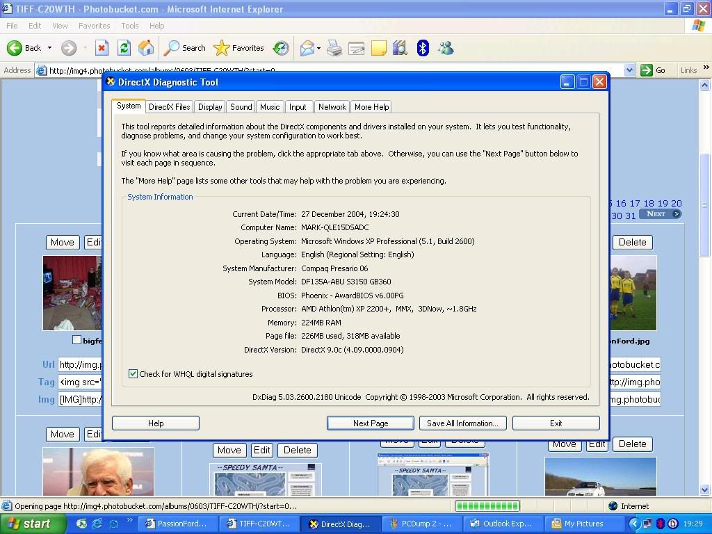

This is what i have
Anygood????????????????????

224mb of ram i thought ya only get it in 256 or summin like that
and it only looks like a 32mb graphics card
although i might just be reading it wrong
looks a bit like my last pc which was able to play games like return to castle wofenstein on low quality

I'd say upgrade your memory at the same time as your graphics card...
CPU is a bit on the slow side for the newest of games, but it will run them OK with a decent graphics card and a handful of memory.
224Mb would "probably" be a 128Mb, a 64Mb and a 32Mb SDRAM chip, unless it's Windoze reading the amount wrong......whichever way, I'd say to upgrade it to at least 512Mb (1024Mb if you can afford to), but you'd need to check if your motherboard can support 1024Mb if you were going to get that much.

RS2k... 256 minus 224 equals?
the graphics (card) is a biuilt in onboard jobby and shares the system memory...
tiff, that PC wont play anything new (ie made in the past year) without slowing right down...
bit more memory and a good graphic card will sort you out to play most stuff acceptably go buy yourself a 256mb memory chip and a gfx card that costs about 50quid and you should be ok

tiffs computer will have an AGP slot (probably with nothing plugged into it as his is currently onboard) it will be the only socket that the card will fit into. (or if it does have a card plugged in, unplug this card and plug in new one)
he simply plugs the card into this socket, and plugs the monitor into the card (ignoring the old monitor connector) and 99 times out of 100 thats it...
worse case scenario you have to disable the onboard card for the new one to work as the primary adapter, but ive never seen a PC that dont do this automatically for you.
als thats left after that is loading on the drivers disk (or do what i do n download the latest drivers off the net, as they get updated very often) and bobs your mothers brother

it is more than likely tiffs pc WILL NOT have a AGP slot
i am a compaq/hp engineer (as ive now said many times)
if its got an S3 card in it will be an onboard bag of wank in a micro ATX case and will not be upgradeable.
that is 75% likely
if that is the case then tiff you will need to buy a new pc to play nay recent games
256mb - 32mb for shared memory(onboard video) = 224mb

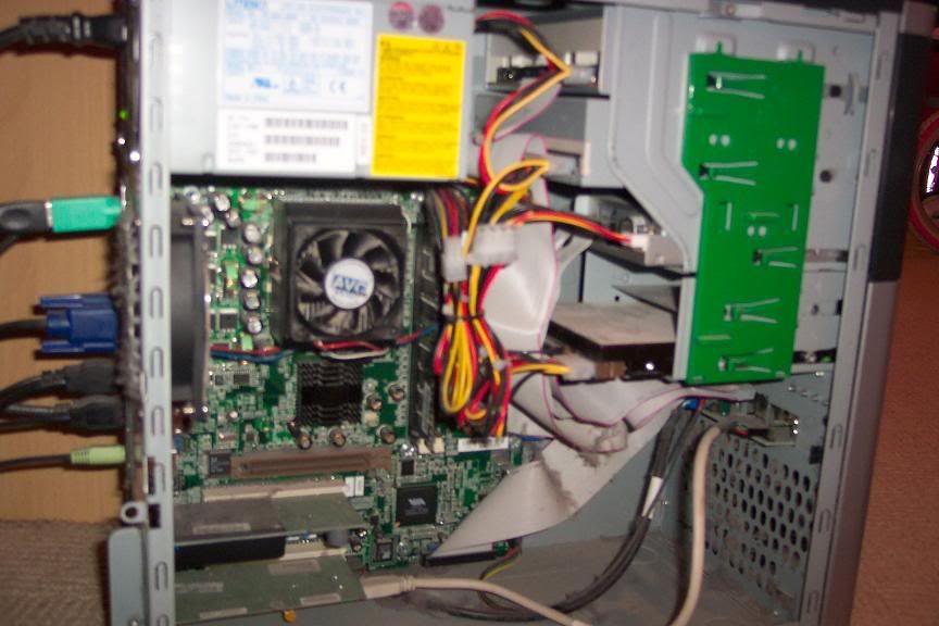

Tiff, whip the side of the case off, and take a photo of the inside, i'll be able to tell you what you need m8
Old Dec 29, 2004 | 09:01 AM
TIFF's Avatar
TIFF
Chasing Radders
Posts: 37,253
From: WARWICK
Ok guys, i will yake a pic now
