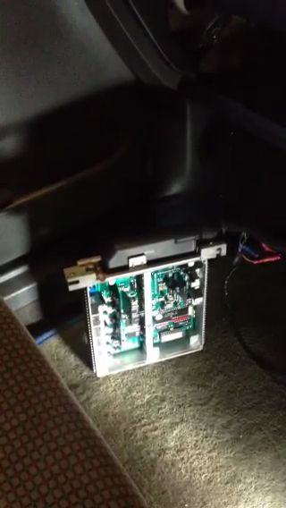

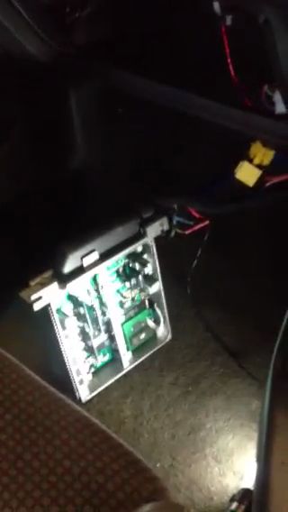

The ecu is
Old Feb 18, 2014 | 09:43 PM
Fezzrs's Avatar
Fezzrs
10 Year Member
Joined: Feb 2014
Posts: 120
From: Stafford
Confirmed the ecu is shot i thought it was had another chip put in doibg the same thing new chip ecu is had it and i can only think wasted spark has burned the board out
Old Feb 18, 2014 | 09:48 PM
Miller 3's Avatar
Miller 3
Joined: Nov 2006
Posts: 9,407
Likes: 12
From: rainham/kent
So you have put your ecu on another car with the correct chip to run said car and it dont run?
Or you have put another chip for your exact spec in your ecu?
Old Feb 18, 2014 | 10:02 PM
James @ M Developments.'s Avatar
Joined: Mar 2010
Posts: 3,480
Likes: 28
From: Devon/Blackpool
I don't know what sort of testing you are doing but I can assure you, you are wrong.
Your ecu works just fine, with my chip in it,
I started a car, and even drove it around our industrial estate using your ecu mate
I'm not going to continue arguing over the same issue, but whatever you are doing, you are doing wrong.
Again, here are the videos. Click and watch.
Your ecu on your chip with pectel L600 board.
Your ecu on my base chip

You say the ecu was running James on your chip well i have had it confirmed by grove garage that tge ecu is the problem and somethibg has caused it because tge lad i had the ecu off said it was runnibg fine until this wasted spark driver that loom wired at the coil pack wired wrong a brand new item that was suppose to be plug and play no maybe have caused it to burn my ecu out and has cost me tge ecu
Old Feb 25, 2014 | 08:06 AM
Joined: Mar 2010
Posts: 3,480
Likes: 28
So watch the video mate, i dont need to "say" it was running....it was and everyone can see it was. Lucky for me i had seen your previous posting habits and also knew you had issues, so was clever enough to take videos
What happens to the ecu once its left here is not my problem.
You still havent told me what was wrong with the loom, sent it back, or given me any information about why or how it was wired incorrectly, so im still guessing about that one.
Im guessing between the lines it was the coil trigger wires that were wiried backwards, (which is what i spoke to gadget about swapping) then that wont cause any ECU problems,
but it has to be said that there are some coil packs out there that are wired backwards internally, so our wiring loom doesnt work on those unless the two outer wires are swapped over (which again is what i spoke to gadget about)
Maybe you had one of those coils as you didnt buy the whole kit from us did you? only parts of it?
