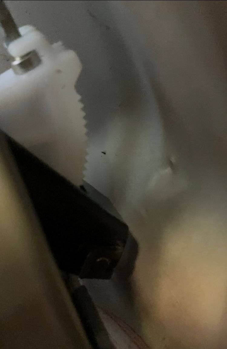

Hey all, My clutch pedal has been clicking/slipping for a while now. I'm driving an Escort mk3 1.1 (1985). So I started a job I wish I hadn’t, the clutch quadrant . I've got it all in bits and had it back together a couple of times (then realised i've missed the return spring or something) but, i'm concerned I havent got the right clutch quadrant. First of all the old one is Black and the new one is White. I bought the Ł3 ones off ebay that say Escort mk3. I also asked the seller if it was right for my Car. He said hes sold tons for mk3 Escorts and had no complaints. I've had this changed by a garage 5 years ago so I have no idea what colour the old one was.
When I fit it to the pedal without the return spring the pawl wont freely "ratchet" down the quadrant. It gets stuck a few teeth in, Is that normal? Or is my old one just worn down as that is free to move up and down on its own.
Also, the cable end seems to not want to go into the end of the new clutch quadrant and when you hold them both together... it looks a little smaller. I'm sure I could modify it but I'm starting to think i've got the wrong part? Can't find anything on the internet that can tell me what a 1.1 OHV 1985 Escort clutch quadrant should be? The new part number I have is SX 6200 and this is the ebay link. https://www.ebay.co.uk/itm/274796490...UAAOSwAWhgVy~r
Any help welcome as i've got the pedals in bits / exhausted myself.

I had another play with these before and the old Pawl (ratchet bit) and the new quadrant "ratchet" over each other easily but, the new Pawl part seems to be the problem. Also there is a size difference. I put them both on the bake/clutch pedal bar and you can see the problem here.
from looking through Fordopedia there are two types and part numbers . 55mm (6194025 -88AB 7L609 DA ) and 50mm (6186200 - 88AB 7L609 AA ). According to Fordopedia the Black one is the 55mm one which seems to be the other way around here as my Black one is smaller.
Also the cable will pass through the end of this part and not through the white part. Although, when I look back at pictures from this morning the cable was only resting underneath the quadrant anyway.

3rd time lucky!! What a horrible job. I filmed it all so hopefully it will help others in the same situation. I'll compile that later. Recived a call from Midnight Motors in Watford today who found me an old copy part that they used to sell back in the day... high tailed it up there to get some great advice and a great part! once home i swapped over all the bushes and parts over to the pedal to find a working ratchet, success!!
I'm not going to lie, putting it back together was a nightmare. Easier with this part though. In the end I set the quadrant/pawl, that rested on the plastic bushes just enough (the old one didnt) to slide the spindle bar through the pedal. Then after a few tries I got the clutch cable through and clipped in (again it wasnt on the old part) then I used a guitar string round the handle of a hammer, though the eyelet of the clutch pedal to pull the return spring into its rightful place, with the nudge of some pliers from behind. After this it was easy enough to fit the brake pedal and clip it all in.
The only other issue I had was getting enough slack on the clutch cable. At first with the Quadrant set to its most neutral position I couldnt get it to reach the gear box. Lots of head scratching and thinking about putting the old Quad back in passed and then after another go it must have moved down the ratchet a bit to where the black quadrant was sitting. Then I had just enough slack to get it on the gear box fork.
I guess this means the clutch is about half way worn? Either way. Went for a drive and it was a lot better! even managed a pretty low powered wheel spin which used to send the old quad into a hissy fit.
