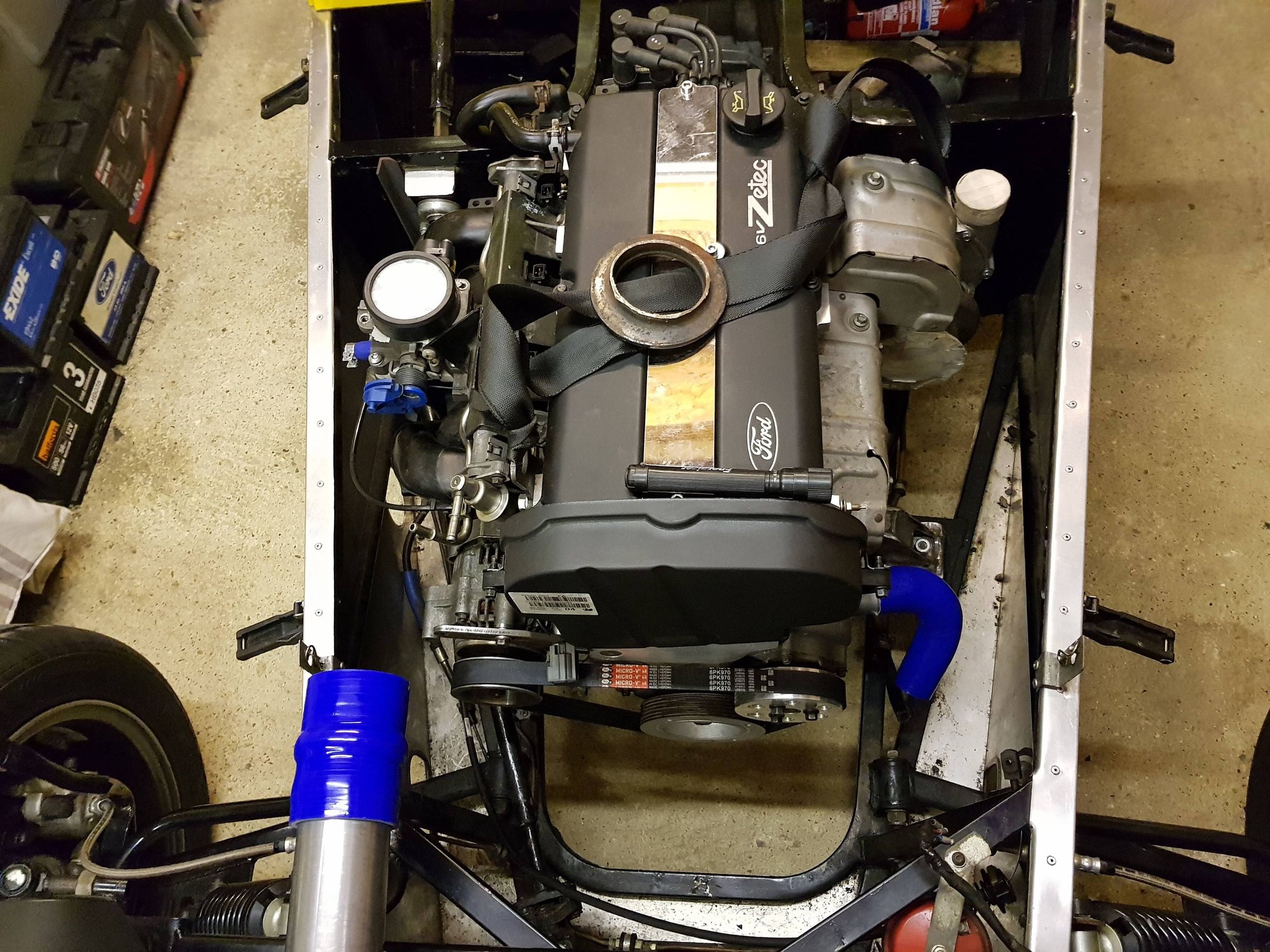

I doubt I will go much more than 275bhp so we should be good with the box but I’ve also got an Rx8 5spd to play with.
I have a Turbosport flywheel with Rs clutch cover and helix plate. I have an lsd to fit but may leave that until next winter and get a Quaif.
yep I am building it up my self.
Engine is an St170/Blacktop hybrid.
I’ve got a few inlet / outlet options. But the current set up is an Oem 2.0 Zetec exhaust manifold turned upside down with a clocked Impreza Td04. Inlet is a steel plenum but It’s only to get me on the road for the summer and I will play with it until next winter.
Its all controlled by an Rs ecu, because I can, because it’s cheap, because I can plug it in and go. Want a bit more power and I can stick a flash tune on it. A bit more, stage 2, a bit more and it can be mapped by Sabre.
mock up

Back into the garage to work on my loom I go, feck me it’s cold in there today. Show season is getting nearer.
Cheers bud. WIll bang some picture in of the project as I go. May end up using a custom fuel rail. no idea what options there are yet. My main experience is on supras and german stuff so Im a bit of an old school ford amateur. Going to take a look at the fuel rail and inlet.
So your saying an RS inlet will work on the silvertop with less messing about? I think the sards are side feed, will have to dig them out and check.
I'm headed outside to POR 15 the tube chassis and respray it after about a week of surface rust removal. It is indeed fackin freezing lol

Ah ok they should fit then but check the seals on the rail to sandwich plate. What they from then ? Supra, Rx7.
yes the Rs is just a Blacktop and they bolt straight on to a silvertop. You may not have to mess about after all. I wrongly assumed your injectors would be end fed being so large.

Just to update this. They arent end feed they are side feed injectors. Just tried fitting them lol. So looking at what options are for fitting to an HO inlet

It’s a bolt on fit.
Just check the seals between rail and sandwich plate. You don’t want it to bleed boost or draw in air.
I would still decide what management will control them with and check they are the correct impedance ( hi z low z ) and ask the mapper what they think to them.

I dont know what happened to my original injectors so I cant compare the width of them, but they seem to not fit in the bottom of the machined holes, slightly too big! Will take a look tomorrow. THey are high impedence SARD 800 cc injectors. Used them before on other cars (different set) and they are spot on
