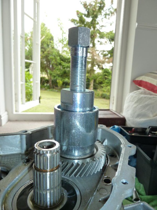

I'm trying to swap bellhousings on my ib5 box and it seems this is stopping me. Anyone know how to get this out or off?

You need to strip the rest of the box, the fifth gear comes off first (needs a special tool to pull it off), then the 5th gear housing, then the centre housing, the bell housing is last once the rest is stripped.
You're looking at (pointing at) the selector shaft.

You might struggle to get the 5th gear off unless you have the proper tool, that's one of the first things that has to come off when stripping these.
Found this how-to strip the box to fit LSD, you need to do basically all this, and then you can remove the selector shaft , that's in the bottom.
http://www.projectpuma.com/viewtopic...1&f=51&t=13266

Ford tool 308-082 IIRC
Pic of it on above link.

How hard would it be to get 5th gear off without the tool?

Very.
You can't get a conventional gear puller under the teeth, the proper tool uses the lip on the top of the gear to pull it off.
Even with the proper tool, they are tight to get off.
