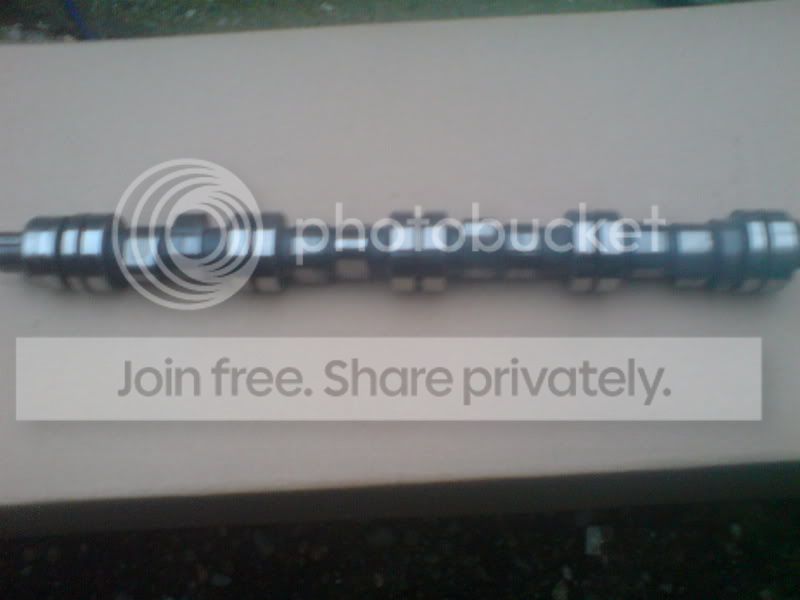

Just removed my "worn" cam and i cant see if its worn or not.
If this isnt worn then i have no idea whats wrong with my car
let me know

nah it doesnt.

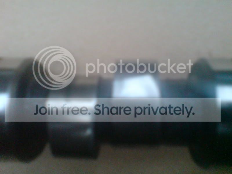

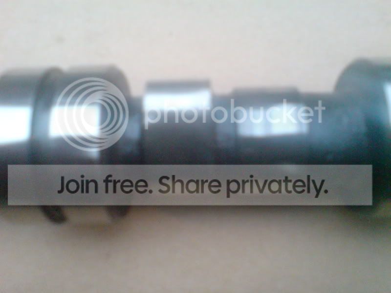

There is no way anyone can make a accurate diagnosis of that cam due to the piccies being blurred.
If two of the hydraulic followers were hard to get out, have a close look at the surface they run on, you may well find it is cored to buggery.
This wil certainly give you constant noise if bad enough to jam tappets them only freeeing off each time they are whacked by the cam and pushed down again, my suspicion being if they are jamming without fully rising again due to the valve spring pressure, the valves will of course be open.
The cam is in constant contact normally, albeit very gentle contact when off lobe, then gently pushes open, but if jamming you get a sudden clout as the lobe hits the bucket each time.
The cam may well not be worn but it is crucial that the followers slide freely.

he ment scored fella in your pics to me in certain places your cam has lost its hardness!

If two of the followers were stuck then that is a sure sign that the cam is worn, although it is impossible to tell from those pictures alone - although there do seem to be some wear lines on some of the lobes.
When the cam starts to wear it mishapes the bottom of the follower, which "spreads" out. When you then try to remove the follower it scores the bore - which is what Tabetha was referring to. This is not good.
What you should to if you can't get a follower out is remove the cam with the stuck ones still largely in situ. Once the cam is out of the way you knock the stuck followers into the head and push them out the camshaft hole. Wrenching them out with pliers is a great way to wreck the bore so the new follwers don't fit as well as they should.
When a cam is badly worn it may or may not be noisy. I had one that was really badly worn - about 3mm of 4 of the lobes but it wasn't noisy. I replaced it because power was down so much - the engine wasn't revving past 5000rpm. I put a EFi CVH cam back in insead of the normal one - it makes a huge difference and seems to work really well with the T3.
