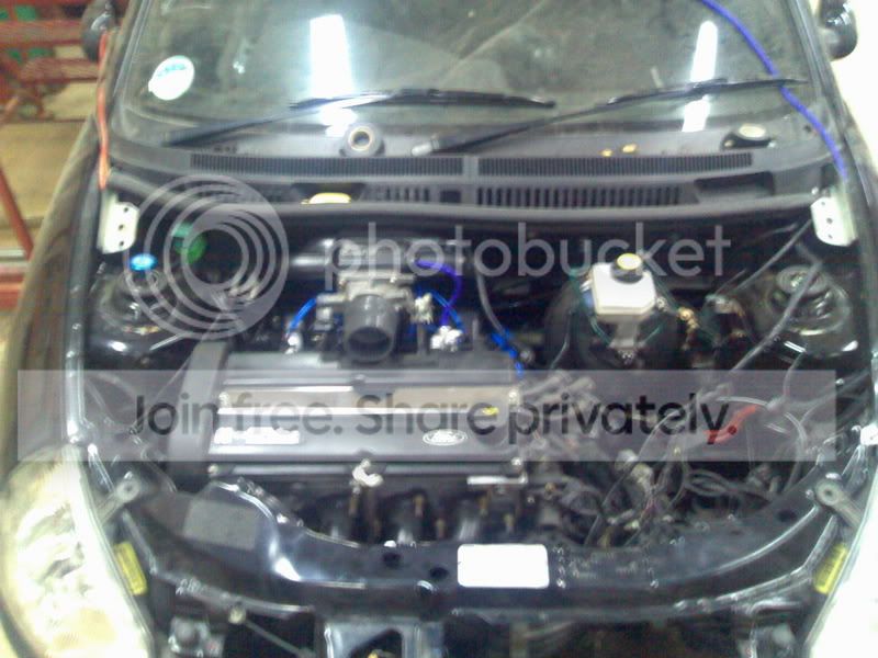

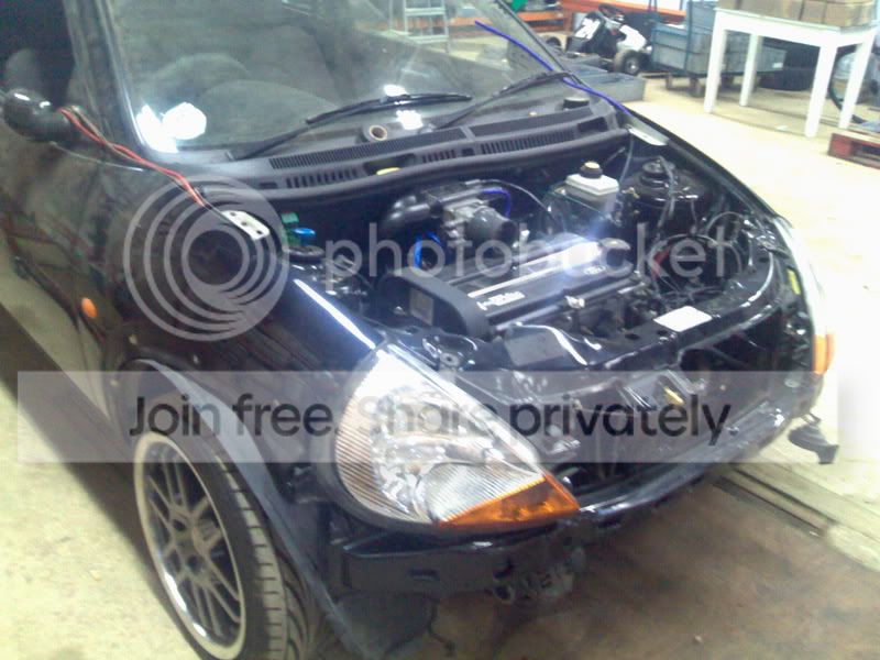

mondao one and still used the escort waterpump.
custom mount for the alternator and a idle pully.
im runig at about 160bhp and its realy good fun. i think a LSD out of a BC box will fit the ka ib5. if you can find out if it dose it might be woth fitting one as there pretty cheep second hand. it wheel spins alot.
Old Dec 7, 2006 | 07:03 PM
joey-p's Avatar
joey-p
Posts: 81
From: herts
havent got any recnet pics, but this is the most up to date i have when i was almost done .
