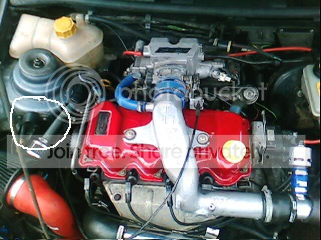

if the pic below, there is no pipe coming of the right hand side of the amal valve, i cant for the life of me remember where its supposed to go, i think i remember the old one going to the air fiter hose but ive changed it for a samco, anybody help

maybe im using wrong terminology, what is the little valve thing that regulates boost pressure and is on the side of airbox on standard cars

Are you thinking of the idle speed control valve (ISCV)?
Although it was only early 2i's that had the ISCV on the airbox, all the later ones ar mounted in the same place as yours is on the inlet manifold.
If we're still not talking about the same things circle it in the picture

this is it mate. def not idle speed control valve

Breather pipe
On a standard air box the pipe would enter the airbox and the oil fumes are burnt in the engine.
Because you have a cone filter i expect there is no where for it to re-circulate into. Its fine like it is, the only down side with it being you MIGHT notice some fumes in the car when in traffic etc

im on about the little black thing on the susp turret

Well, it would seem that does look like an amal valve (i didn't know they were mounted there from the factory )
Anyway, FRST's only have a 2 connection amal valve, so one side goes to the compressor housing, and the other to the actuator
(PLEASEEEEEEEEEEEEE tell me you haven't been driving it with a pipe off )

lol no i stripped it for a resto but cutting it short and kinda forgot where the pipe goes. the thing is though the a previous owner somewhere along the line fitted a death valve, sorry bleed valve just before the amal valve and the way the pipes are the one from the turbo and actuator are together on a t-piece so nowhere to put the second hose

I presume you are removing the death valve? Have a look on the amal valve pipes to see if there are any letters such as "w" and "c"

yeah the death valve WILL mostly be coming off very soon. am i right guessing w= wastgate and c=compressor?

If thats the labels you have then yes
Even if they are different its usually easy to work it out, a bit of common sense

ok been to have a look and theres nothing on them at all so it can only be either 2 ways so maybe hazzard a guess and see what happens if it goes wrong ill know it was the other way round

The worst that can happen is the boost will be low really

On the FRST one pipe from the amal valve goes down to a t piece to the actuator/compressor housing and the other to the air box or in the OP's case the connection just below the filter.
It doesn't matter if the pipe isn't connected it will just vent to atmosphere instead of into the intake, I have mine like that on the EFi Escort.

If you look on the side of your shiney new Samco hose there is a little pipe for you to connect the amal valve to.

i did see that but as you can understand, i dont wanna start connecting things up to places i aint sure they supposed to be just in case
