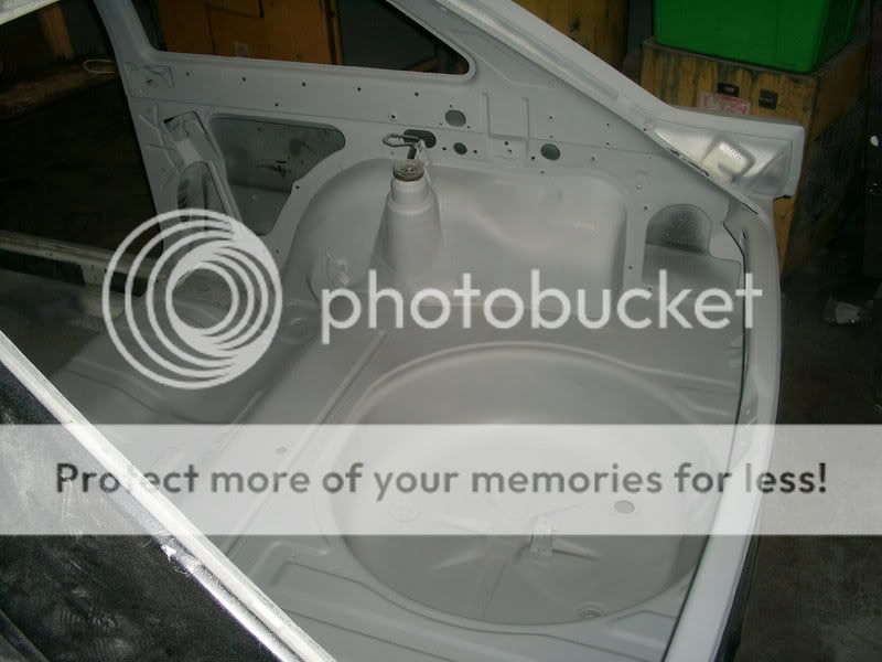

Hey Ladies and Gents..
Yet again another apology for being a slacker lol.. I have been a busy boy again.. Just wish i had more time and money to finish the old girl off instead of burrying her in the garage for months at a time..
Another update for you..
I'll do my very best to not do every image with a bit more bare metal showing lol, So i'll jump straight in with this little lot..
Thanks again for your patience!!
All ready for the joins and edges to be sealed up and another layer of primer before the stonechip goes on..
More sealing to be done lol, then hopefully some two pack primer going on afterwards..
Crap pic alert
Next stage was to do exactly the same to the engine bay area that i did to the rear sections.. Technically its a smaller less troublesome area to do but it was early days to make rash statements like that :biggrin:
Just liked this view so i took a pic
Rear is now all sealed up, Next is basically be to lightly pad it all down and hit it with some primer to seal the whole rear section :biggrin: This will then be followed by a nice healthy portion of Stonechip..
Also whilst waiting for the primer to dry, I continued with the engine bay cleaning up..
So thats all the rear section sealed up :biggrin:
On with the Engine bay..
To be continued..
Cheers - Phil

Moved back onto the back again lol..
Finished off in stonechip..
Then back onto the floorpans and front lol..
Nigh on all the engine bay and centre floorpans were back to bare metal at this point, I basically had a days graft left to get all the edges and corners done before the 2-pack etch primer went on :biggrin:
Ohh yes Baby!!
To be continued..
Cheers - Phil

Aaaaaand Carrying on..
laid down some 2-pack grey primer for some high build so that i could bury some of my impatient grinding with a nice flatting back..
Started sealing up the engine bay too at this point..
Onto the stonechipped Floor (In best Jeremy Clarkson voice :biggrin: )
To be continued..
Cheers - Phil

This next stage is the milestone i have been waiting over 4 years for.. The application of some good old Diamond White..
Still have work to do on the outside of the shell and closures so its only the engine bay, floor and insides that got splattered with the white stuff lol..
Will shut up again and let the pics do the talking.
As ever time was the bug bear yet again so i had to rush and fit her back together and get her back home..
Thats it for now Folks.. She is now all snug in my garage.
Next step is for me to save money now as i have to make loads of purchases before i can finish the paintwork off..
Updates asafp..
Thanks for looking, Cheers - Phil
