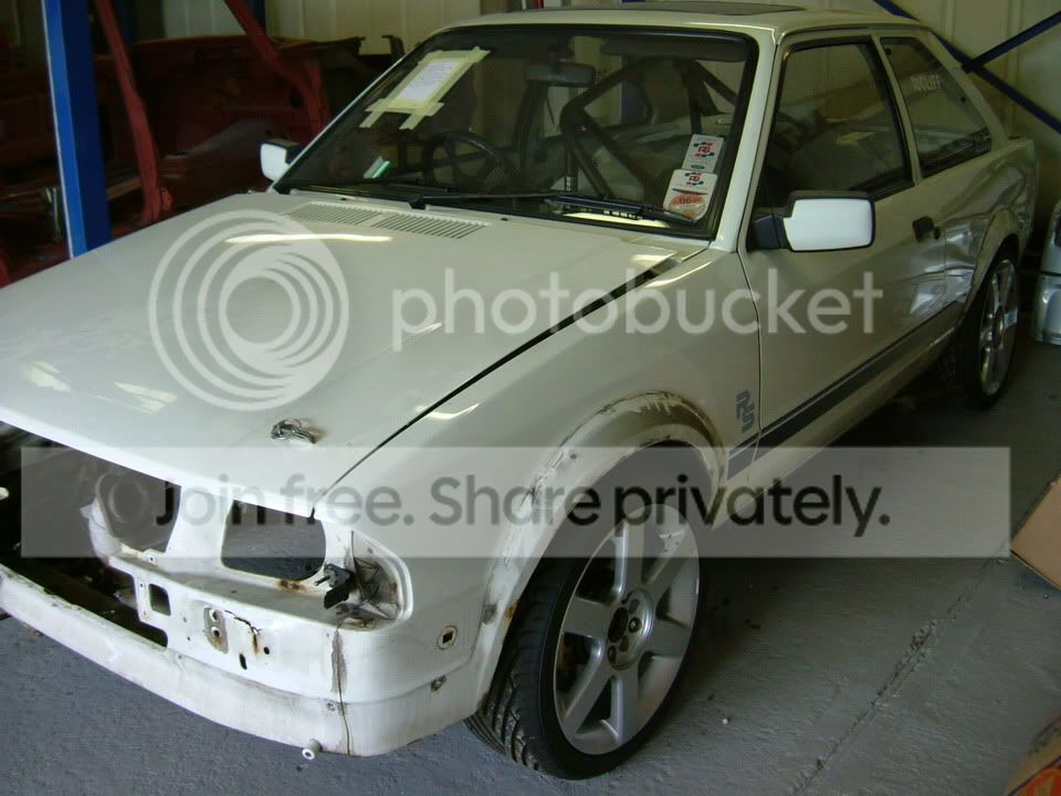

The not so good bit, however not that bad
It looks really weird without the spoiler
A nice bit of rust there

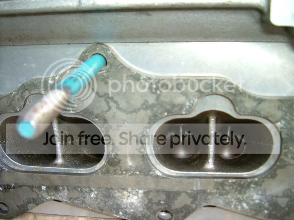

Oh and it's not a standard head either
Check out the port sizes on this baby
This has a butterfly affect on this as it was for normally aspirated. Half stay shut when poodling around and the they all open up on full chat. This affect may be getting binned as it's for a turbo conversion and is already force fed.

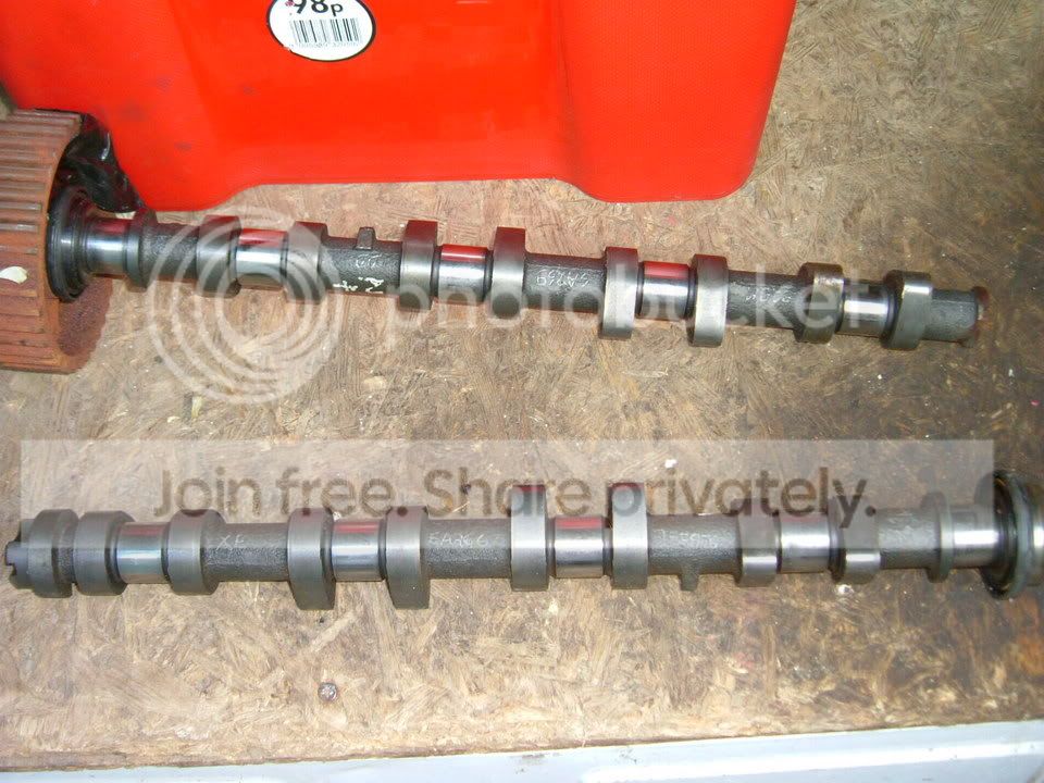

The cams, these are the equivalent of cossie BD10 cams.

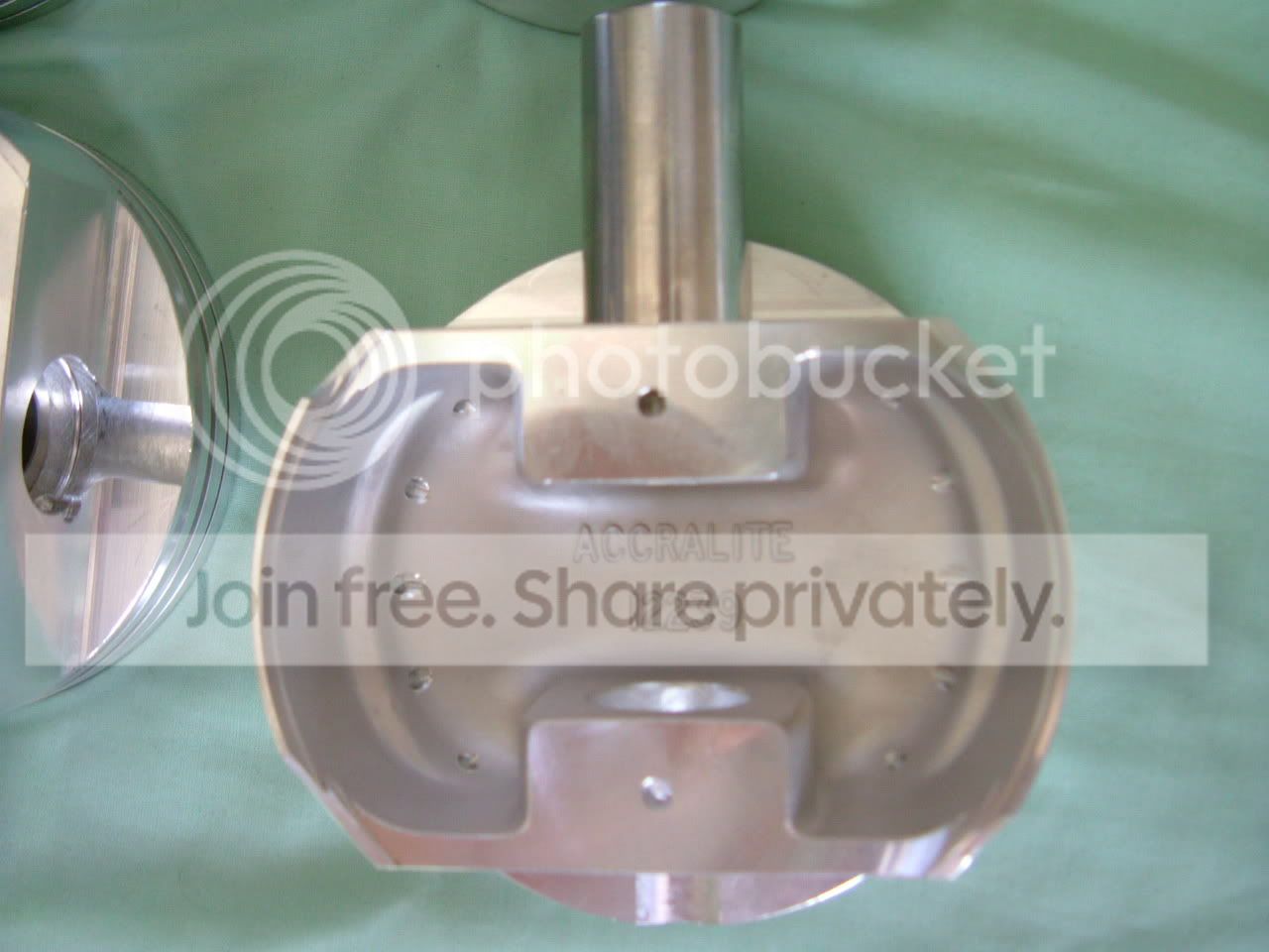

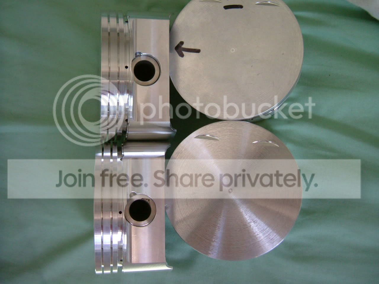

Now for the rods and pistons
Farndon steel rods with Accralite pistons with a 7.8 compression ratio for loads of boost
The whole engine was specced by Noble Motorsport who build the engines for the famous Nobles. The engine was specced with 400 bhp in mind running a T38 but I am going to stick with my T34 for the moment as it will be my track weapon and don't want it too laggy. Everything has been machined with cossie management in mind and it even has a sensor on the rocker cover incase I want to run coil packs. I will most likely go this route.
The whole engine has been balanced including the clutch and there has been work to the crank too.
