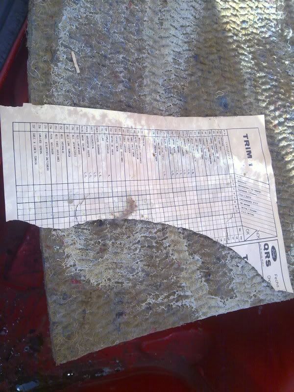

Hi all well as you no we found a nice little 950 pop plus for good money we striped it out yesterday if it wasnt for the fact it had a sunroof it would be mint but as it stands we will have to replace the two front floorpans and need to sort out a bit in the boot where the water tank was fitted as its started to go there to an we are goin to need to sort out the roof as well witch is quite bad as there gotta be about a 10mm X 200mm hole along the edge of the sunroof but apart from that it was wax oiled from new so the rest is mint
oh yeah an we found some of the original paper work stuck to the back of the head linin
next up is engine out today witch souldnt take long an sort the roof out
