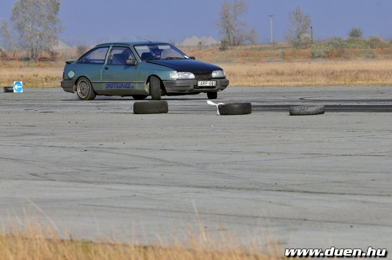

The car works fine on straight road, but front geometry is wrong and when its warm-hot, the engine misfires. After a few hours the suspension came out quite good, but after a nose heavy escort mk1 V6 cosworth Jatis hardly handles the high pressure big lag turbocharged sierra, that moves much sensible, ho hard movements on the steering wheel like the escort.
Nice backwards, but its not the entry, its the second corner
Jatis did not make the Top16, but the car has so much potential, i thinking about keepin and do the fine adjustments for better using as a daily drifter.
