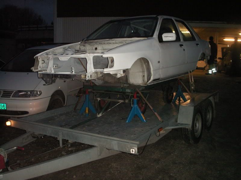

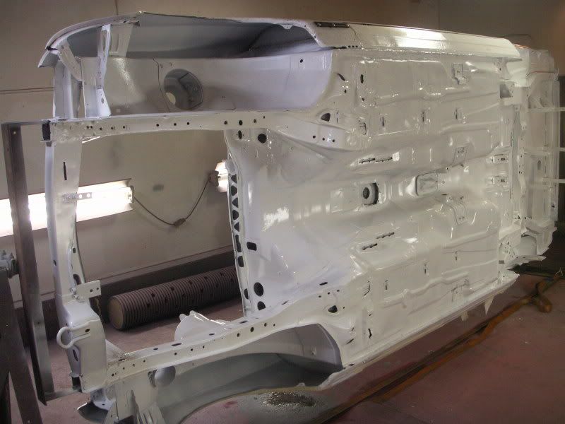

progress has been a little slow over the last weeks, but atleast the car is painted now.
on the way to the paint-boot
filler sprayed
white paint!!
smoothed enginbay
have started mounting some small bits now, and as the first trackday is only a month away it's gonna be some busy weeks now!!

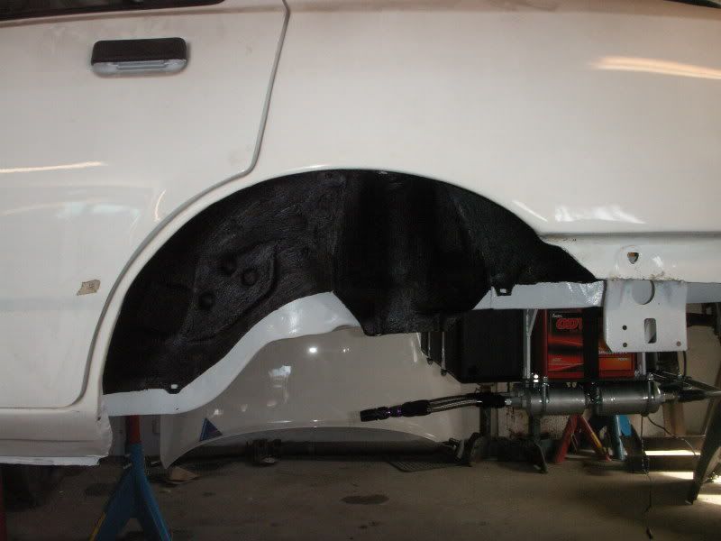

-front and rear suspension mounted.
-inner arches covered in black undersealer.
-almost all brake-lines are finished.

front and rear innersraches in undersealer
fuelsetup complete and battery connected

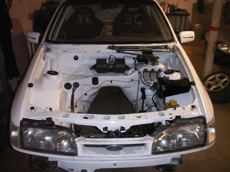

enginebay starting to come together
well pleased with how it looks, clean and simple

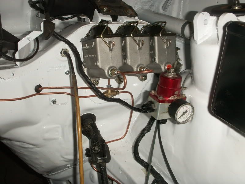

pedal-box outside, and fuel pressure reg

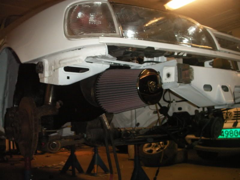

almost finished with the "interior"
pedal-box all adjusted inside. only need to bleed the brakes now.
hydraulic handbrake and proportion valve
really pleased with the new air-filter-setup. gonna make an extra bracket in front of the filter, was a little to woobly for my standards...
