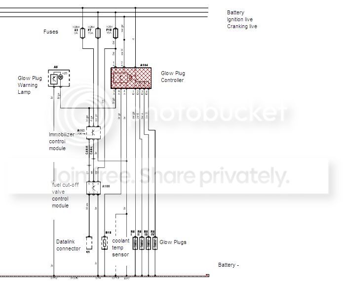

do you want a glow plug wiring diagram for your sprinter pal?
Yes Please!!!!!!!!!!!!!!!!!!!

Old Feb 16, 2008 | 08:26 PM
