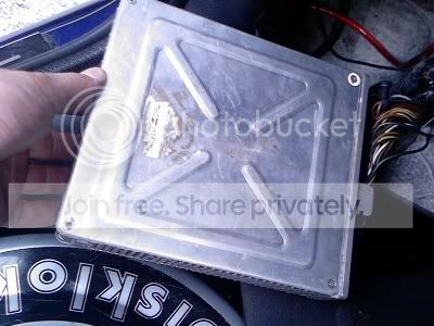

if youve got it out the car already, pop up a pic.
it may help people to distinguish what you have got and solve your problem.
could be anything from the ecu itself or maybe even a pectel board inside dependant on what the car has had modified in the past.

im guessing your not on pectel management by your posts. ie T6 or T2 etc.
if its just a P8 (which a pic may help to prove what your on!?) then people may be able to help you alot better on here!

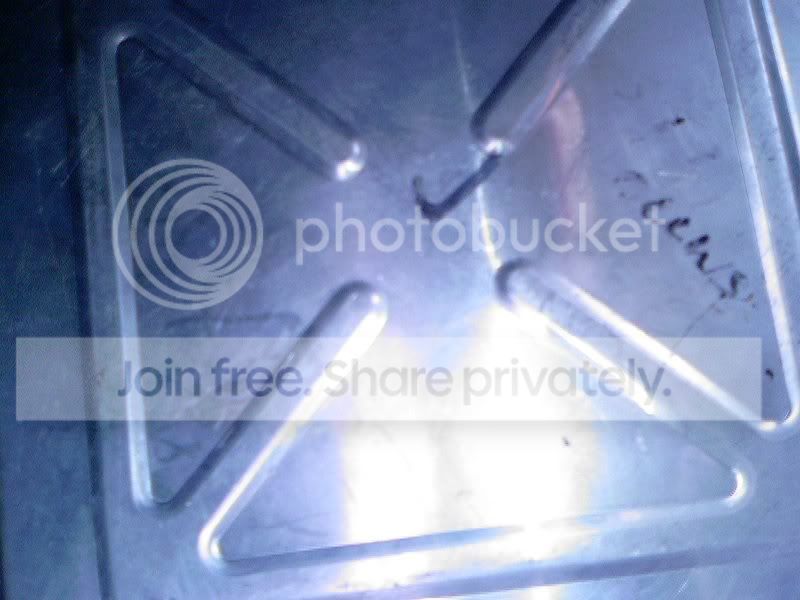

Kelv what do you want a pic of mate and i'll go take it do you want one of the actual ecu? It says sti collins in marker if this is any help

if you could mate that would be handy!

any good

its a standard ecu running pectel software and a small pectel baby board inside!
take the car to a good cossie tuner and he will be able to sort it for you
