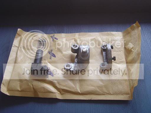

My engine came with a T6 crank pulley attached, which i changed for a standard 2wd pulley.
The crank sensor bracket had to be modified to so would pickup when the T6 pulley was on, anyway i brought another bracket but i can't see how my original sensor can be used
Pic show, the sensor, modded bracket in the middle and new bracket, any ideas?

Thats not an original crank sensor, get yourself a new one from Ford and you will see straight away how it fits up Im sure

you need to buy a standard crank sensor from any cossie up too a large turbo escort
it is a original sensor,,, but its from a smal turbo escort
