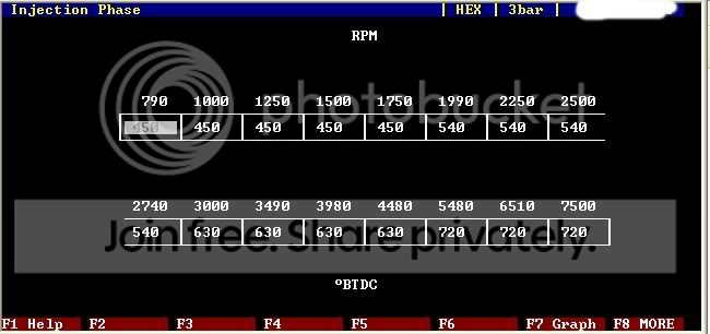

Old Apr 3, 2006 | 03:39 PM

Gareth, I am using the Secs S8, and I am not sure that I can change the firing angle, though I am not sure.
you cant mate,,, its set on a s8,,, simon could change it for you if you wanted him too
