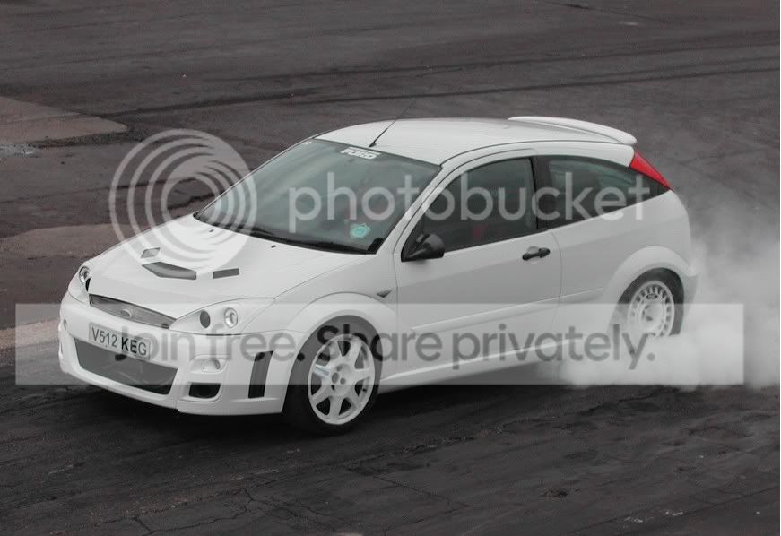

This is A1 Rallysports RWD YB powered focus in action (500plus BHP)
A wicked car RIP

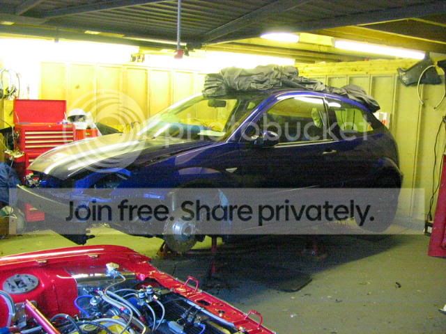

Have a look at this... a few pics of Charlie Shaws Focus (that Andy built), i have a few build pics of it as well if you want to see them.
http://www.ayrshore.com/features/foc...ocuscossie.htm

Paul post some build pics of Charlies car.
