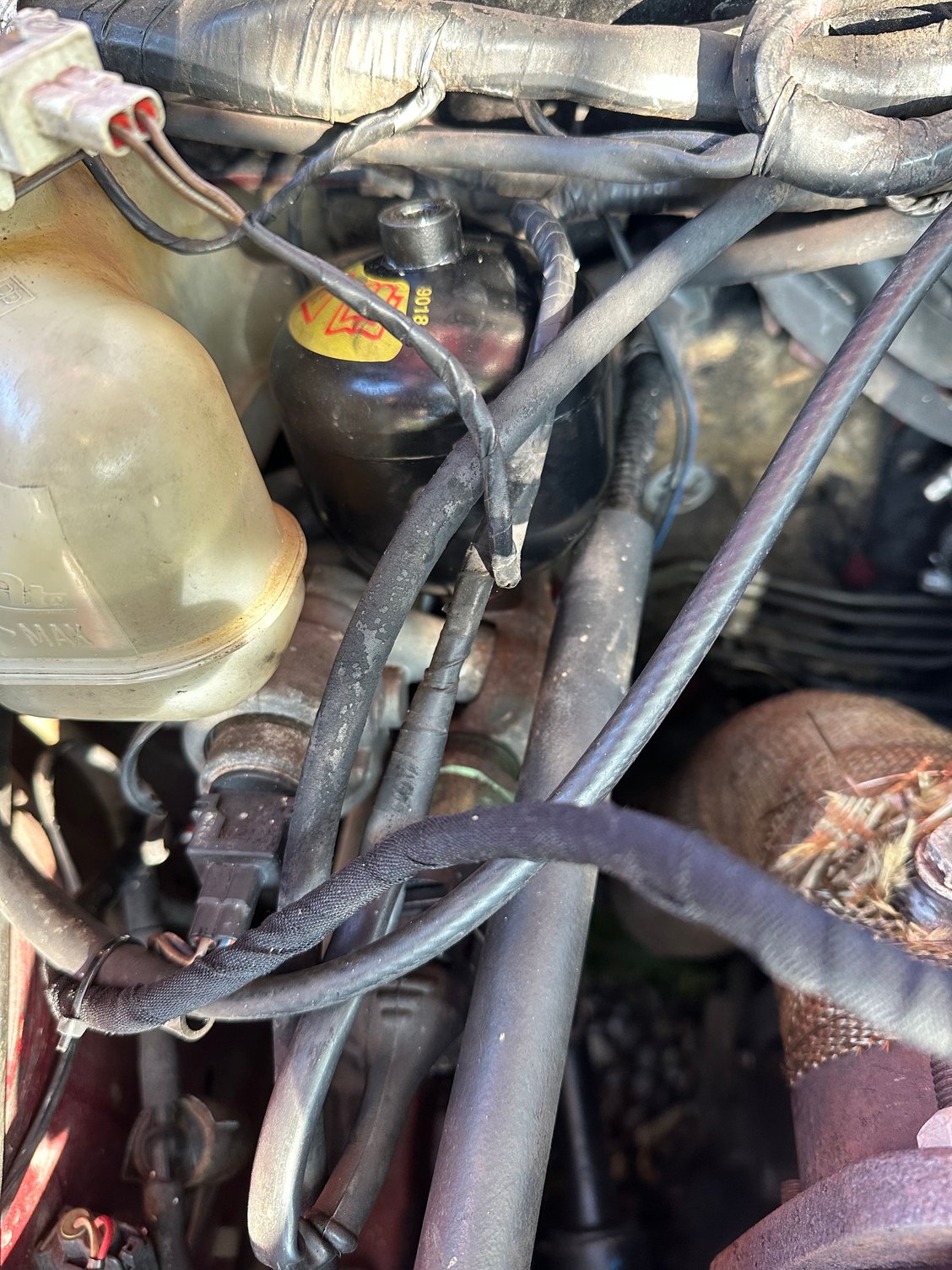

it’s not the accumulator as I had it swapped for a NOS item and all brakes bled. and the pump is working.

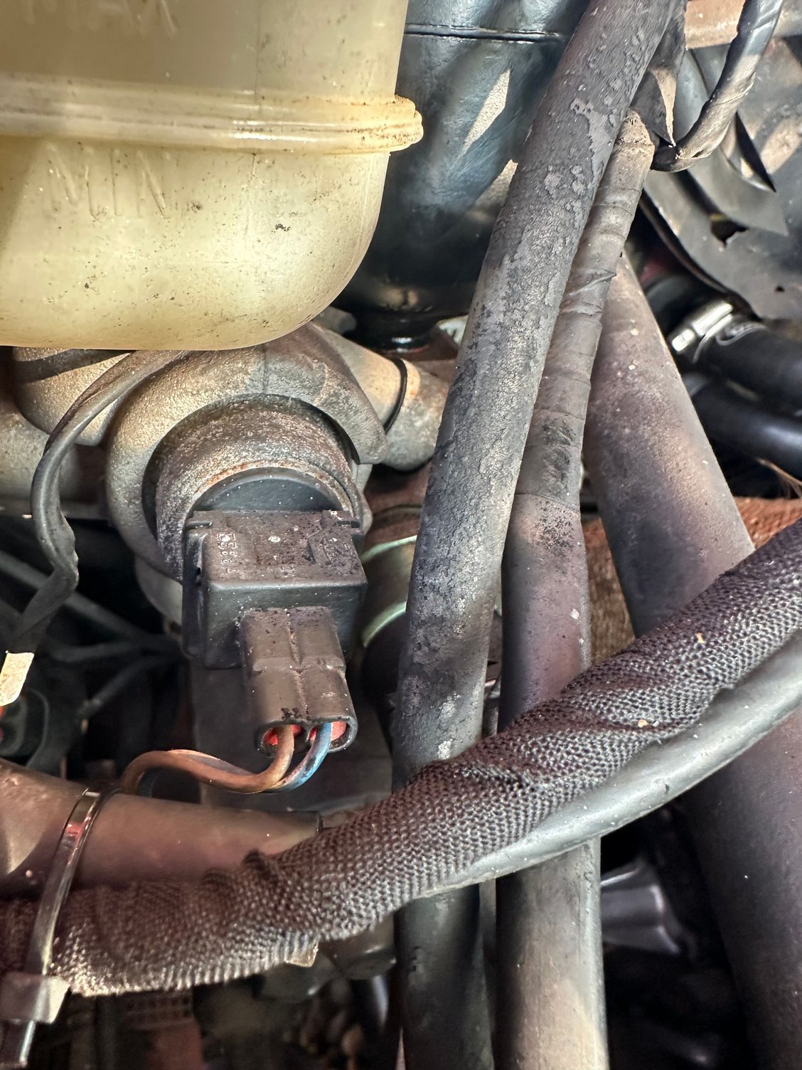

there seem to be 2 different plugs on the front of the ABS unit , can anyone confirm which one is which and does what? I have a feeling the one with a green body is the pressure sensor, but not sure. No idea what the top one is or actually how to remove it.

The green one is the pressure switch, notoriously hard to get a hold of but old Range rovers also use the same one.

Ok thanks rog for confirming!

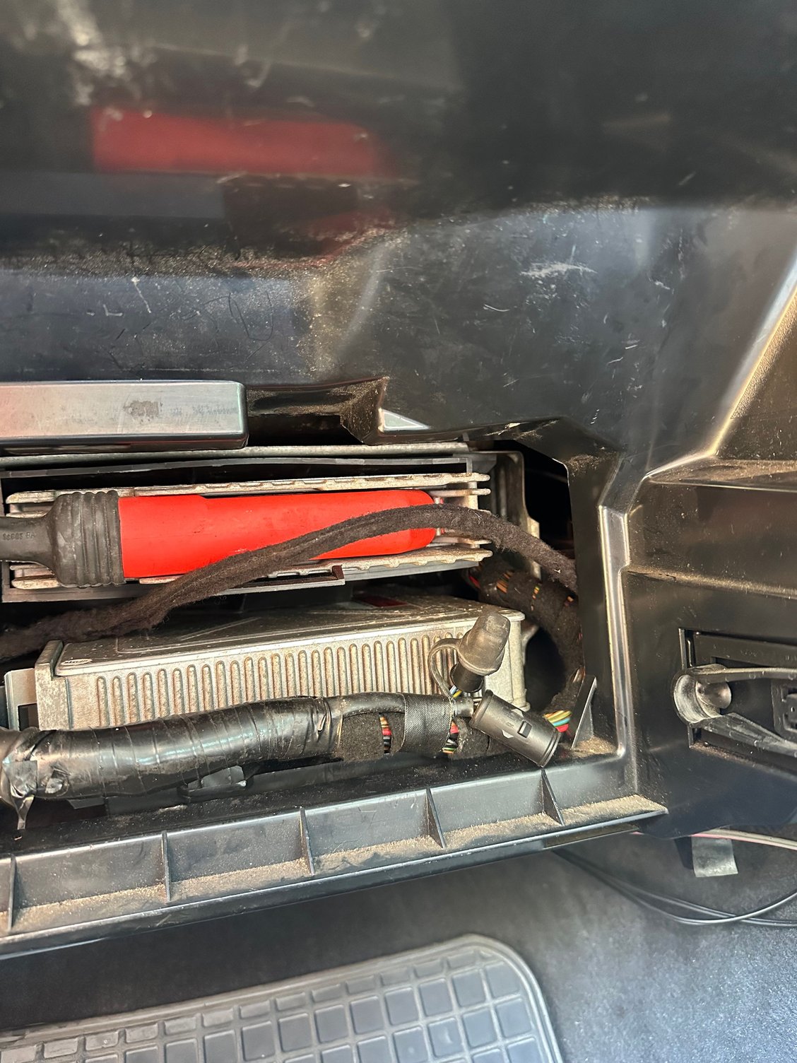

I’m looking in the Sierra manual p106 fuses/relays, it says there’s also an auxiliary fuse box under the glove compartment. Apparently this has 2 more relays and fuses for the ABS.
I took off the glove box lid but all I see is the ECU. No relays or fuses! I double checked on my XR 4x4 with the same system and none either.
surely I don’t need to take the whole dash off just to change a fuse or relay? I just can’t see where it is! Help most appreciated!!

On my LHD Sierra they are in between the computers and the heater matrix. But maybe on an RHD car they are to the outside of the computers? They should definitely be there somewhere.

Did you need to drop the lower dash? Was it easy? Cheers

But when I eventually found the auxiliary fuses and relays, I saw the first yellow relay’s piggy back fuse had blown. Once replaced, her ABS started working! Cheers 🍻
