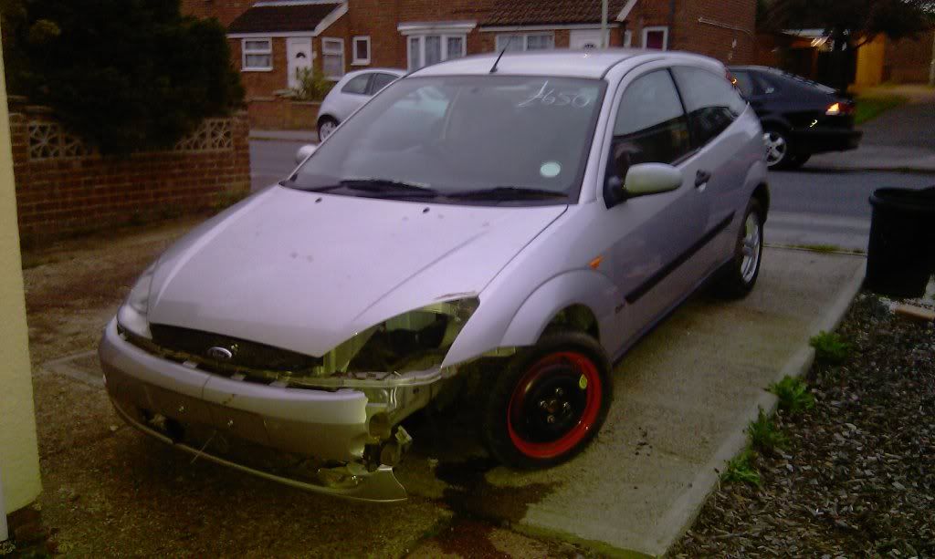

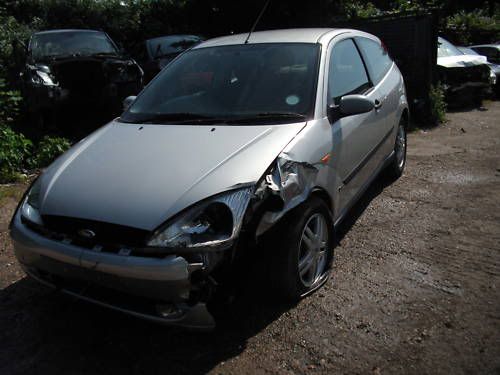

ok, recently bought a newer ford (other one is a mk1 escort) has a little ding but was otherwise very clean and dirt cheap
however, since it was delivered have not got it started, first off batt was dead (properly dead not even the clock light up) so i swapped batt for the one from the escort, everything light up, and the engine cranked over but still didnt start
read up and found that there is a fuel cut off switch in the drivers side foot pannel, tried to press that and seemed already pressed
also i cant hear any pump, should i be able to?
any help mucho appreciated
heres a pic (or 2) including my mk1
with a £12.50 wing later
and here is my mk1 at bromley pageant
thanks
Ian

bet when you get that diving your gonna find suspension damage!

thanks phil, yes it has got a bent bottom wishbone, everything else looks ok though, think the tyre beared most of the brunt
