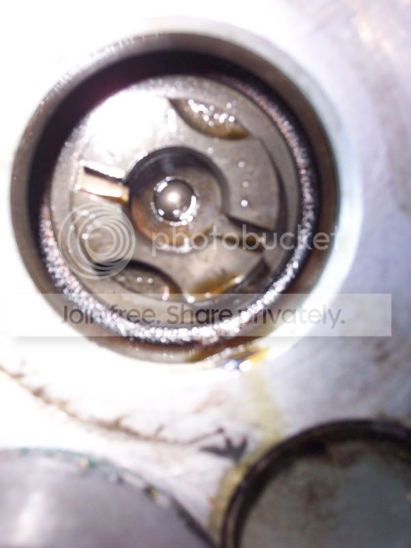

Well looked in the end today and the ball bearing is there....
Any other ideas anyone?
cheers
Danny

it looks like it is leaking tho fella have you looked in the dizzy the side that goes onto the cam is thier a bearing in this to

It looks like it's leaking from the cam - fault with cam really. You could the oil away so it's nice and dry, then apply some RTV silicone, which will probably cure it.

why spend your money when you dont have to mate clean the cam and bearing up push the bearing in slightly and put a few blobs of rtv then release the bearing hey presto you will then have a perfect seal around the bearing
