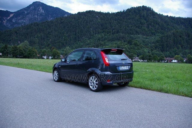

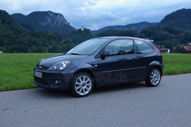

My ST had 6,5x16 ET52,5 with 195/45R16 rubber (factory standard in GER). Well... looks like a tractor.
Now it's lowered with 30 mm Eibach springs and looks much better with the 7x16 ET35 RS 7-spokes. Still standard 195 tyres, no rubbing.
