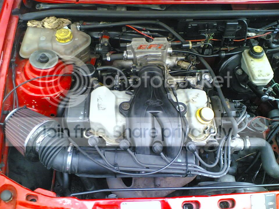

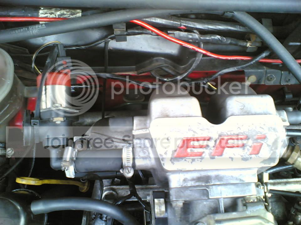

no i think you still have the idle valve there but you are looking at it properly. Look at the inlet manifold where it says "EFI" then to the left of that there should be the idle valve that looks like a tube with a blue sticker on it. I had a orion efi with a fast road cam and it always idled rough but shouldnt cut out though. Maybe you could take a pic of your engine bay and we might be able to point it out for you
does this help?

i have arrowed it but perhaps you should try cleaning inlet manifold first. To clean the idle valve you need to take the 2 screws off that hold it together but be careful not to tear the gasket apart as i dont think they are available anymore so you will have to use the same one and give it a clean out with some carb cleaner.
