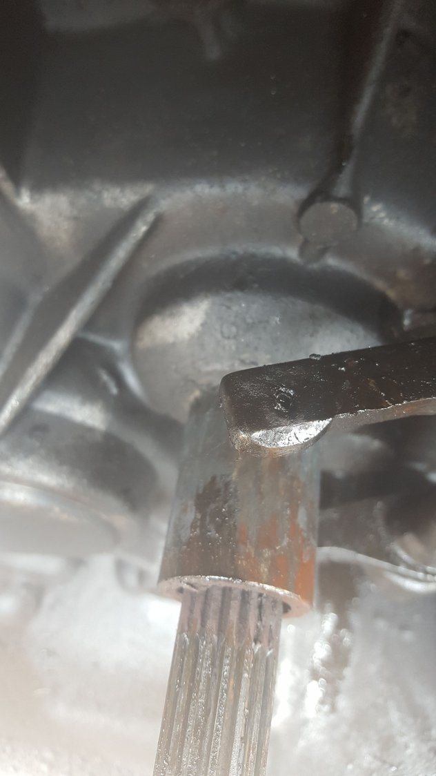

So took the gearbox off and found the problem. There is part of the bearing fork missing that holds the release bearing in place so looks like someone has bodged it at some point in its life! FUCK! 😠
Anyone any idea where I could pick up a release bearing retaining part?!

Post up a pic, it may be that one of us can weld a bit back on. I am on holiday soon but happy to MIG a bit back on if we can work out what needs doing. If you are quick you can get it here for Fri / Sat and I can post I back next day.
Make it easy for me, take a pic of yours and google an image of what it should look like and then I can tell you if it can be done

I had the gearbox off by 1 o'clock and would have had it back together by afternoon so I'm a bit p'd off that now I'm held up. I hate when people bodge things like this which are obviously important!
The part missing itself is quite a substantial part that's bolted in place so I don't think a weld will do it but you know better than me so have a look at the photos and see what you think.
Also I think there should be a pin of some sort holding it at the top. As you can see in one of the pics it looks like it snapped

Sadly I think you need to call all the breakers and get that bit...sorry

Just been googling images of escort mk4 gearboxes and none of them have a retaining part on the release bearing. But how does it keep it in place? And why does my haynes manual say there should be one?

The release bearing has a slot for the pin which is located in the clutch fork. Yours appears to have snapped.
