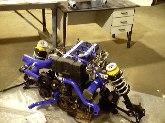

hi, hopefully someone knows this off the top of their heads, can the 2wd cosworth engine use the late 4x4 pulleys? I have heard the crank shaft ends are different, but also i wonder about the 2wd lower radiator hose routing. My reason for asking is, 12 years ago i added aircon and made some custom brackets to do this, ie ps and alt on left and ac on the right, but, i'd like to run the proper brackets for the factory look

Yeah the later pulleys can be fitted as I've just done it to mine. I wanted the multi grove belt rather then the old V belt. I had to make a lower pick up bracket and water pump pulley needed modifying. I used the 4x4 alternator on a drop bracket and left the power steering pulley at the min till I can make / modify one to run of one multi grove belt . Hope this helps
