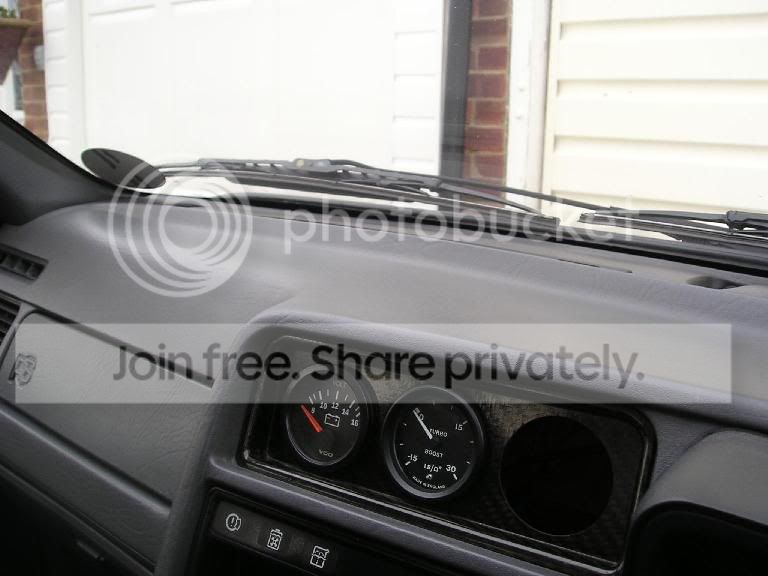

Does anyone know for sure if the dash for a late type sierra rs cosworth will fit in a 3 door?

yes it will

The one in mines of a h/j plate. You will have to get the a-pillars aswell but only one hole in each one lines up so you'll have to drill new holes in the metal. Looks better imo without the centre grill
