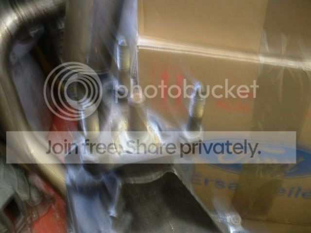

yeah the Late sapphires and escort cosworths had a different output shaft in the gearbox see pictures:
the best advise is to get the propshaft end to go with the box your fitting then its just a easy job other wise you have to take the transer off and swap the output shaft.

cheers m8 but mine is a 4x4 mt75 from a sierra cosworth its a G reg, i been told mine is a very early for G reg ,but wat really is the problem is that know its all fitted ,but wen u press the clutch pedal rite down it makes a loud sqeaking sound metalicy but all gear go in ,know if i dont go all the way down it does not make the noise and the gears go in fine say the pedal is about just under 1 inch from the floor ,if you no wat i mean ,also would changing a same gearbox for a nother 1 do that cheers

it must have had a box change before in its time. Do you need the longer output shaft or the shorter? You have definatly got a box from a cosworth because the 2.0 DOHC boxes look the same but clutch pivot & things are different and you could get that noise from that.
