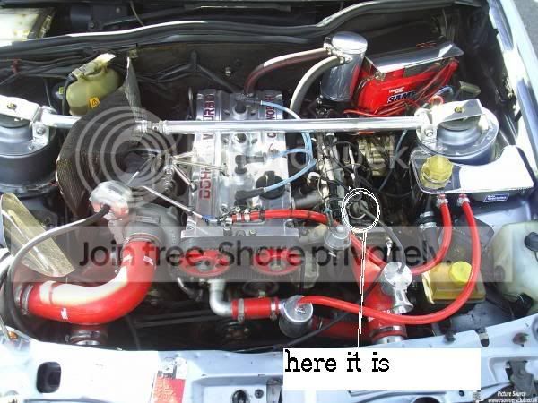

Stupid question i know, but can anyone tell me where abouts the little bugger is on a saff 4x4 cossie?
Mines idling at 2 ta 3k an its gettin on me nerves, its in the garage an ive got no lights so got to go round with a torch to get it off, would be handy ta know where im lookin before i get there !!!

It's bolted to the throttle body.

Yeh if u look at the top of ur throttle body is is sat on the top ,it sud have a 2pin plug on top of the idle speed control valve. There sud b 2x screws holding it in remove the sleeve and give the iscv a good pull.It might b tight 2 come out.
