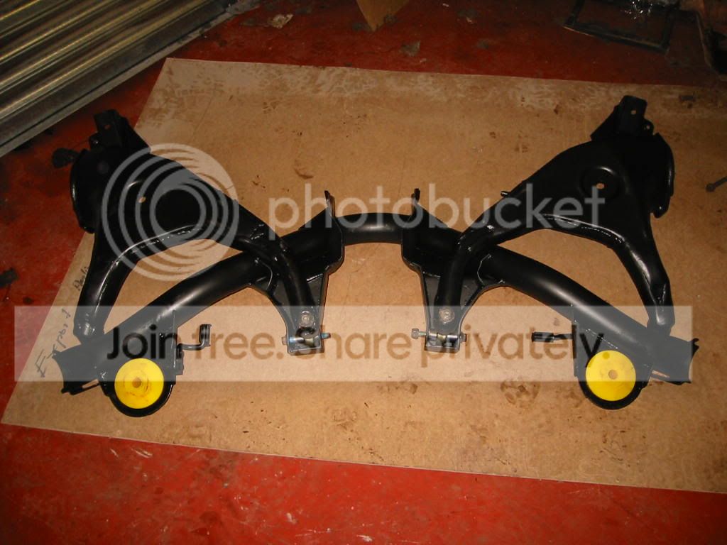

As has been stated the rear suspension geometry is a long way from optimum. The standard setup suffers from a huge amount of camber change and bump steer (toe change) when the rear wheels move up and down. This basically results in the rear wheels steering slightly in the same direction as the fronts when you turn a corner. The result is understeer. Plus when a cossie launches the back drops and the car pulls away with only the inside edges of the tyres on the tarmac.
Our beam has completly revised pickup points that eradicate these problems.
Both the inner and outer joints are fully adjustable and rose jointed. We use the rose joints from a NASCAR, so they are big and bloody strong. As has been covered above, if a good quality joint is used (with or without boots) they will last for years. I have run a completely rose jointed front end for over two years and 10,000 miles with absolutly no wear in the joints what so ever and I did not bother with the boots. We do however supply boots with our rear beams if you require them and they are a worth while procortion. Hiwever if you don't look after the boots, water gets in and is held against the joint and the result is obviously corrosion. This doesn't happen with out the boots as the joint has a better chance to dry out.

The zoo Beam
PJay

Superb Sean about time this problem was looked into, looks great, i will get saving!

We have some better more detailed pictures coming out soon that we had taken by a propper photographer. But I guess you get the jist from the picture above of the half put together mock up beam in the pic.
