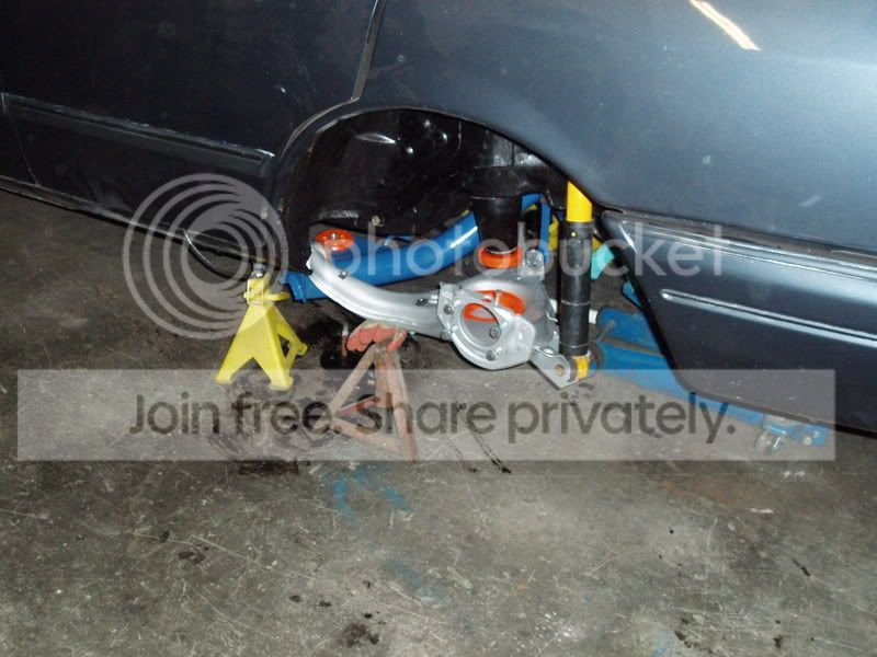

But,I think they go between the plate that you bolt up to chassis and beam.
If you look at the shaped/cut out shape on the bush pictured above it matches the raised part of the plate that bolts upto beam
Heres mine:
Old Oct 26, 2006 | 08:33 PM
Chris and Dawn's Avatar
Chris and Dawn
Posts: 151
From: Lancaster
Yeh thats how i fitted mine.

Have you just put the larger bush in on its own?
Old Oct 26, 2006 | 10:14 PM
rsvan's Avatar
rsvan
Joined: Apr 2006
Posts: 987
From: home
ye, took it for a drive and it was shuddering at 80
Old Oct 26, 2006 | 10:19 PM
Chris and Dawn
Posts: 151
From: Lancaster
The long 19mm bolt won't pull the beam tight without the small bush in place.
Chris

Originally Posted by CosKev3
Heres mine:
Mine are fitted up the same as Coskev3 I figured that the extra bush acts a bit like the old alloy supports you could buy to try and calm down the beams antics of bouncing all over the place under hard acceleration...so I fitted them in the same way.

Originally Posted by RS beddy
i though they where off the bump stops on the cones that the springs sit around that is where mine went. when i got the full back end kit
Are you running the car with the bushes fitted like that?????
Hope you didn't leave the spring bushes in the trailing arms like on the pic!!!!!!!!!
Positive the way mine are fitted is right
Mainly cause of the shaped bit cut out where the plate sits

Originally Posted by cos jon
Does anyone know how these should be fitted as Deflex told me that the extra bush sits on the top of the beam mounted bush not below !!
Pretty sure mine are right
The bush is shaped the same as the plate that bolts the beam up,so looks obvious to me
Also there are raised round bumps on the top of the main beam bush,which IMO go up against the chassis
Look how the original bushes are fitted,the biggest part of the bush is at the bottom of the beam,so thats how the Deflex ones should be IMO
