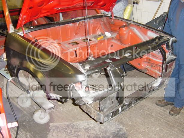

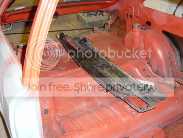

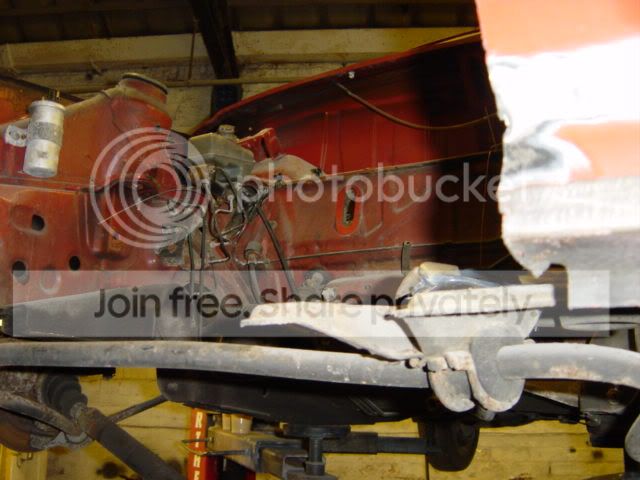

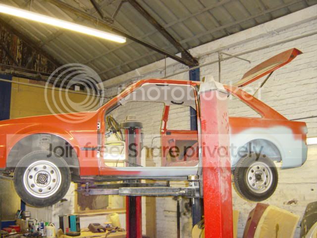

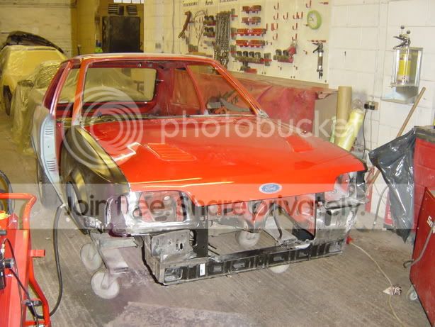

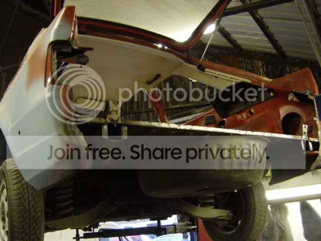

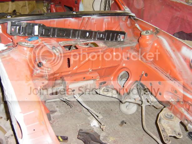

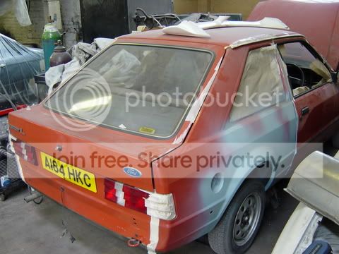

I trusted the job of fitting the new panels to the local bodyshop who owned the car before me. For anyone attempting to do this there are many good reasons why not to try it! The following panels were changed for ford items:- bonnet, wings, crossmember, scuttle, rear panel between the rear lights, tailgate, all front suspension, front panel.

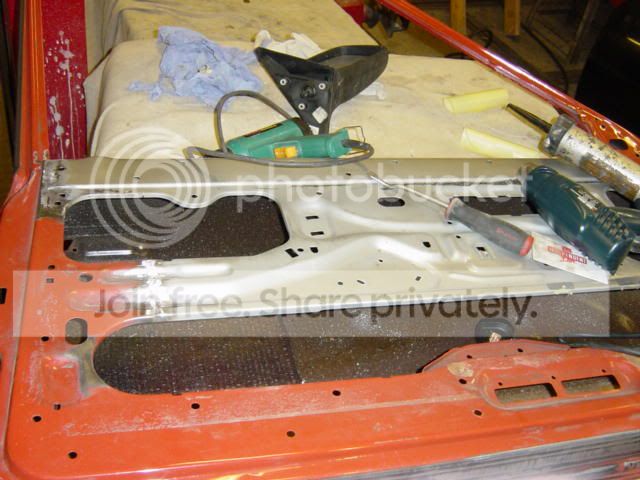

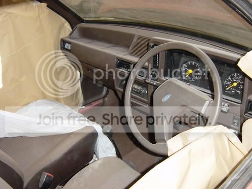

To top it all off the bulkhead is different where the steering column mounts. Also the bloody doors inside needed modifying to accept the Mk4 90 spec trim.

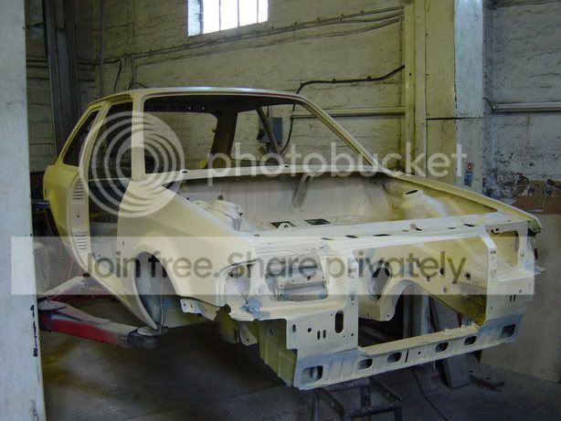

The bodyshop fitted the panels as shown

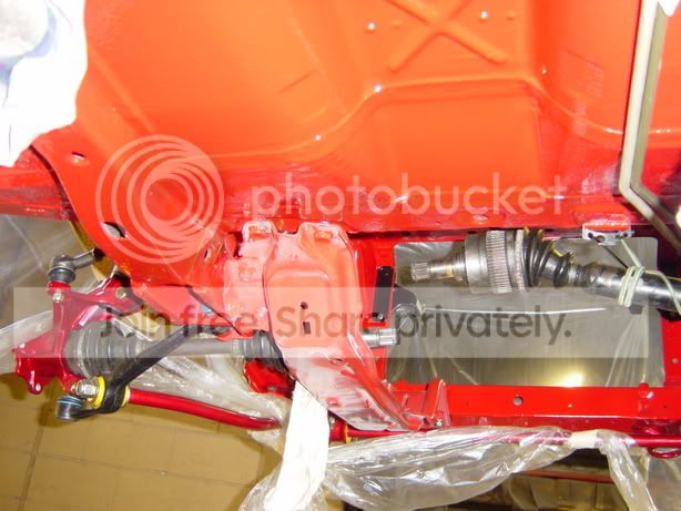

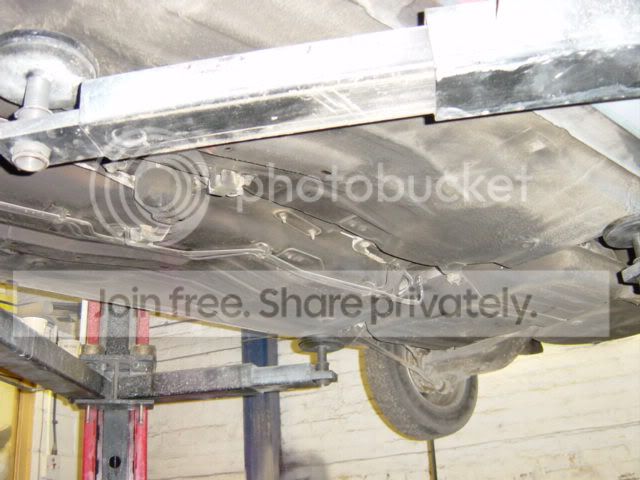

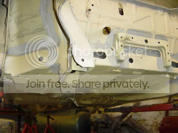

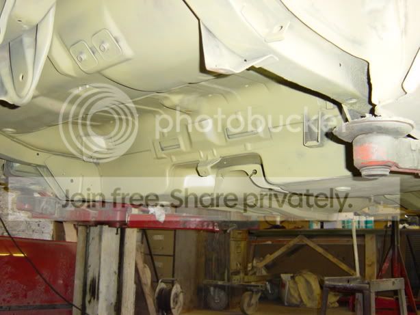

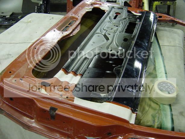

Check out the underneath, loads of waxoil!

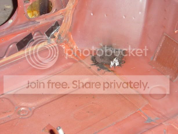

Spent hours using a zip wheel to clean off the wax and underseal right down to shiny metal. Only a tiny amount of welding was need ed as shown in the photo of the passenger floor.

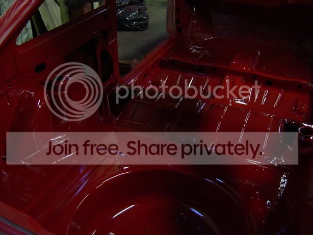

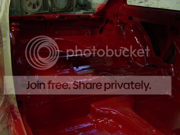

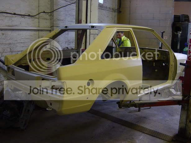

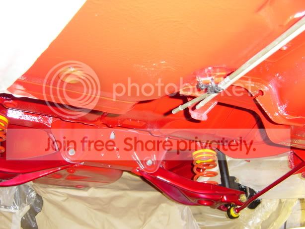

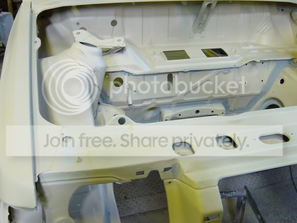

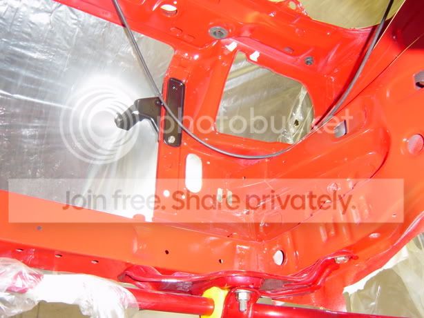

The painter the degreased the underside and applied acid etch primer then stonechip and primed the car as shown below.
Then repainted the car using the latest ford red called colarado.
MORE TO COME!

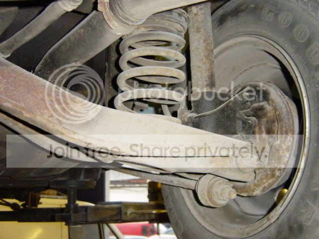

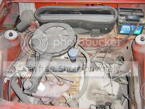

Some more pics.
carnt wait to drive it. Luckily i have another Mk4 cabrio with a zetec 2.0 mondeo engine to use until its finished tho. Easy job installing the zetec engine in that, a weekend is all u need!! dead quick and rattle free, unlike that dirty cvh. More pics coming. Sorry to all the mk3 lovers out there.

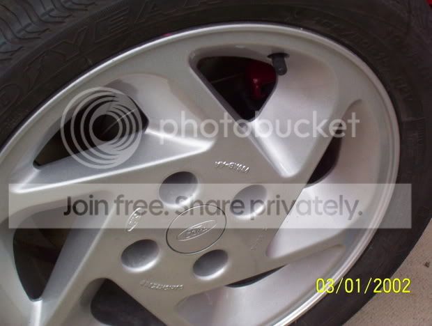

Does anyone know if Escort Cos wheels will fit this car??? Did a swap for the mintest set ever with nearly new tyres the other day. Have also another set of turbo wheels powder coated with new tyres. I love the Cos wheels but i think wheel spacers will be needed. They look loads better than the mondeo/escort smaller copys that are 15s.
Ignore the wrong date on the pic.

Fawdy , ill do u a good deal mate ,
As for Cossy rims , its all in the tyres , i had a set on mune 35mm drop and no arch mods ,
u need 195 45 16 tyres , i hightly recomend Continental , dunlop also do them .

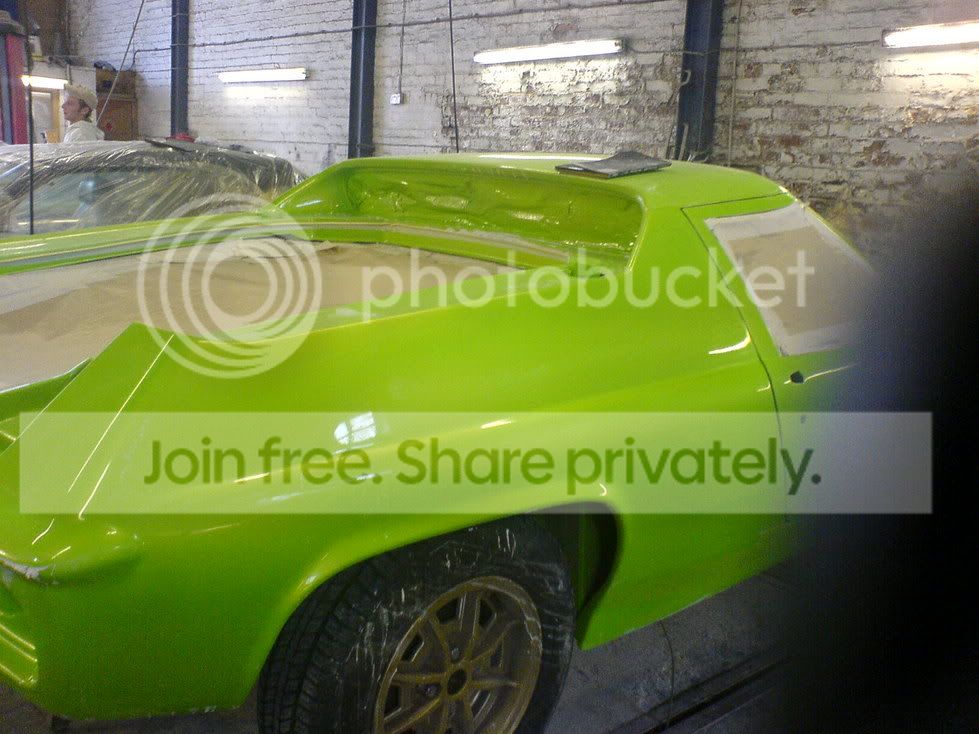

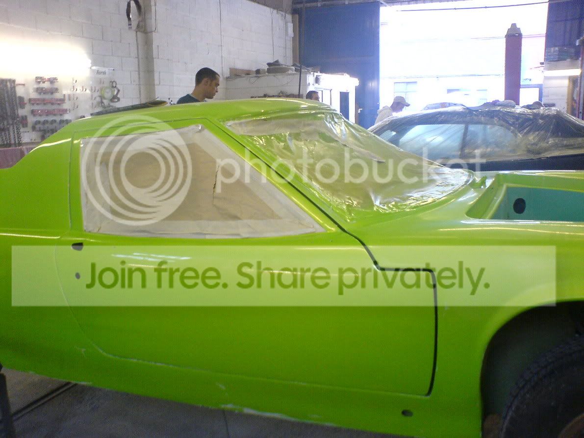

My old boys project i am also doing. Its a 1972 lotus europa. Done at the same garage. Yes its is ment to be lime green, just not metallic as we have done it.
