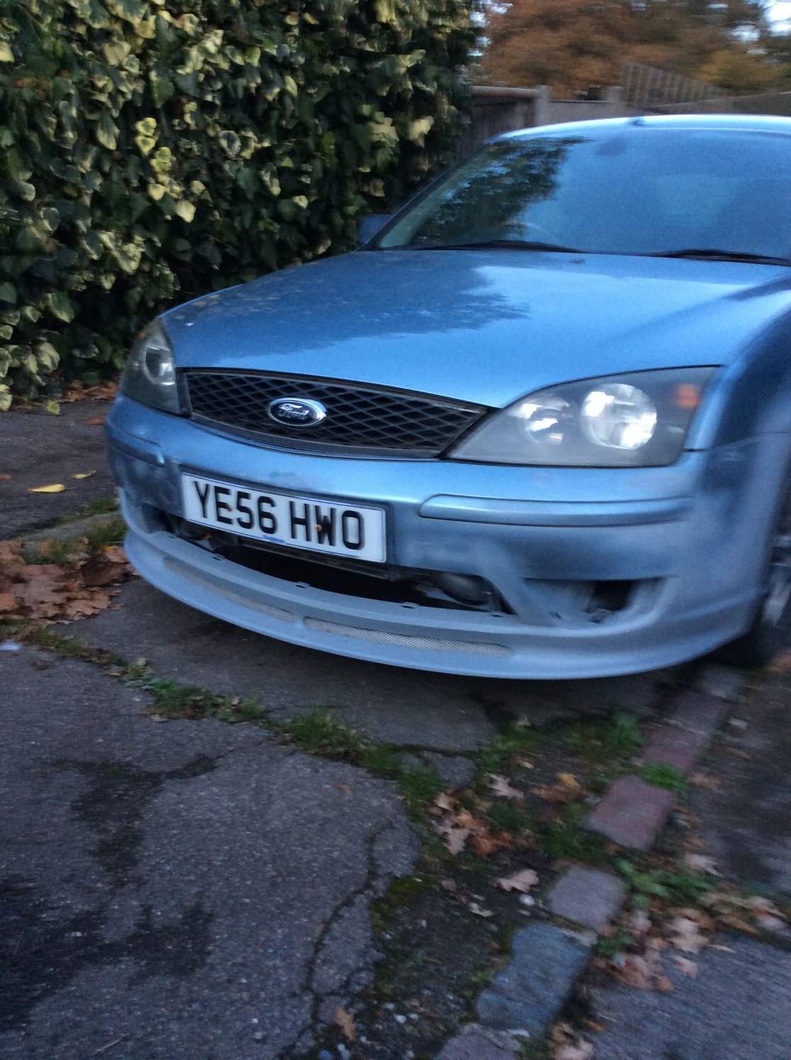

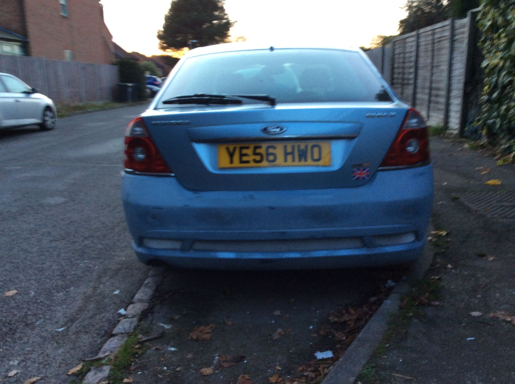

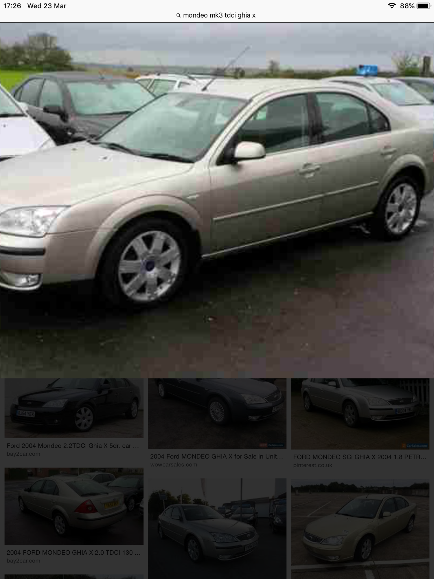

I have a Mondeo MK3 2.2 TDCI Ghia X. It has a lot of extras, but not the ST body kit.
I started about a year ago knowing that the some of the ST panels would not fit, owing to different dimensions and fixings between the two models.
I have had to fabricate these panel because of the differences. For example, the ST wheel arches are wider that the Ghia X.
Below are some examples of what it looked like before and where am now.
The front is ongoing, as is the skirts and rear bumper. The boot lip spoiler is in my kitchen !
