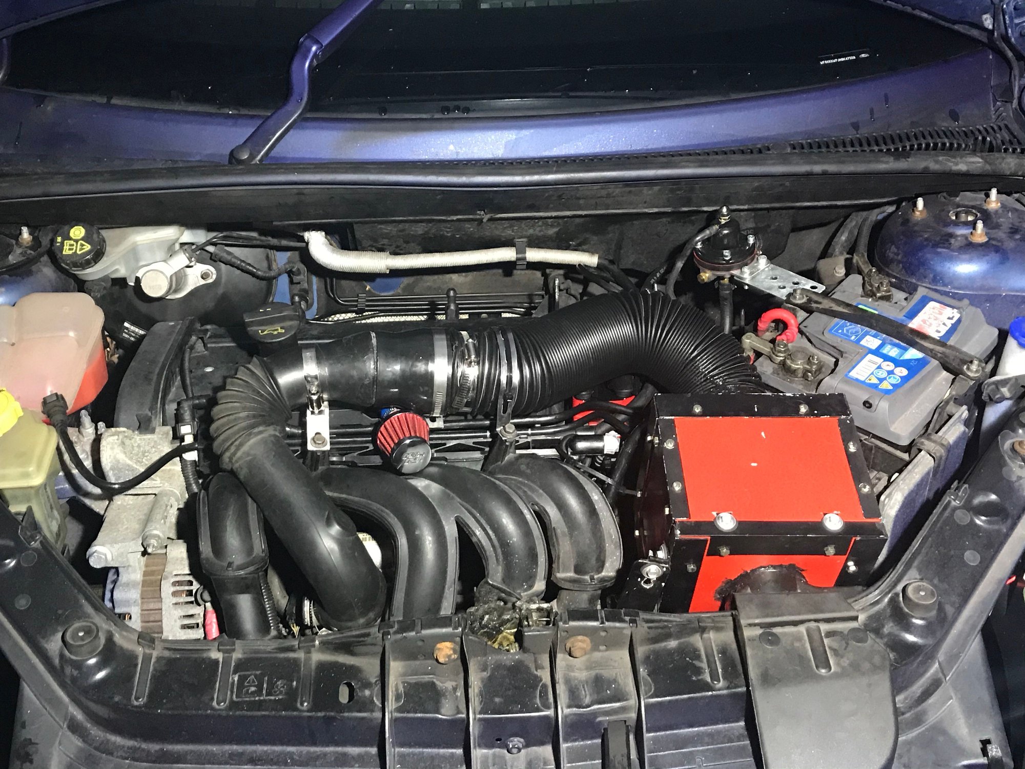

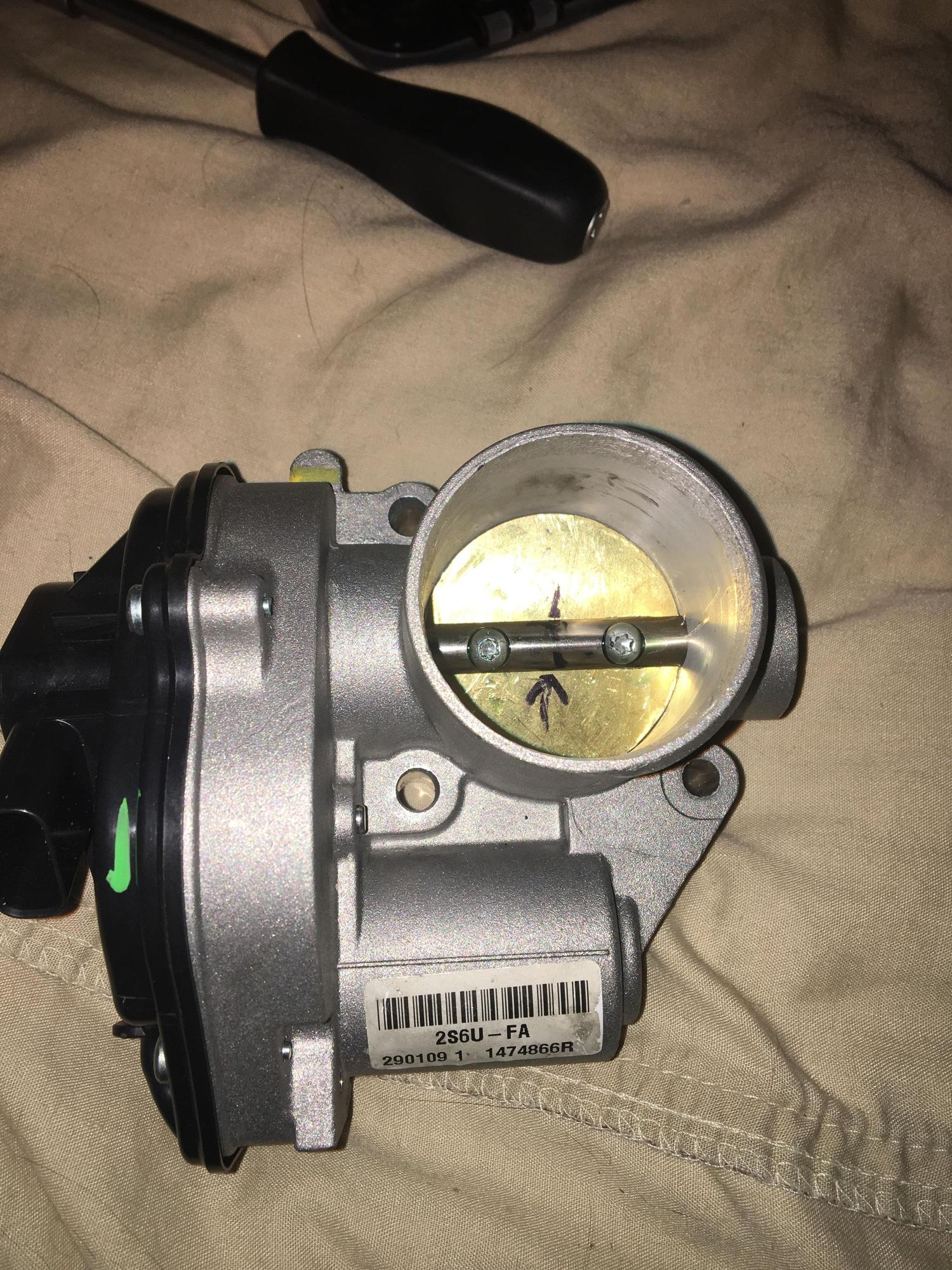

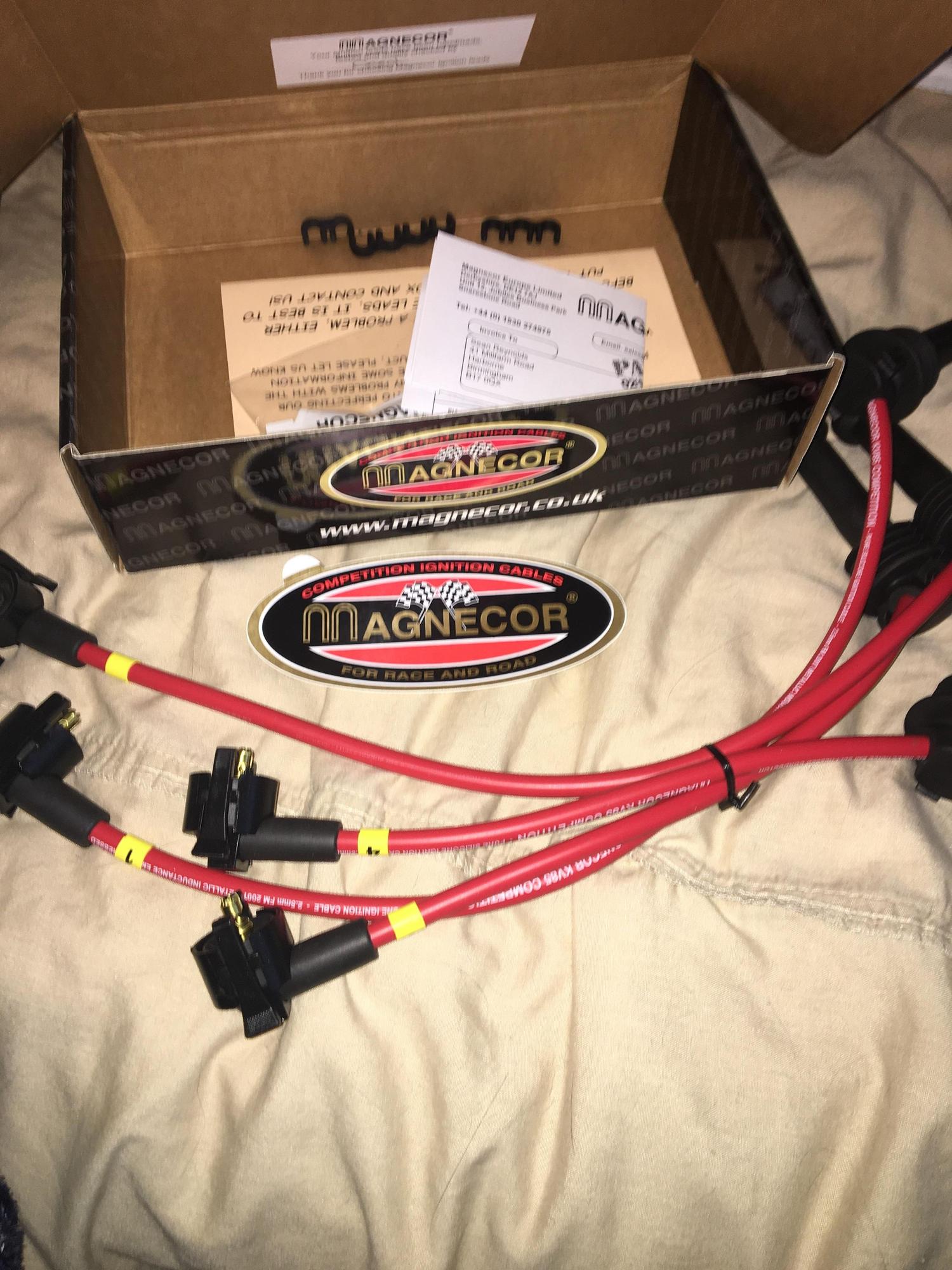

Not so long back I did a small project in making a, totally enclosed, cold air feed box to attach to the original snorkel at the front of the car, with a cone filter inside and 60mm cold air feed leading to the original cold air feed pipe connected to the throttle body that has been bored to 50mm. Ordered in a MSD hyper power blaster coil from pumaspeed, with some custom built Magnacor Kv85 leads to give the ignition system a boost. Adding an aftermarket Malpassi, rising rate, fuel pressure regulator to the fuel rail, has upgraded fuel delivery to the rail, and there is a stainless 200cpi high flow catalyst still to be fitted along with a custom exhaust, cat back system, being built on the car in the future. Have some bonnet vents to add, to aide in heat dissipation when the super charger is being fitted. Will need to fashion a frame or brackets out of the metal flat bars I have here. I have alu, and mild steel but the steel is very thick and weighty, so may buy some more alu. Have a remap on the mind, or a few, maybe a bespoke tune when the supercharger is on would be more suitable.Kent cams may very well be an item to be added in the future but the prices are astronomical just for the parts, and fitment is not something I would be 100% sure of doing myself, and the cost for labour would be in the 100's. The cams would definitely compliment the new sports cat, exhaust system, high flow air intake together with supercharger. I have done all the work on the car myself up to now, except the drive shafts that were fitted new by the local mobile mechanics. I have a drive torque, twin friction, performance clutch to be bolted in when needed, supplied by the lads at larkspeed.

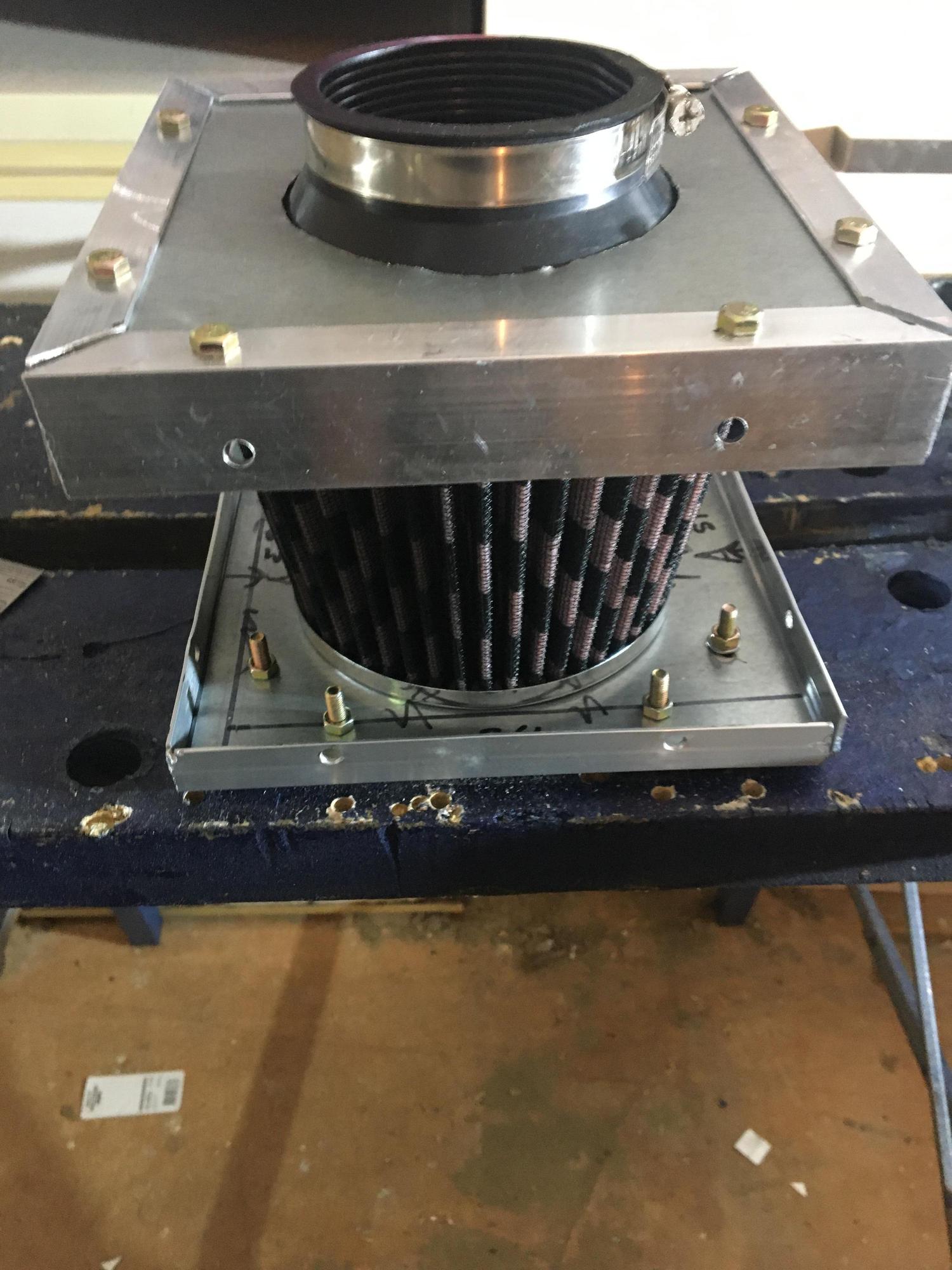

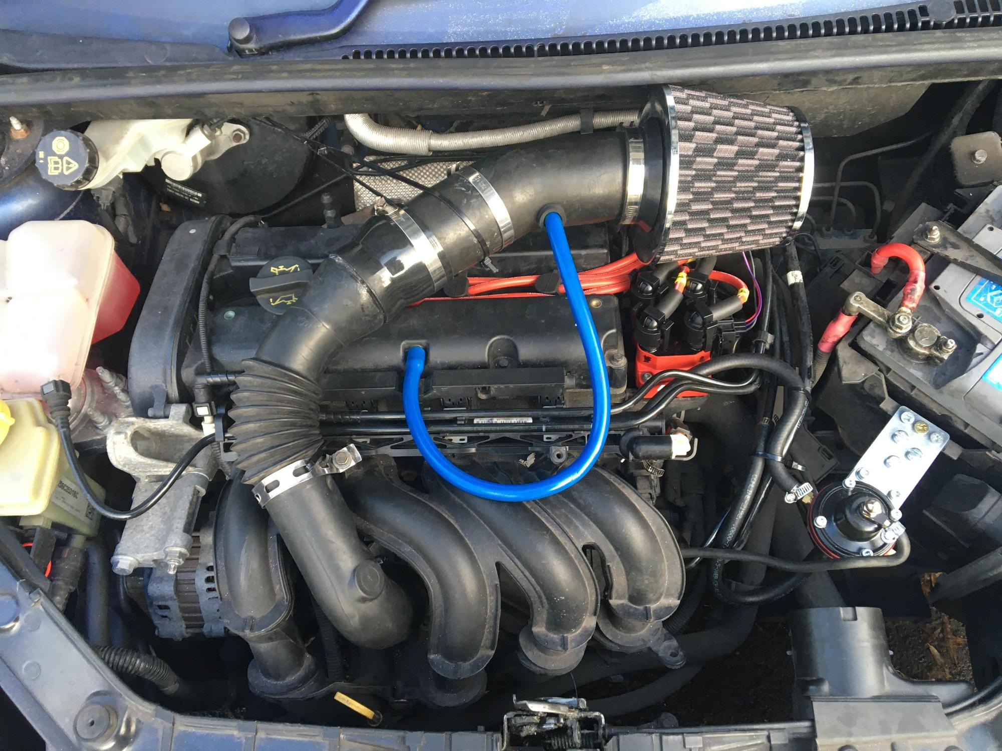

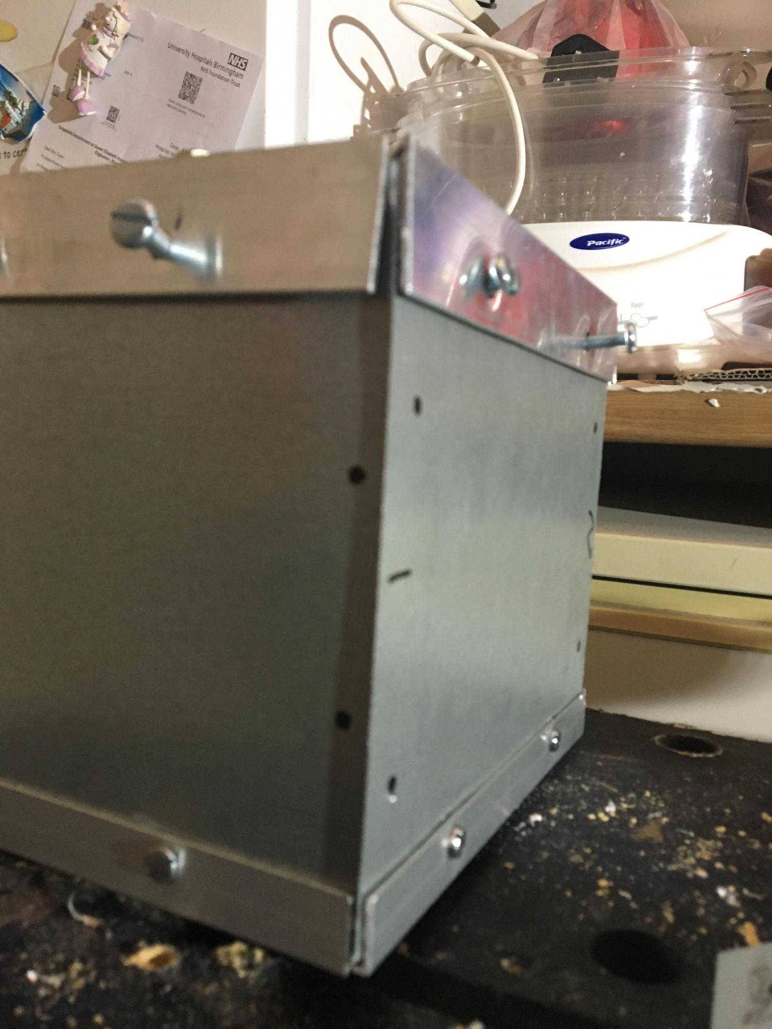

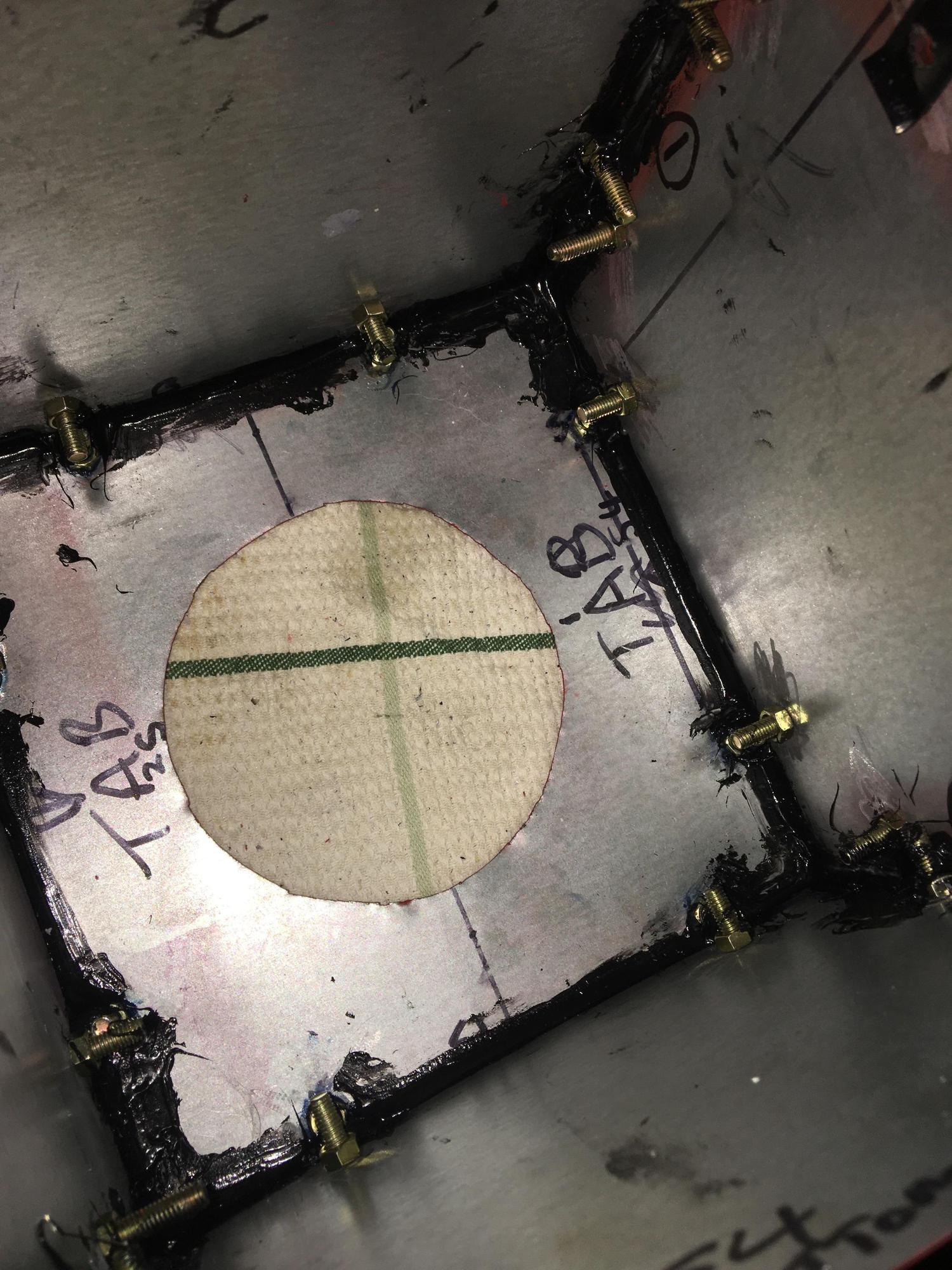

This is the enclosed air box with cone filter. I glued the mk6 fiesta snorkle/air intake tube onto the inlet side of the box to feed into it for the filter to work with.

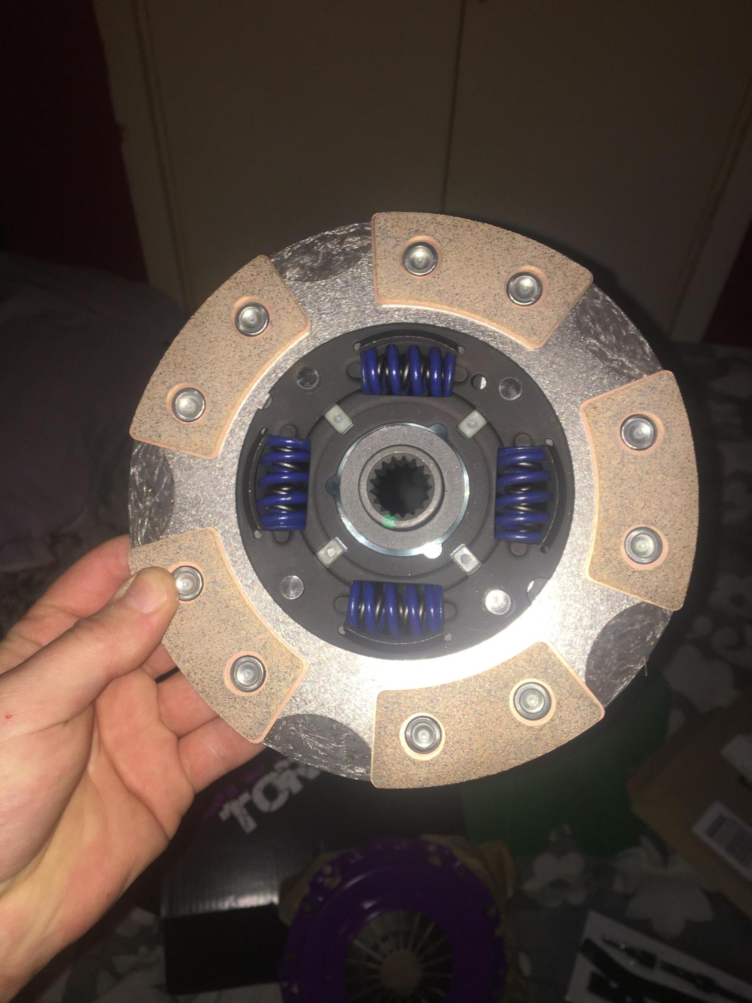

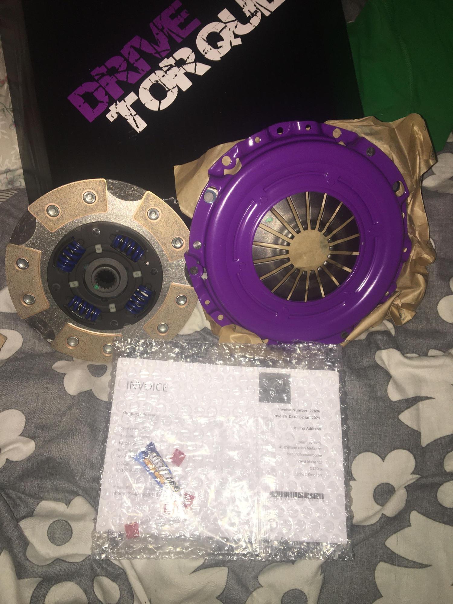

Drive torque dual friction performance clutch.

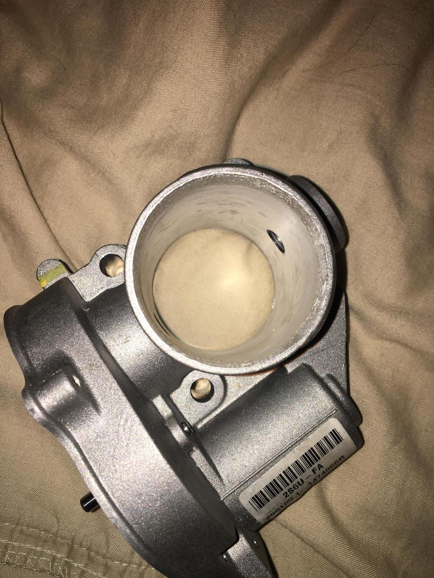

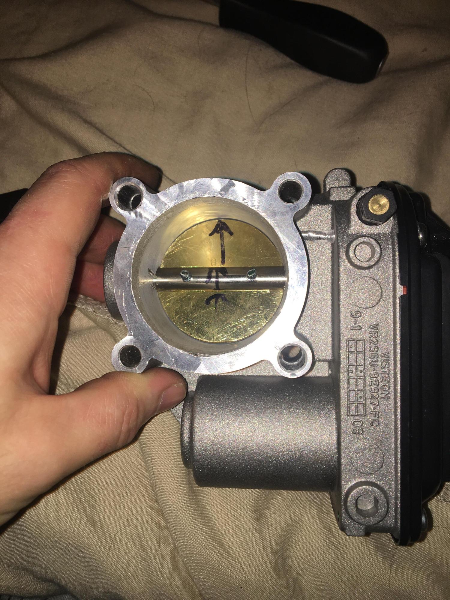

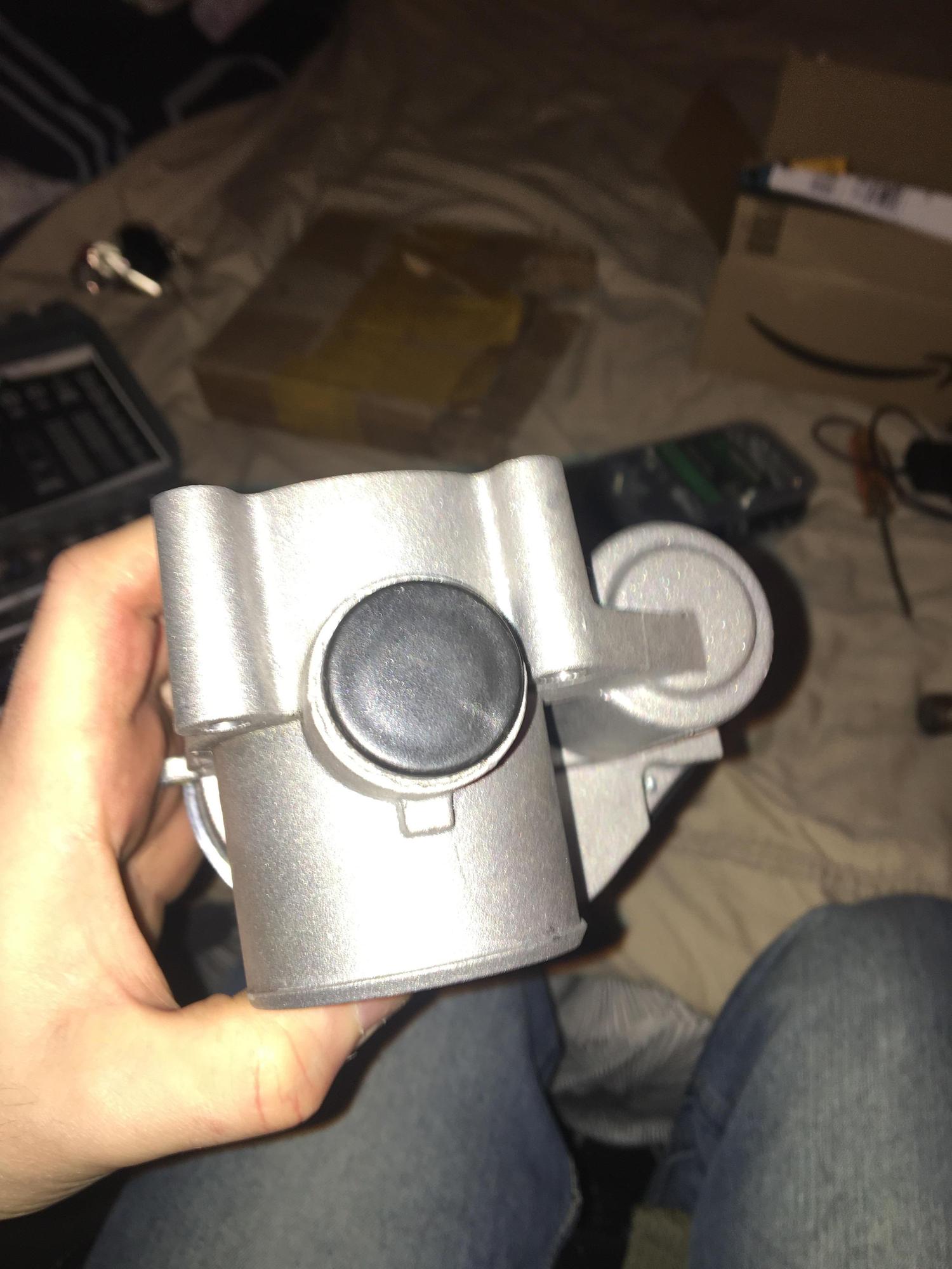

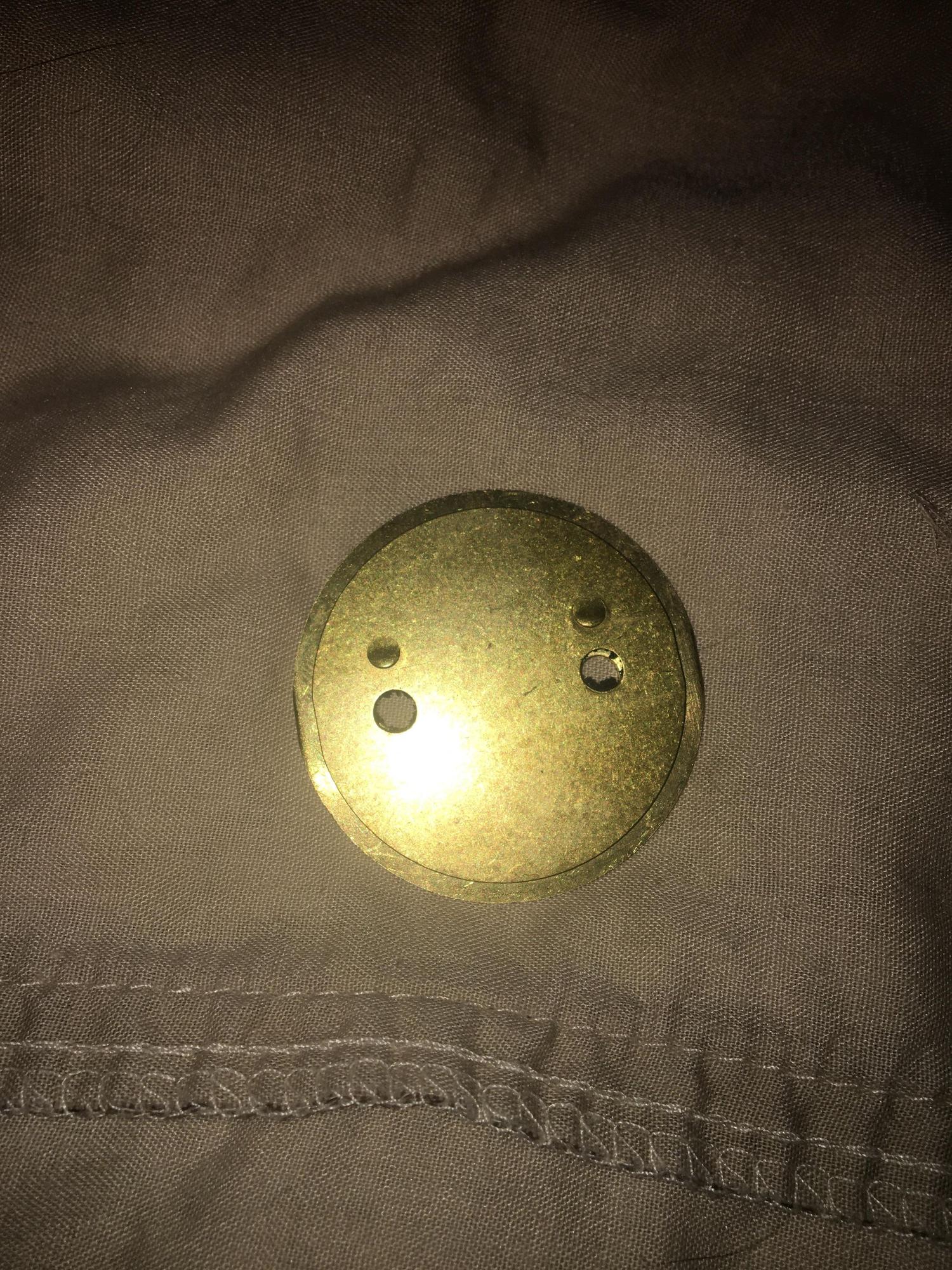

Throttle body conversion. Dismantle, rebore, and rebuild.

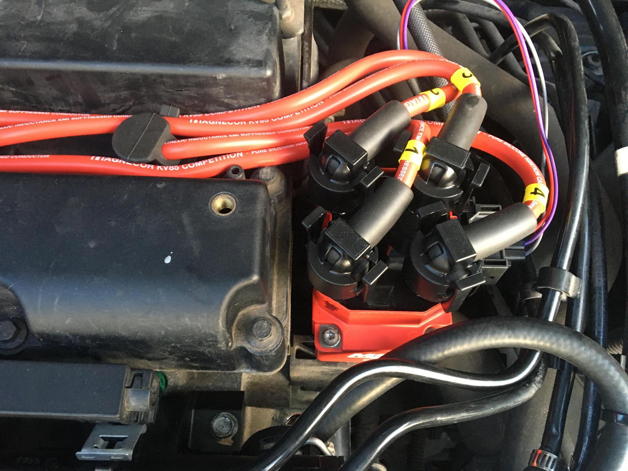

MSD power coil, with replacement custom loom, and custom ignition cables.

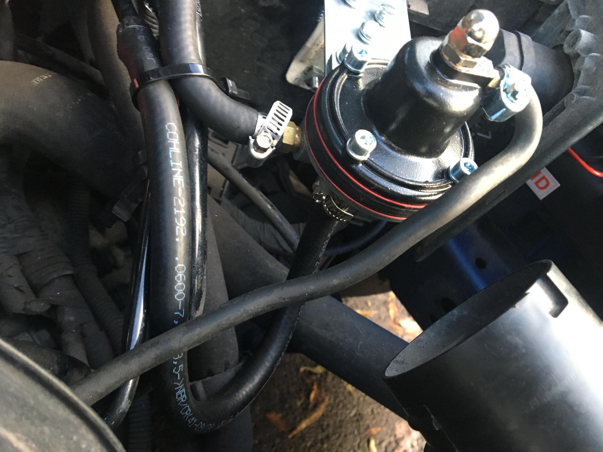

Malpassii fuel pressure regulator.
This is how it used to look before the cold air feed box was installed.
A more up to date photo of the bay, it is a little more organised after this pic was taken.

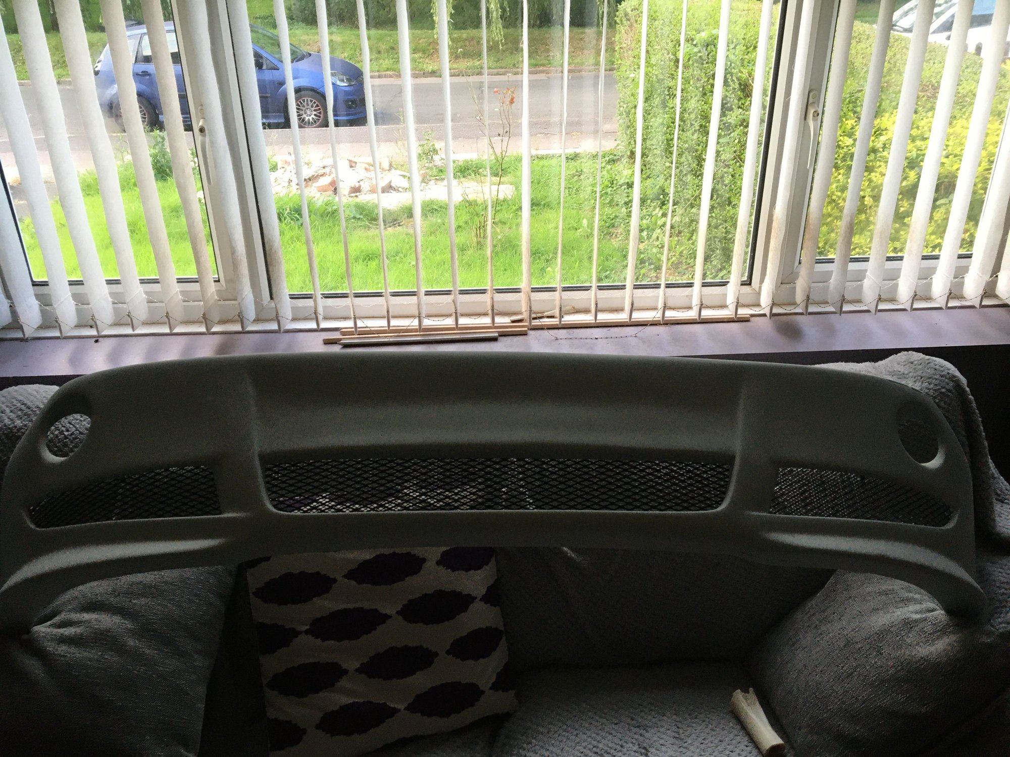

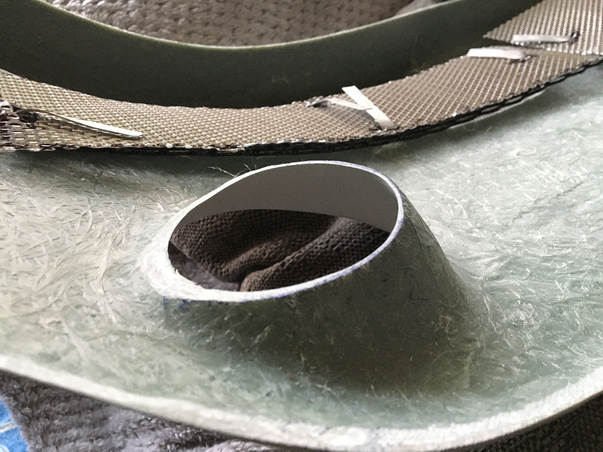

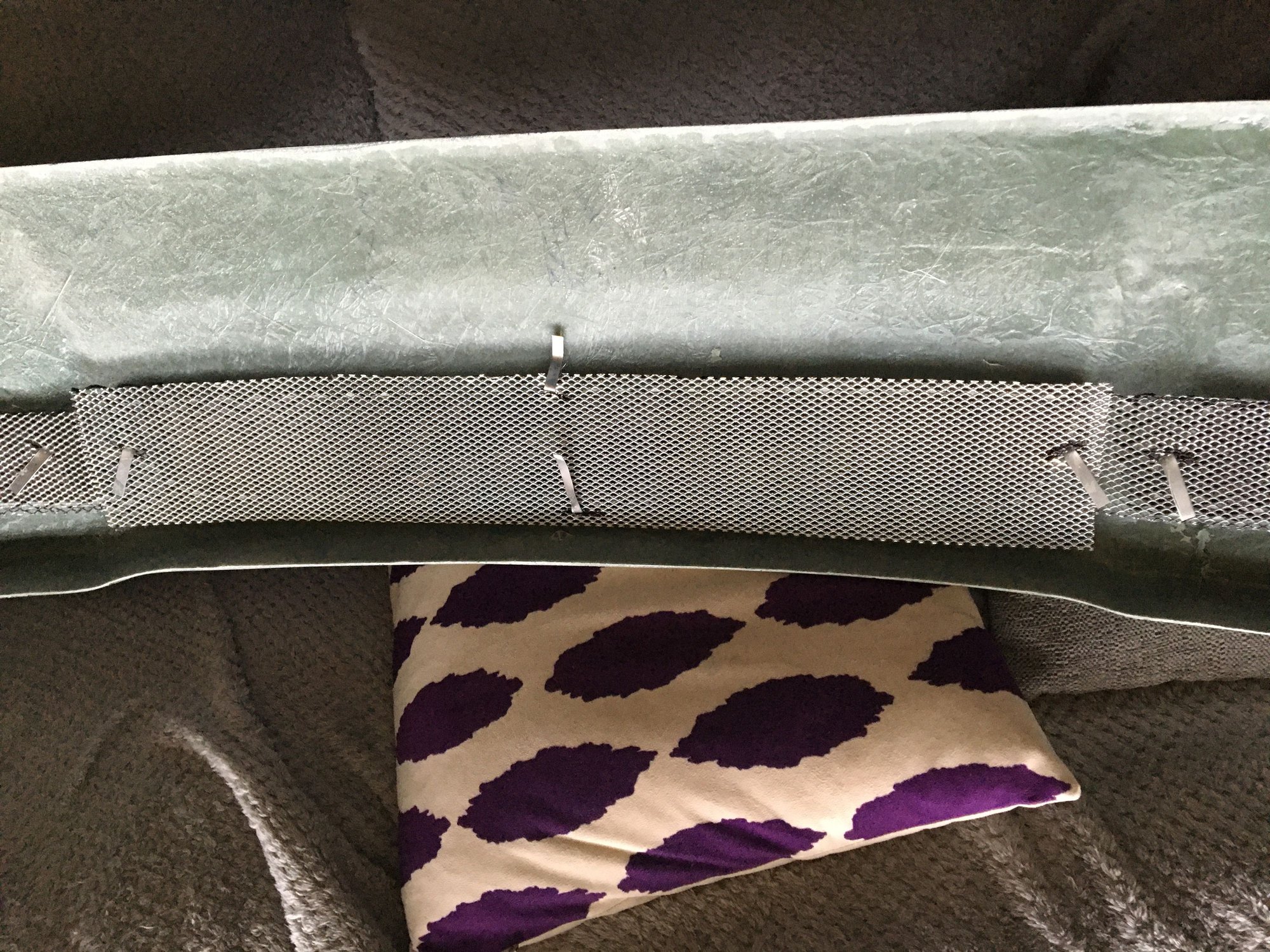

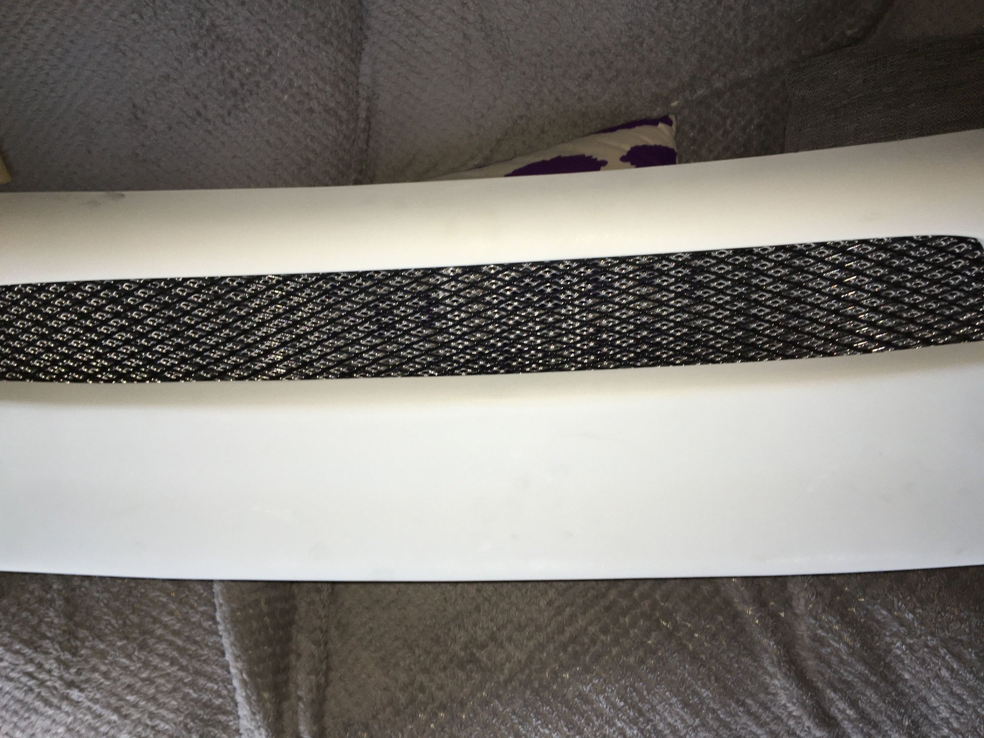

Have received the rear bumper apron today. Came all the way from Turkey. The cost of the bumper was a fraction of the delivery fee, in TRY, or Turkish Lira. It was a pain in the arse to pay for it, the fee's were, in a word, silly!

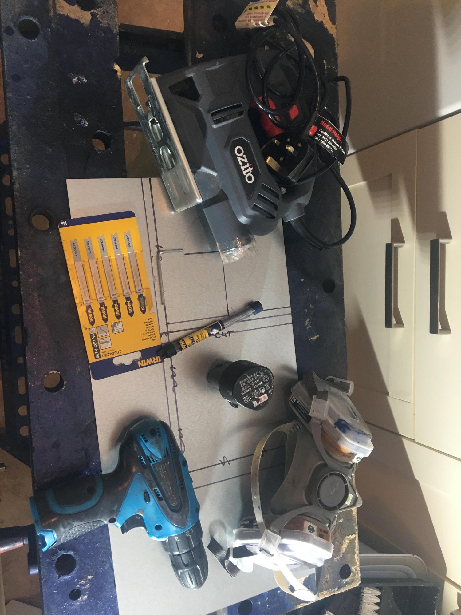

At the end of the transaction I am left with this skirt that will need some work done to it to make it fit. It does not sit flush with the rear bumper at all. I will show a pic of how the manufacturers show it to be fitted, as well as the pics of the object. Will be a fun object to add to the project, have base coat ready, in need of a good 1k matt basecoat in 5Ltrs for spray gunning.
Need to figure out a way to modify the fibreglass mouldings, and get them even, and flat.
Manual File VS sandpaper and block VS electric sander?
HMmmm!

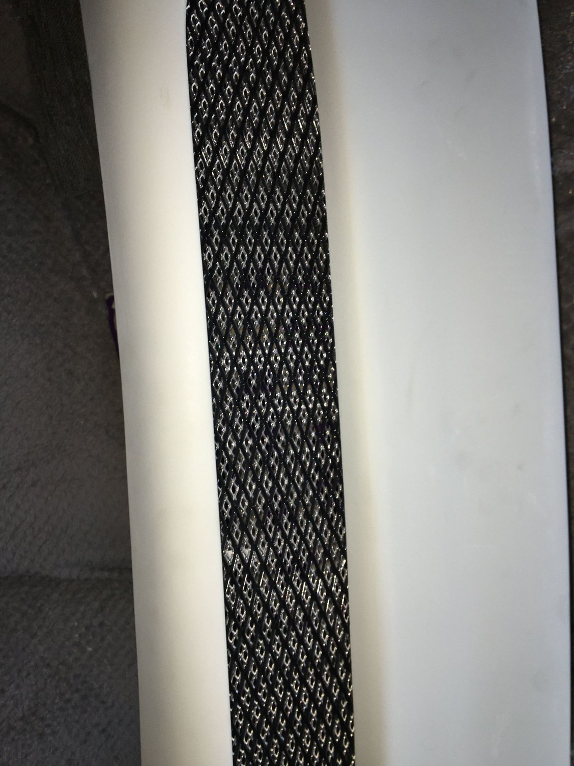

large triangle hole black grille with small triangle hole grille on the backside
Needs modding
Grilled cheese
Grille clasps
Fitted by factory or photoshop hiding tape?
