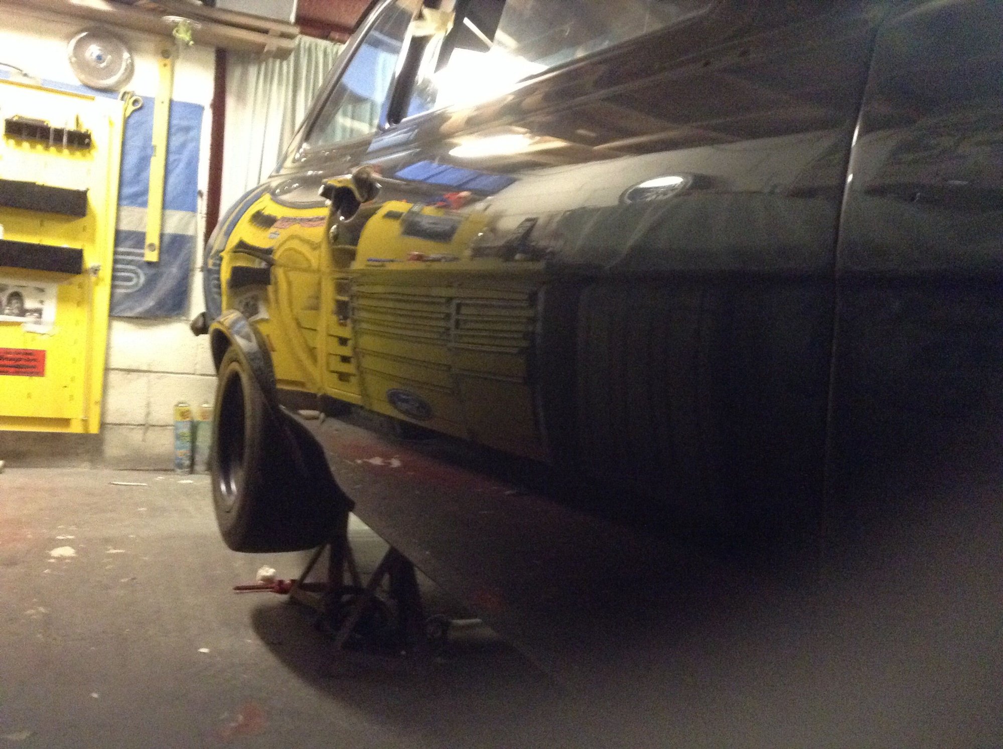

So after looking at the rear end it was decided we needed to change the profile of the rear tyres so we could drop the car slightly and it would sit in the rear arches better, so we dropped them to 35 profile toyo proxys
Slight stretch
And com paired to old tyres big difference

Got the strengthening plate on tonight and the new diff cover and some brackets for the brake pipes
Just waiting for the stainless brake pipes that are being made to go across the axle
